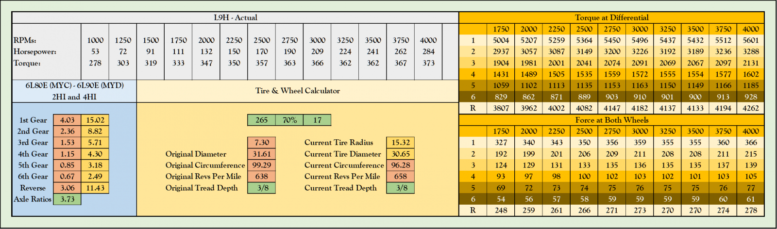

Chris, here is a Torque at Differential and Force in Newtons calculator I've been playing with to see how much power makes it to the wheels. The first two will be my truck with 3.42 and 3.73 gears and the third is my daughter's NHT Sierra. The Horsepower and Torque engine data came from those Tech-2 runs we did recently and then graphed them out. Both trucks were on gasoline a the time and mine is a little down on power because of those leaky intake gaskets.
Anyhow, here it is, and what do you all think? Is it a big difference towing wise to change to 3.73s and make it worth the extra 158 rpms?
When I was playing with this, the little 5.3 would need 4.30 gears to equal the towing prowess of the L96 6.0 motor used in the 2500s. The L96 would need 4.10s to even get close to the 6.2s towing abilities.
With your Yukon, if I'm understanding correctly and looking at 4000 RPM (where the peaks are), I'm coming up with a 20 ft. lbs. gain at the wheels. This doesn't seem massive considering the expense of swapping gears. But, it's gains all across the board and helpful to the trans. I'd have to say it's a win.
