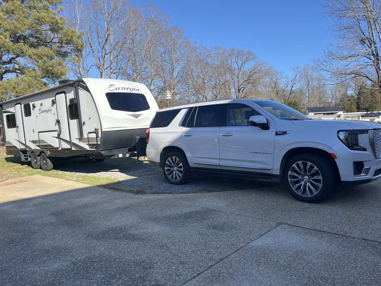

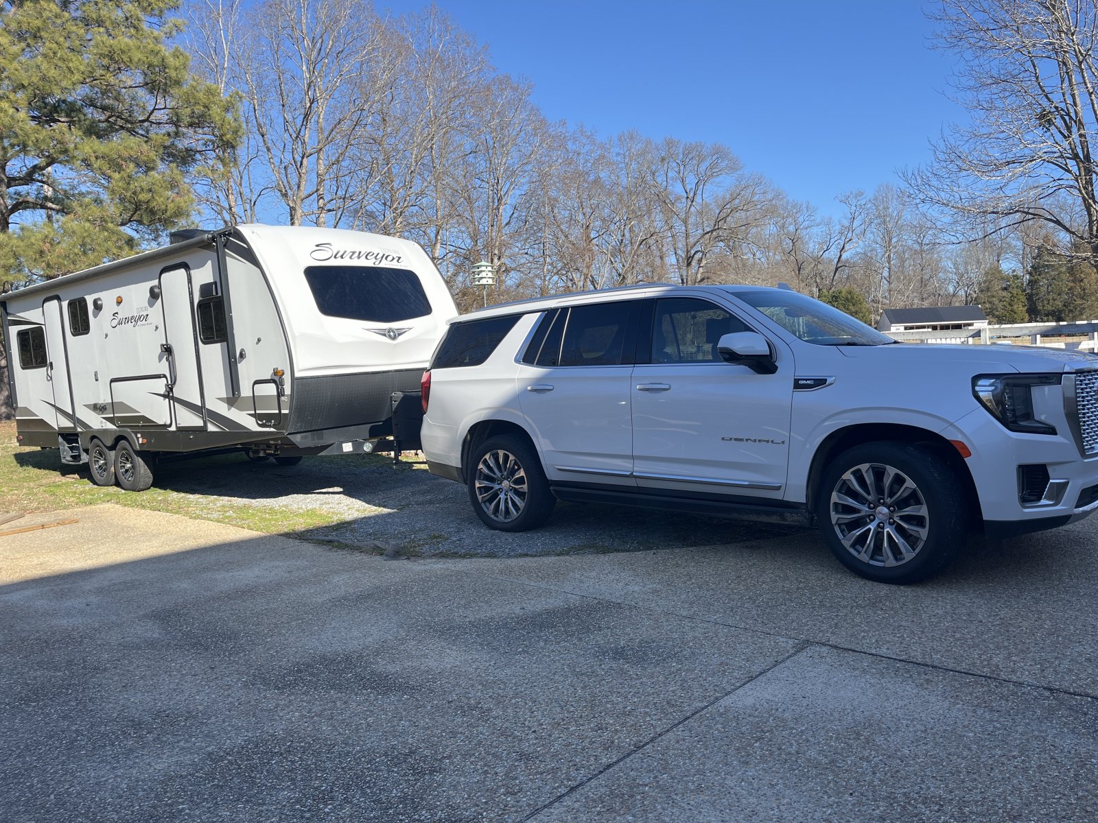

So this is the 2021 Yukon with trailer. I am taking it to a trailer place today for the to add “sway” bar. He was saying the distribution bars don’t work because of the independent suspension will continue move up and down trying to level.

Let us know how it goes. Nice camper! It could just be the angle of the picture but it looks like the camper is nose high. If the front is higher then the rear on level ground that will also cause excess sway. You want the front of the camper slightly lower then the rear.
