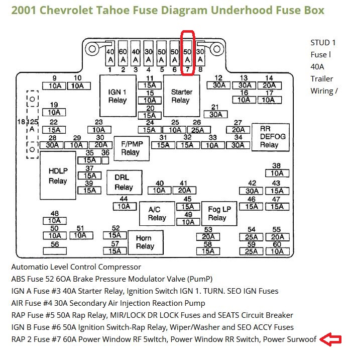

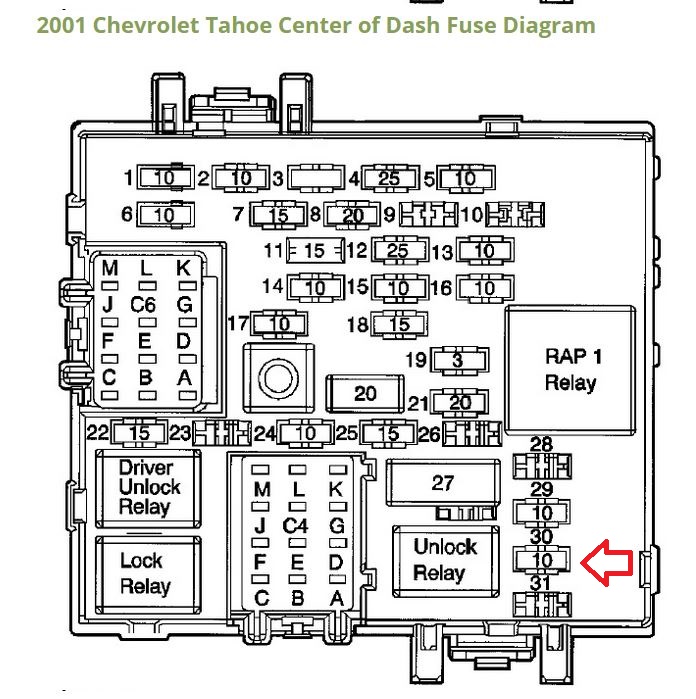

Have you checked the fuse shown below, and measured voltage on both sides of the fuse using the integrated test points on the fuse?
And this one in the underhood fusebox (not sure if it's a 50a or 60a; maybe there's a diagram in your truck):
