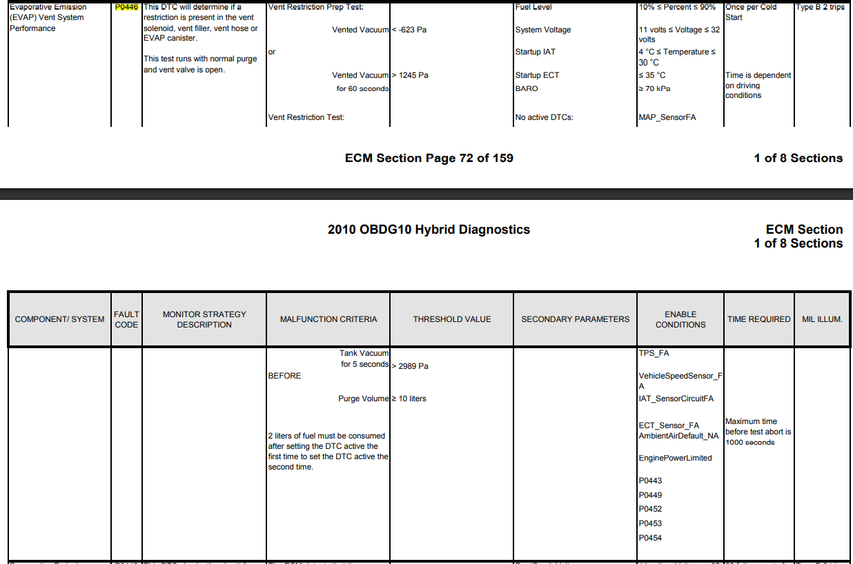

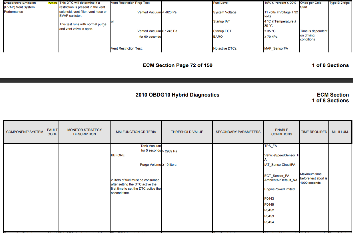

Now on to the CEL
P0446 is a restriction in vent "solenoid" this is a electronic code not a cat code(if it was the cat you would have a P0420/P0430 code)
so you have an issue with one of the following:
Baro(MAP sensor)
MAF sensor
IAT sensor
ECT sensor
Ambient air?
TPS_FA (Throttle Position Sensor)
Vehicle speed sensor
engine power limited

also here is the TSB on the code
http://downloads.innova.com/tsb-files/80000/2380966.pdf

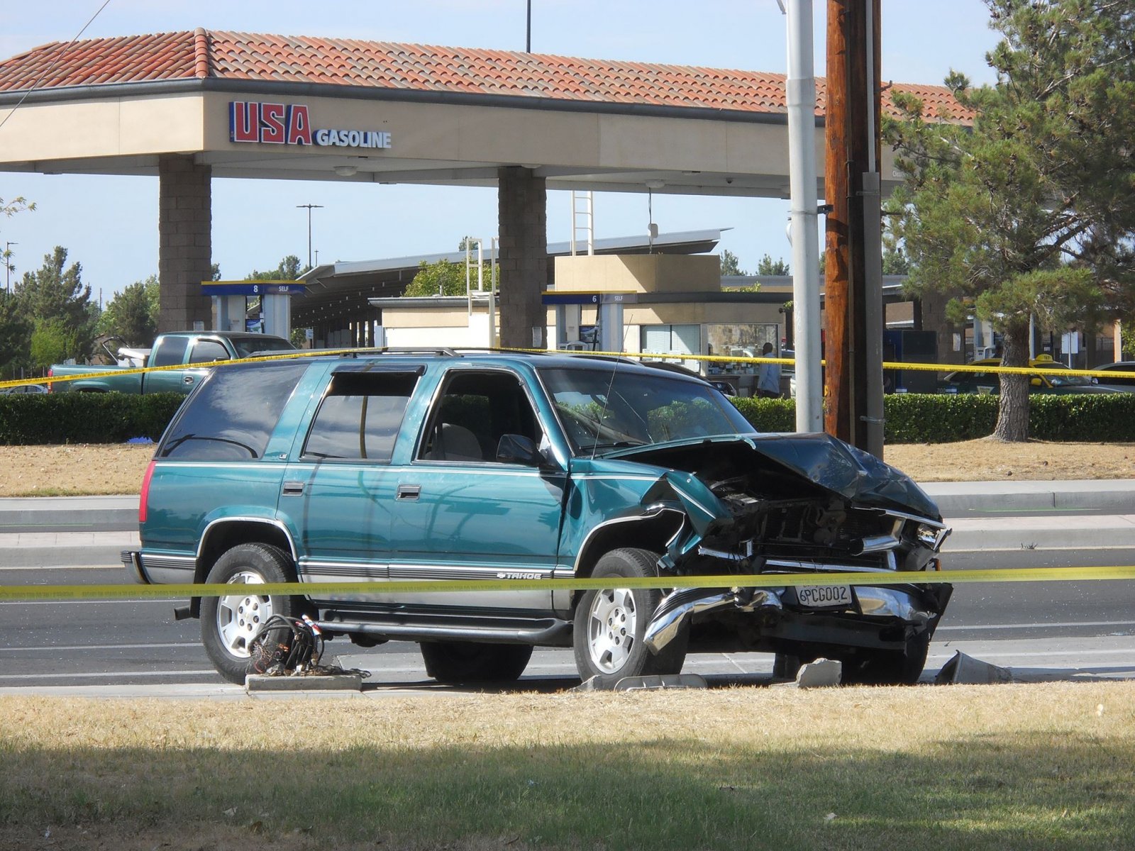

I say let them die in a crash... that is why I got a SUV instead of another Car
(more room to crush) ;)

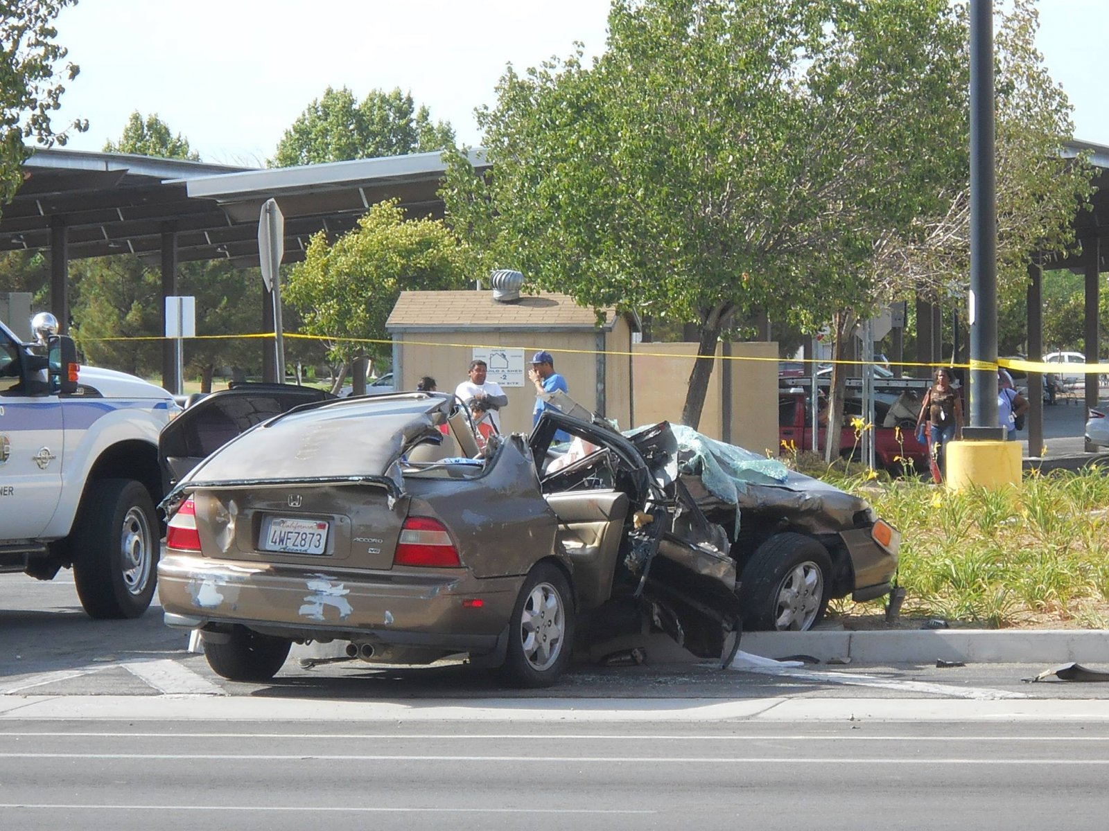

1990s honda accord vs 1990s tahoe your honda gets crushed into a cube
do you think the people in the tahoe walked away or the people in the accord
the accord was hit at 55MPH and got thrown 100 feet or so (they were making a utrun)
Answer: people in the accord left in a body bag..
Baro(MAP sensor)
MAF sensor
IAT sensor
ECT sensor
Ambient air?

P0446 usually means that there is a blockage in your lines causing too much vacuum to be developed. Probably charcoal in the line between the canister and the engine.
