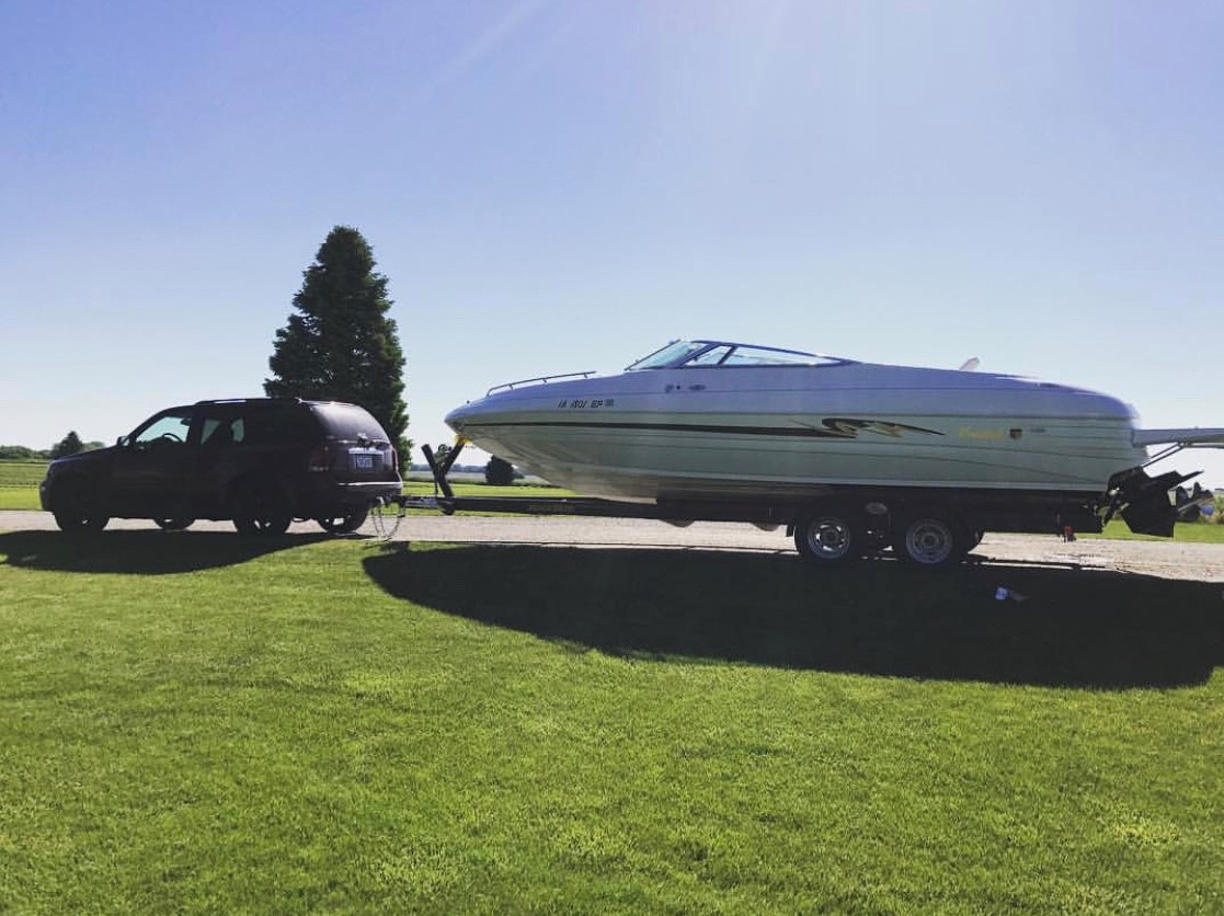

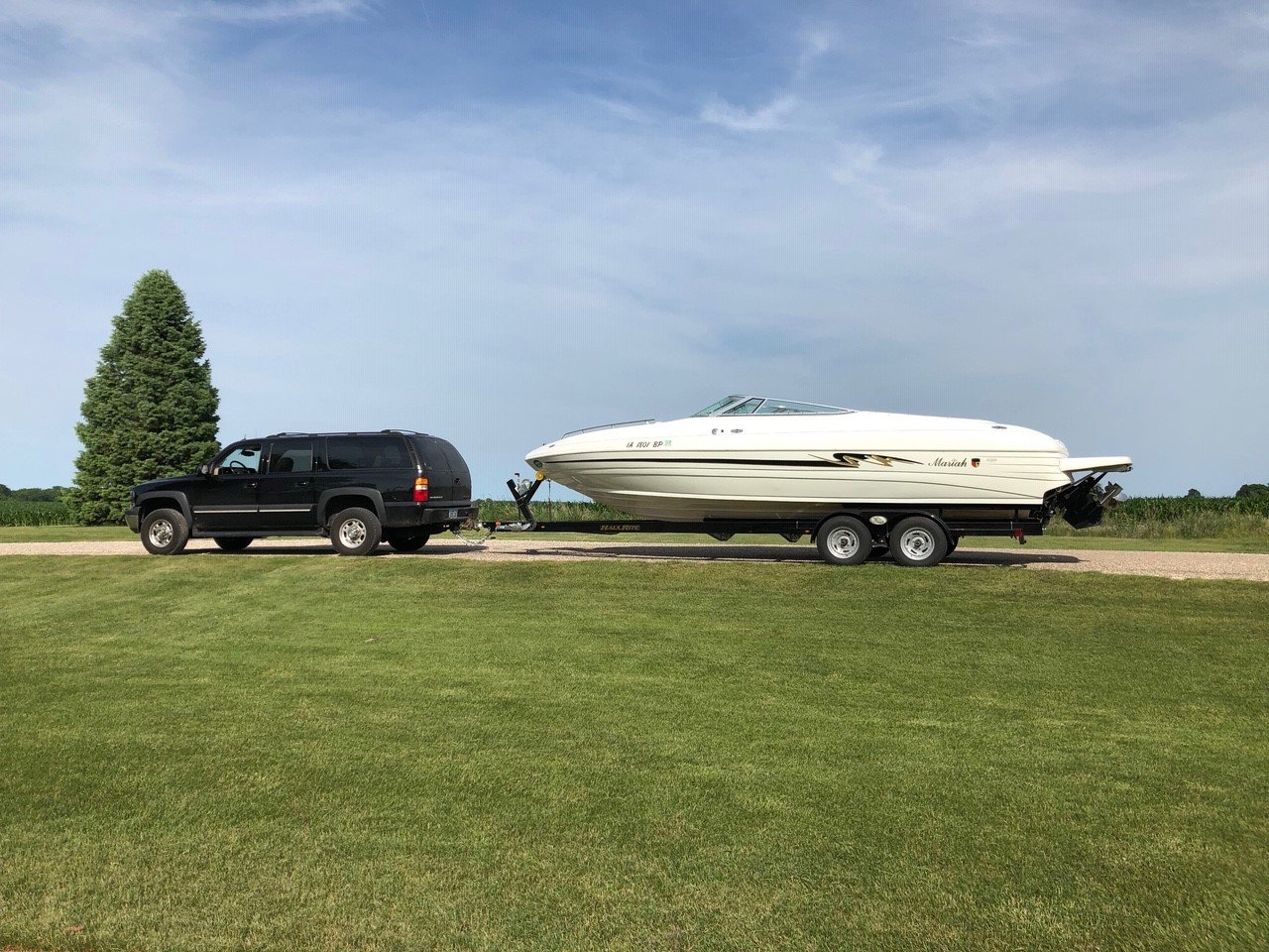

Anyway, I am looking for a full size SUV that I can still tow my boat and car trailer with. The boat is a 1999 Mariah Z252 that has a dry weight for 4250 lbs that sits on a tandem axle trailer. I am guessing the total weight is around 6200 lbs. after accounting for fluids, gear, and trailer. I've had the boat hooked up to all the vehicles, but didn't tow it any distance with the Rainier for obvious reasons. The Avalanche struggled with the 5.3/4L60E combo but did it. The Silverado also struggled with the 6.0/4L80E combo but if I left it in 3rd it would hum right along. I bought the 8.1 Suburban strictly for towing duties and while it does a fantastic job, it's more than I need I think. Neither the Avalanche or Silverado would hold OD while towing the boat, but did fine with my Camaro on an open trailer. The Suburban would hold OD and pick up speed whenever I wanted. It also got the best MPG towing the boat out of all the others but unloaded it only improved 1-2 MPG.
With that being said, I have also towed the boat 6 hours one way with a 2013 Tahoe LTZ. It towed better than all of the other vehicles except the Suburban. One thing that concerns me with the SSV Tahoe is that it won't have the air suspension to level the truck back out. This brings me to my first question of adding airbags to the SSV springs, or will it not sag enough to worry about it? The car trailer adds the most tongue weight. Also, is the K5L HD cooling package really needed? I always add an aftermarket trans cooler to my tow vehicles anyway, and an oil cooler really isn't needed IMO.

Lastly, some pics of the boat behind the Rainier and Suburban.

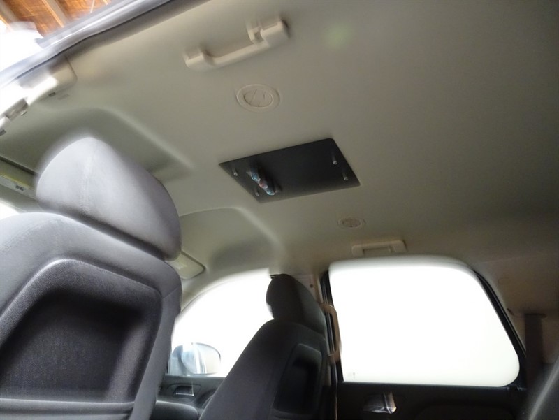

BTW the truck looks good, clean. Seems like it was a Feds truck. Now this I've never seen before:
Mine has the hvac controls there as well. It used to have a cage so they moved them forward with that plate.
That one also looks like it’s been lifted (or at least leveled). Mine had strut spacers up front and lift springs out back.
