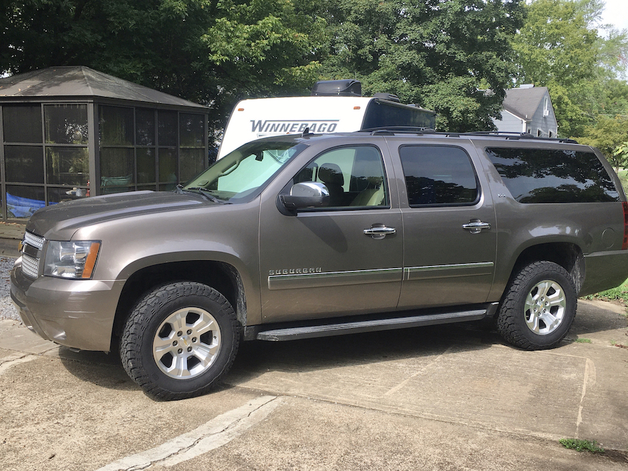

I went with the 1250 lb Moog rear springs (pretty sure they are the Z71 spec coils noted above) and Bilstein 5100s all around. Rear was lifted 1.5 - 2", so I set the front spring perch up one notch on the front shock body. Ride is wife-approved and much improved over the blown out air ride shocks. Extra ground clearance helps with some off-road tires. I'll get the stiffer front springs if I ever hang a winch or heavy bumper on the front of the truck but saw no real need for them at this point.
Highly recommended.
