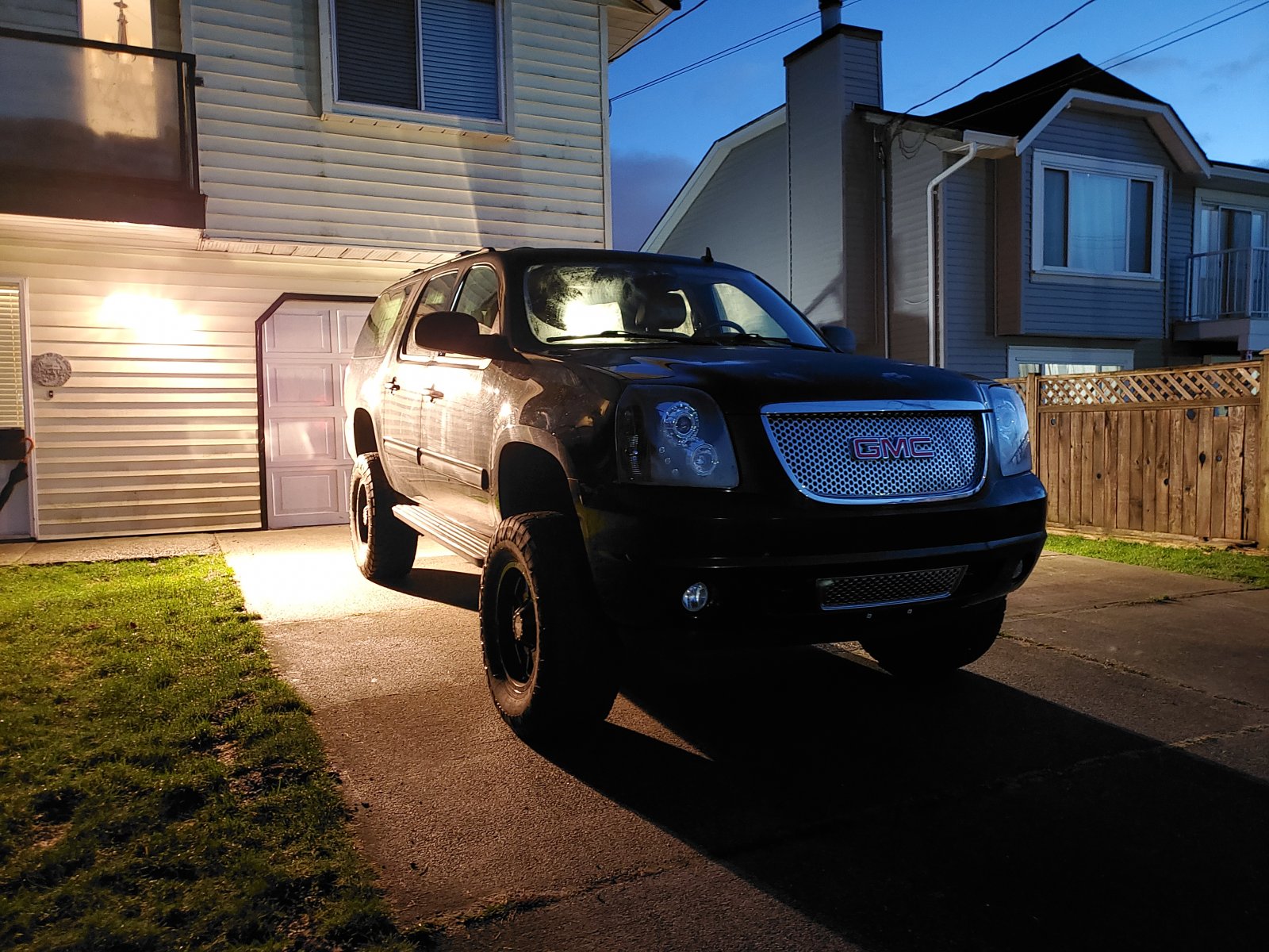

Still pretty dark out but at least it's not raining. This is the best pic I could get today!
Any ideas what's causing the condensation on the inside of the windows? Every time we went to look at it and drive it home, it was absolutely pouring out but there was never any condensation built up. Could it simply be from us being in the truck wet?
