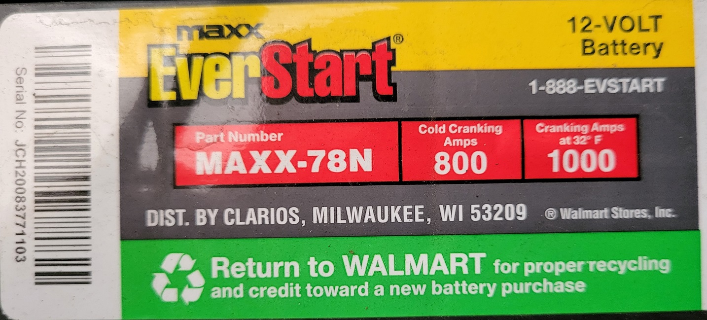

I look for batteries that have the higher amounts for these batteries... for my 2005 GMC Yukon Denali 6.0, I bought an Interstate from Costco...we have two battery choices I believe: Group 100 and Group 78
I bought the Group 78 battery for the higher numbers and curiously it was a little less money...
Group 100 - CA - 965 CCA - 800 RC - 100 minutes showing $109.99 today
Group 78 - CA - 1000 CCA - 800 RC - 110 minutes showing $99.99 today
I believe these batteries are Clarios made here in the ChicagoLand area...I would check these numbers against similar batteries from Walmart (Everstart Maxx) and other auto parts stores with various coupons etcetera...
be mindful that Costco recently changed their warranty and the AGM batteries at Walmart carry a 4 year replacement warranty which might be of interest to you...the cost difference wasn't worth it to me and the CA/CCA/RC numbers are usually a bit lower on AGMs...
the ones I posted are lead acid not AGM...good luck with your choice

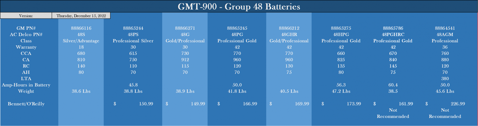

For all those reading this in the future, AGM batteries were not meant for the GMT800 (1999-2007) and GMT900 (2007-2014) platforms as their charging systems were not designed for the rapid charging that an AGM battery demands. You can run them, they are just not going to last as long as they could have in a vehicle designed for them.
As of this writing, these are the batteries that GM/ACDelco recommends for the GMT900 family of SUVs and trucks:
I've had two 48PS batteries over the years, one went 48 months in a truck used primarily in Florida during that time and 68 months from a truck that spent almost all of its life in Oklahoma. I know of some Canadians with 11+ year old trucks with their original batteries still. Until RVC/EPM was introduced into our charging systems, automotive and marine batteries never lasted more than about two years down here in Florida.
