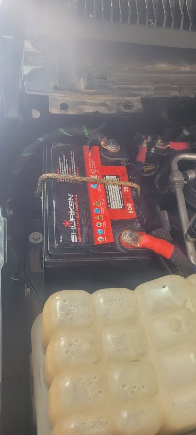

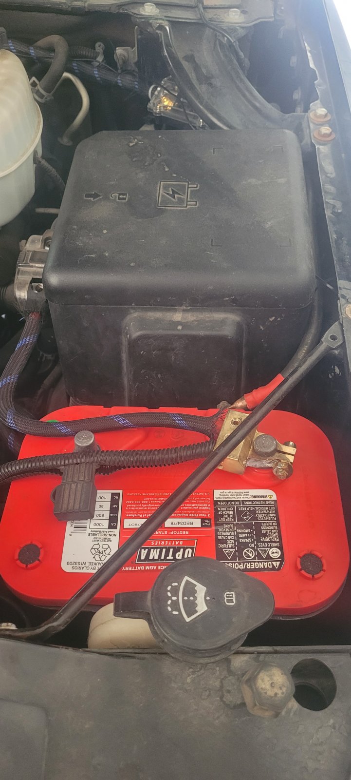

I installed a 38 AH agm (a shuriken sk-bt38) to compliment my starting battery (a diehard gold). The diehard died, about 3 yrs old. I replaced it with an optima red top group 34/78 battery. My question is: is this battery an agm or a regular lead acid? It says 'high performance agm' on the sticker and it also says it's a non-spillable lead acid. Just want to know so I can charge it correctly.
It is agm but still not advisable to mix battery's. they should be the same age and model
rsharger
Sep 8, 2024
By definition, an AGM, or "Abosorbed Glass Mat" battery is indeed a lead acid battery, but due it's construction, it can be positioned in any orientation. The internal "mat" contains the acid/water solution in such a manner, that it cannot be spilled if turned sideways. It is not the same as a "gel cell" battery however. Hope this helps answer your question.
Some light reading on the AGM batteries:
Oh that makes sense. I felt like it was too good to be true that the red top 34/78 agm was cheaper than the (spillable) lead acid 34/78 at orielly.
