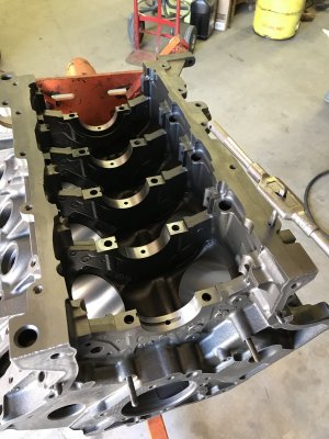

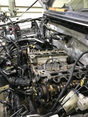

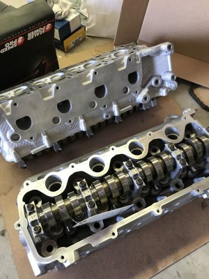

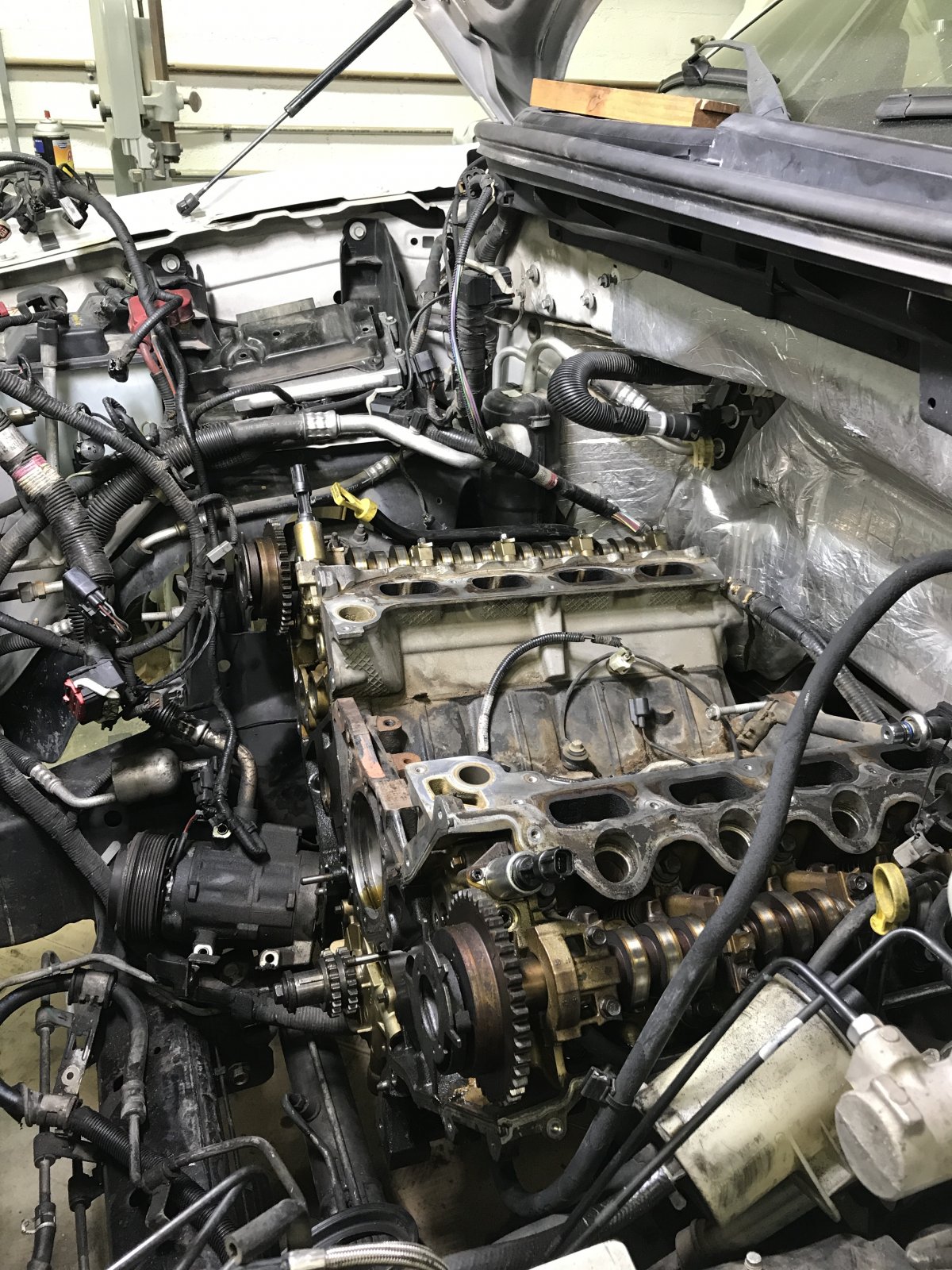

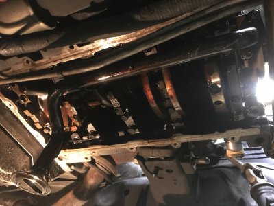

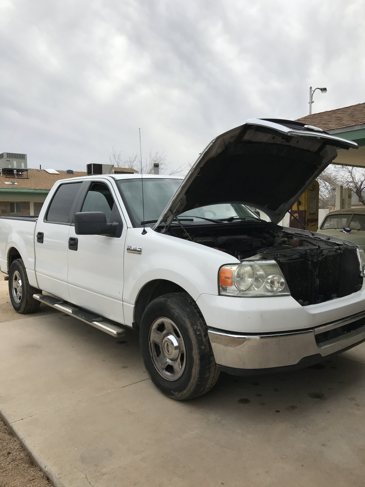

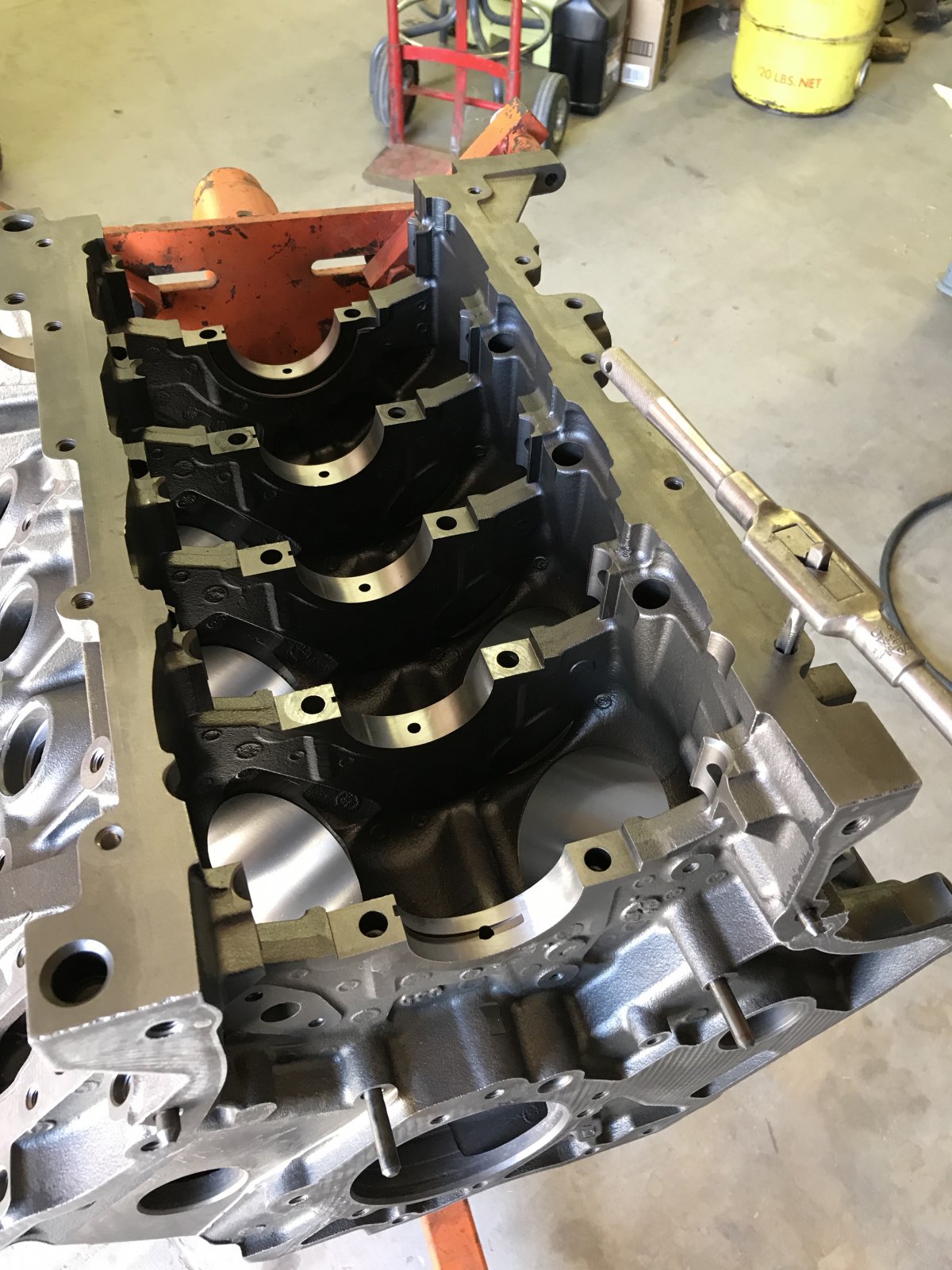

Here are a few of pics from my F150 rebuild if anyone is curious. With the oil pan off I found the culprit...a spun/failed thrust bearing. By the time I took it out I just decided that since I spent $800 on the truck I'd blow the motor apart, get it machined, and put it back together. Basically new engine in a 6 passenger truck for about $3000.
Mostly a fun project. Particularly when your father-in-law has a shop.
Newly cleaned heads and a block...they all look so cool.
Glad to know this level of effort far exceeds that of a small block GM.
While my father in law is a Ford guy, he has snuck in two GMCs since I've been married. He had a 67 3/4 ton with a 283 V8 and a 00s Sierra with a 4.8 V8. He'd still claim me I think.
57144201482__3AAE05D6-B44A-4306-B18C-24592733747E.JPG RizhJfAhSTWl+XmqFhJwig.jpg m6arFs+aQpaTBAt2Oo8R0Q.jpg FvVkkbdpThKDJOzClXbDHA.jpg 57748303774__A54727B6-6D79-4AC8-AA12-DD02613A492C.JPG
45,012
An LS is so simple that it's fun. About the only particular points with it are the oil pan and front and rear cover alignments.
