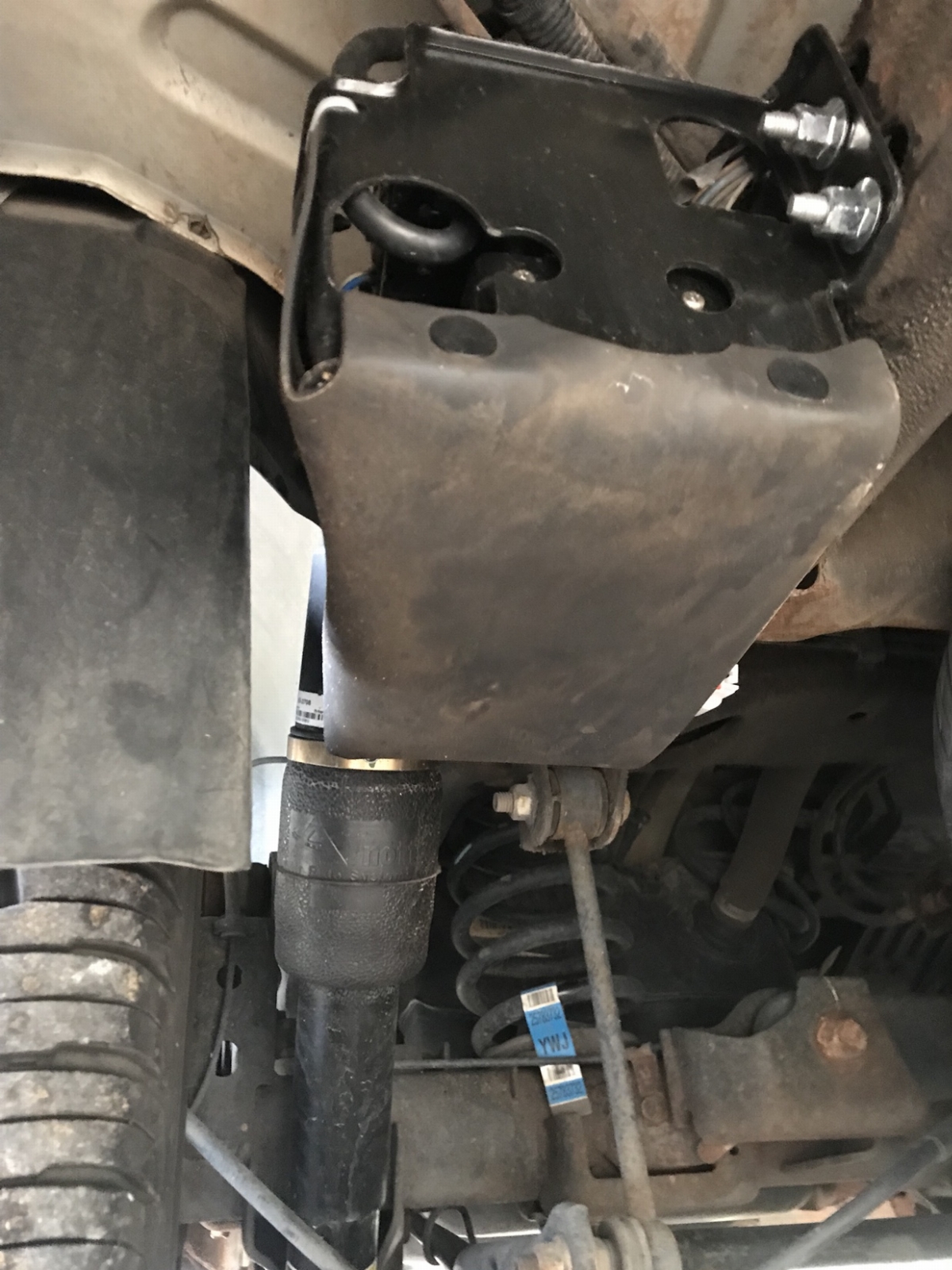

As far as electronic ride control... just listen for the air compressor to turn on for a few seconds after start up. It should turn on for a few seconds then shut off. If you hear it running more frequently then there is a leak in the system somewhere, most likely the shocks. Not a deal breaker either way.

Where is the compressor located so I can focus on that area? Does it come on only at startup or will it turn on when ignition is turned to ACC?

Behind the driver rear wheel.

when you turn the key to start (not actually starting the truck) wait 4--5 seconds then you should hear the pump kick on for about 4 seconds it is right by the gas tank filler, you will be able to hear it from the front seat with the door open it's not real quiet.
