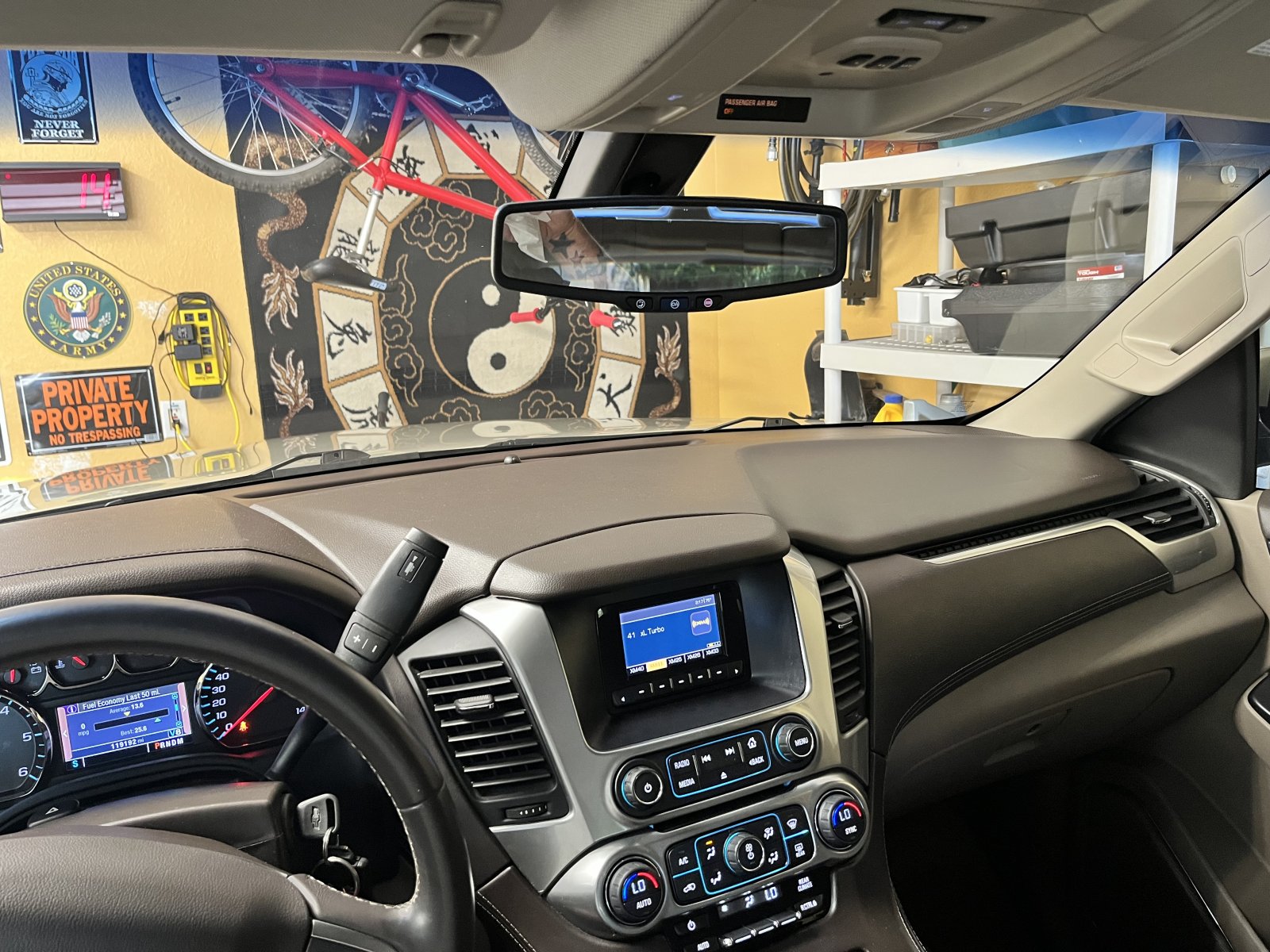

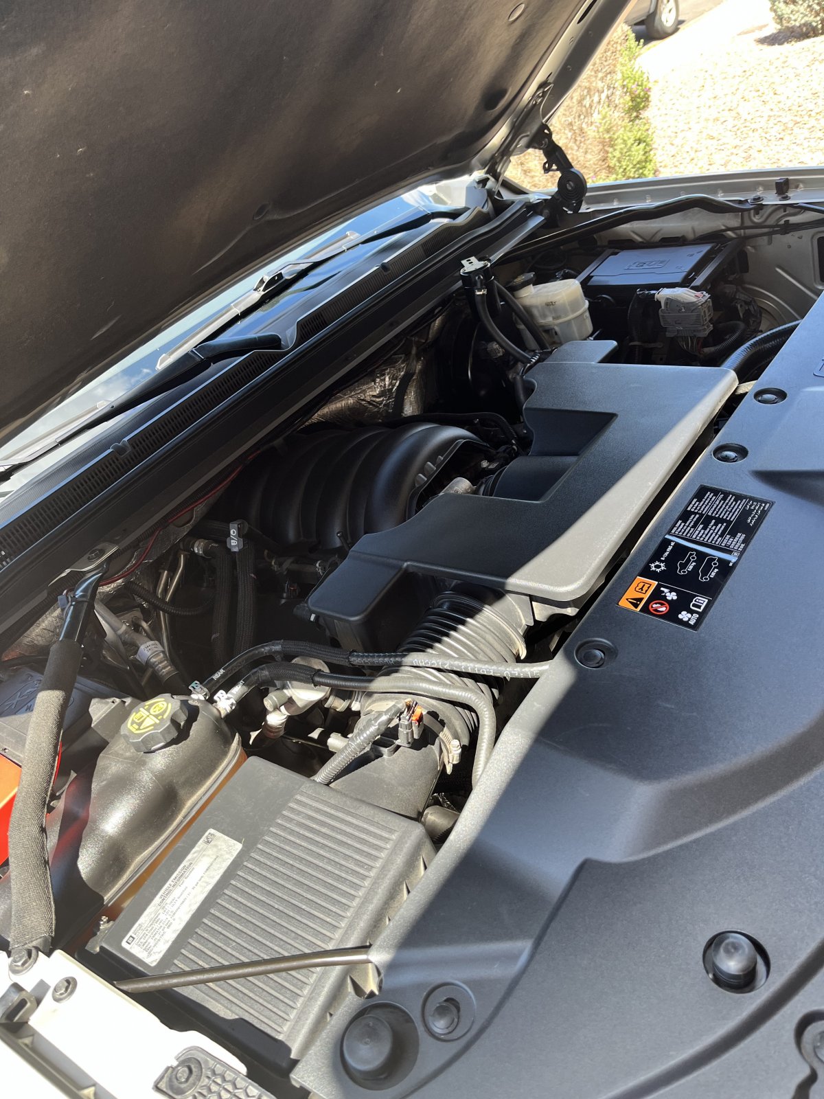

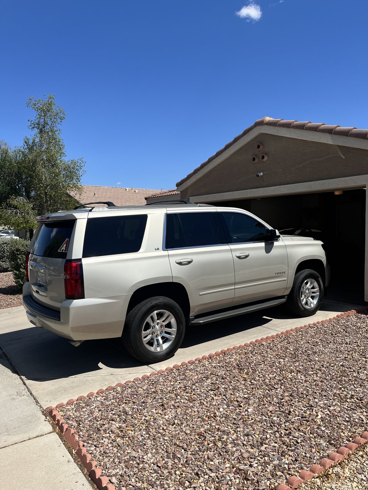

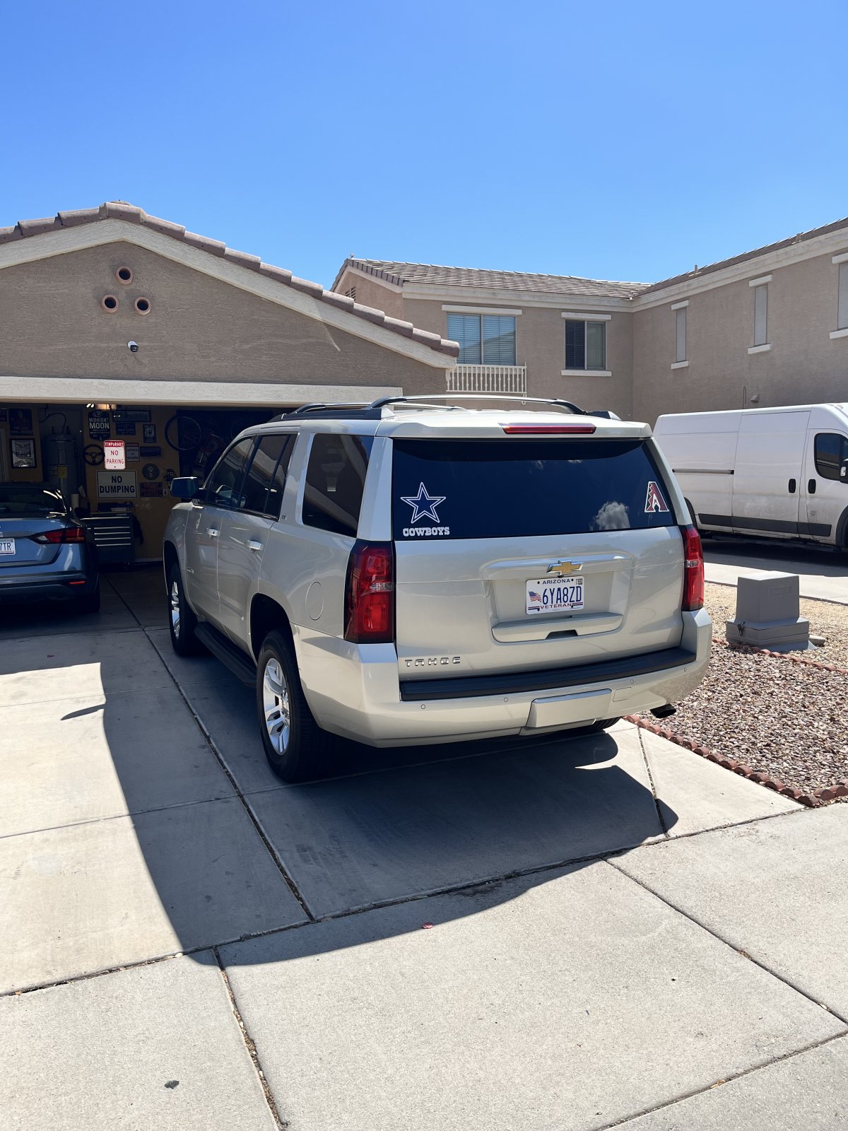

Welcome from Queens NY.
Your Tahoe looks to be in excellent condition. Out of curiosity what year is your Tahoe and how many miles on it?
Thank You
2015 with just over 111K. Bought it 4 years ago at 90K. Mostly used for visiting my son in Portland and vacations. Love this thing! I have a plug in AFM delete but runs fine without it. Mid grade fuel and catch can installed.
