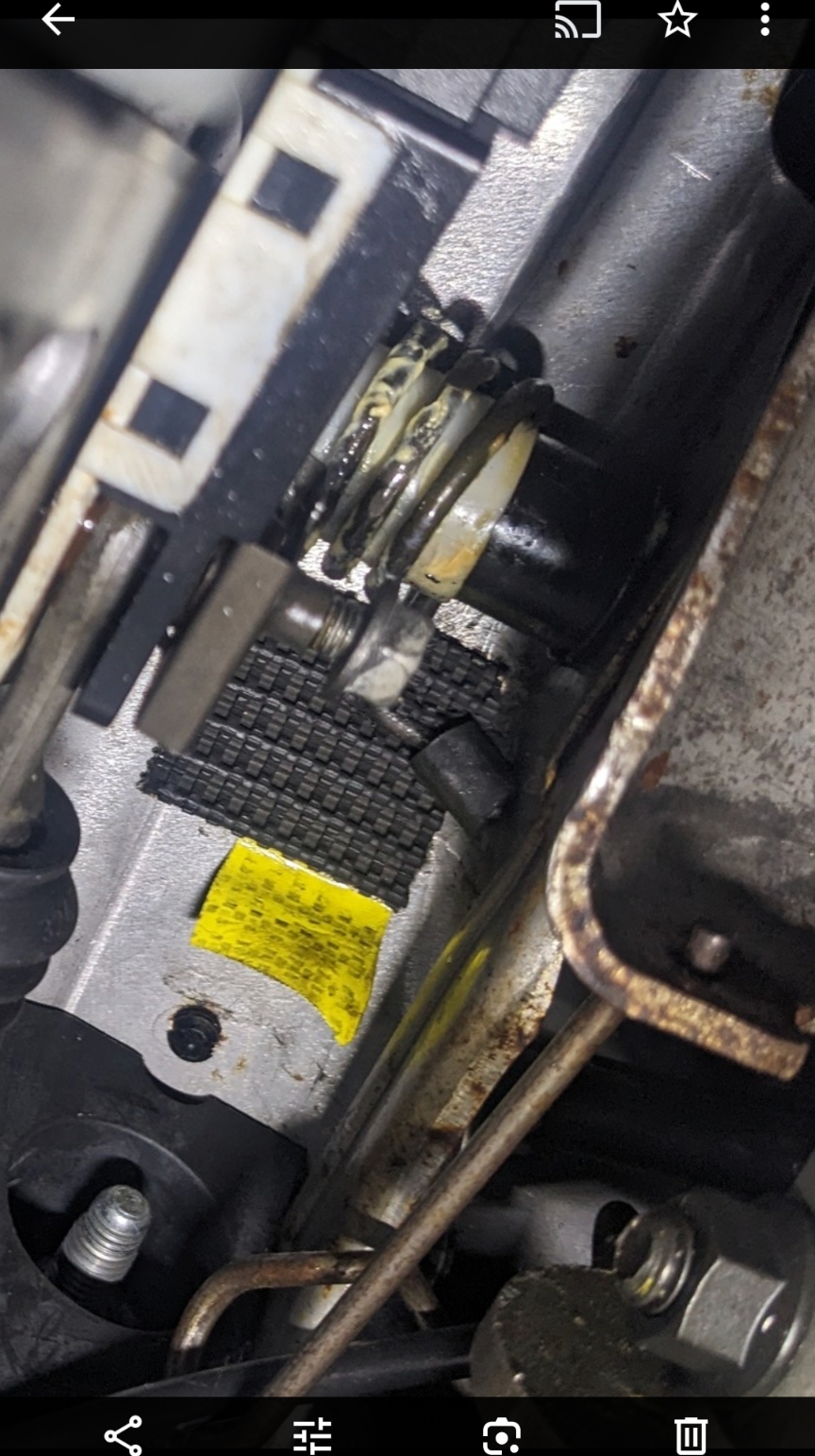

mine did it when I got it.. drove me nuts. like ready to pull the whole pedal box. I was able to spray enough lube up there they it would stop for a few days and come back. adjusting the pedal height would make it go away too. but I'm to tall to drive around like that.
after months of randomly messing with it, I figured out it was the spring. the tang that goes again the metal plate of the box, the tip of it digs into the metal and squeaks. I moved it twice by prying it over to a fresh spot but it would work it's way back. after a few trys I was able to bend up a piece of metal so I could pry the spring tang up, and stick a cut up piece of conveyor belt and jam under there.
hasn't made a noise in over a year. I don't really drive around with the radio even on anymore. I work around so much loud noise I am sick of it. so just turning up the radio wasn't an option haha.

but for anyone that does find this thread. if you have a squeaky brake pedal, that seems to come and go randomly, if you have adjusted pedals, and they are always fully down and then move them up about half way and it seems to go away. the fix for me was this sping tang. it's hard to see and even harder to get to. but it drove me completely nuts diving it. like rather take the other car than even drive the thing lol.
you'll see in the pic if you can zoom in, I put a scrap piece of rubber conveyor belt under it where it was digging into the steel for years. but any thick rubber under it would work. i tried a small rubber vacuum cap over the tip first but it ate right thru that and then I couldn't get it off, so it's still in the pic haha
