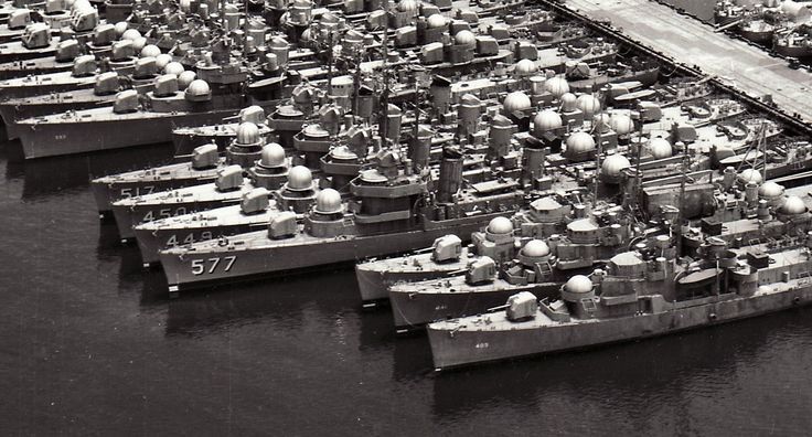

Heading overseas for 4 years. What is the recommended way to store a vehicle like ours for that long?
Pit up on blocks, empty the tank, pickle the engine, pull the battery out, cover it or place it under cover, use dessicants or a dehumidifier if electric nearby, don't forget to power the bilge pumps...
