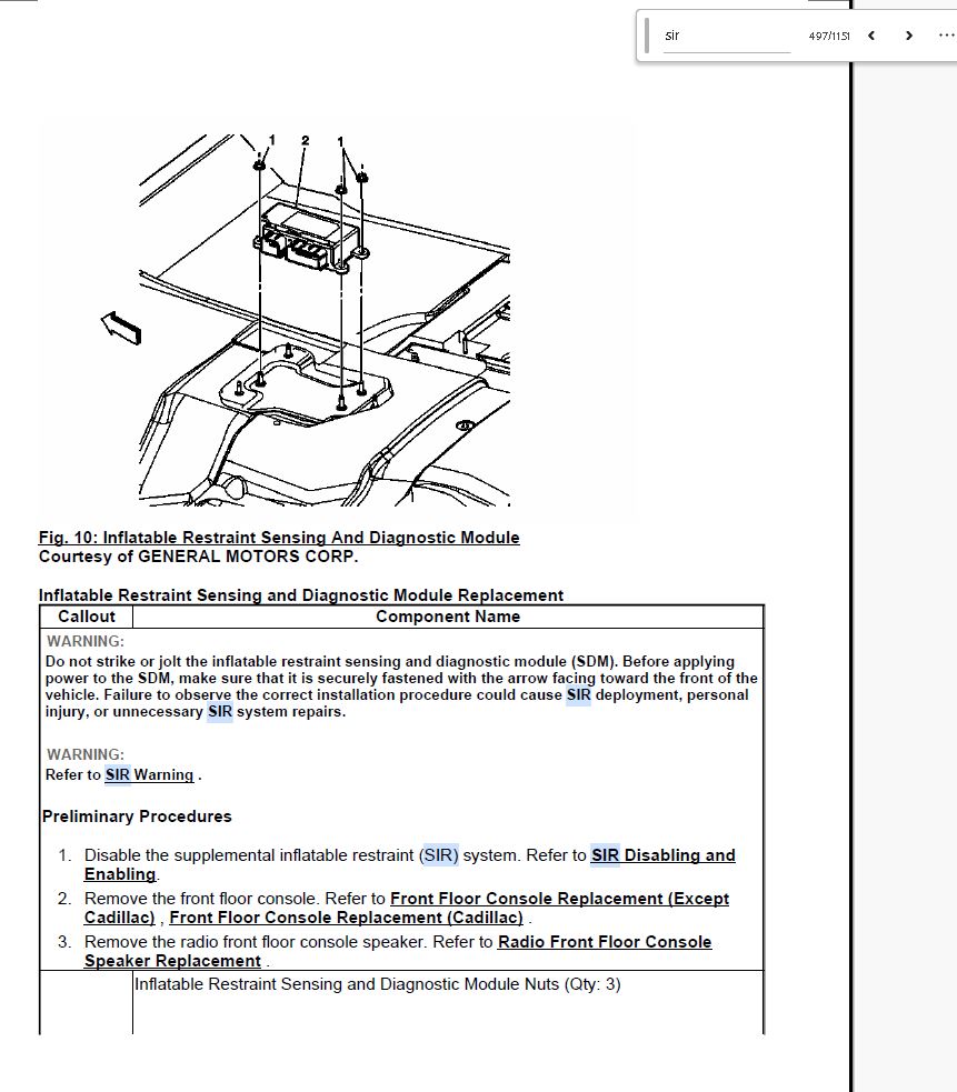

The BCM is up under the dash drivers side the SDM is located exactly where the video shows and the same place the service manual shows
