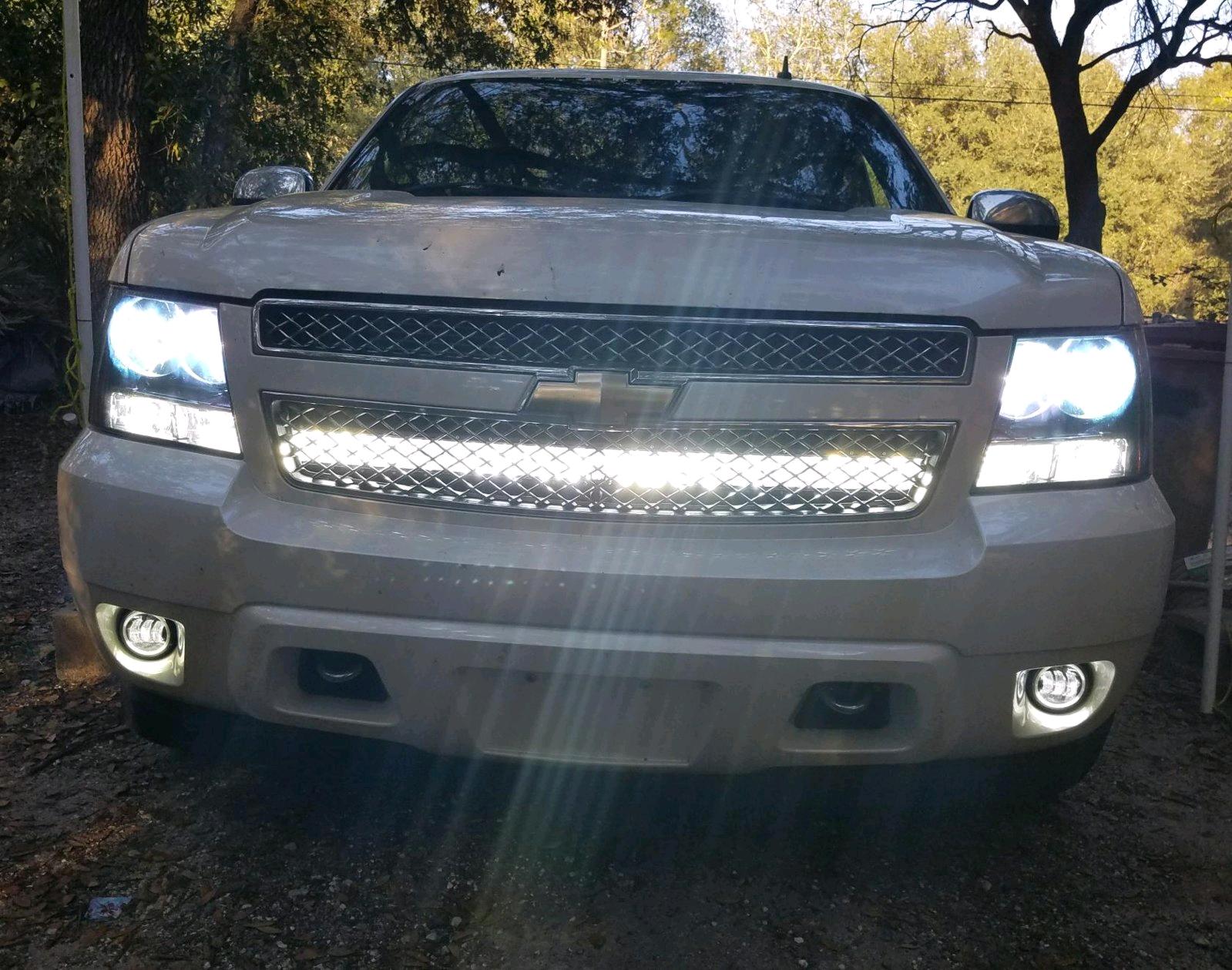

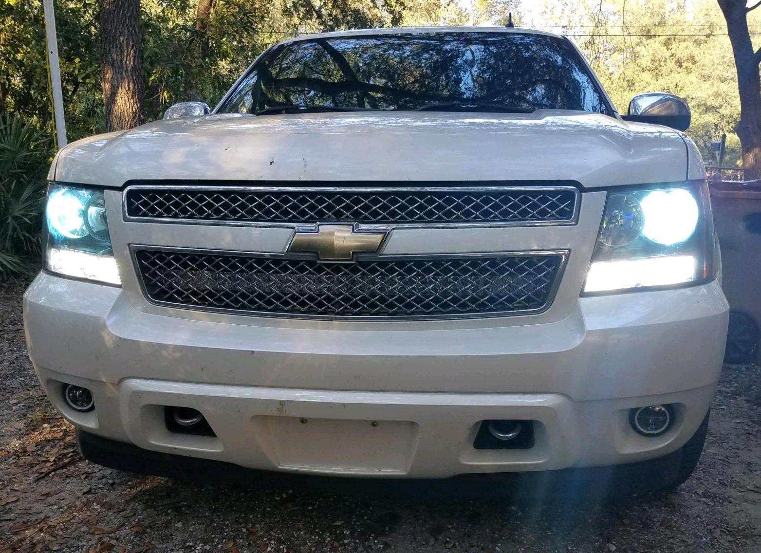

Here is mine on my Burb.
42" curved 800 watt.
Mine barely fits between the headlight housings but I wanted the full width look.
Hope this helps.

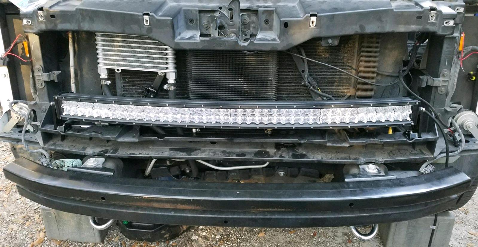

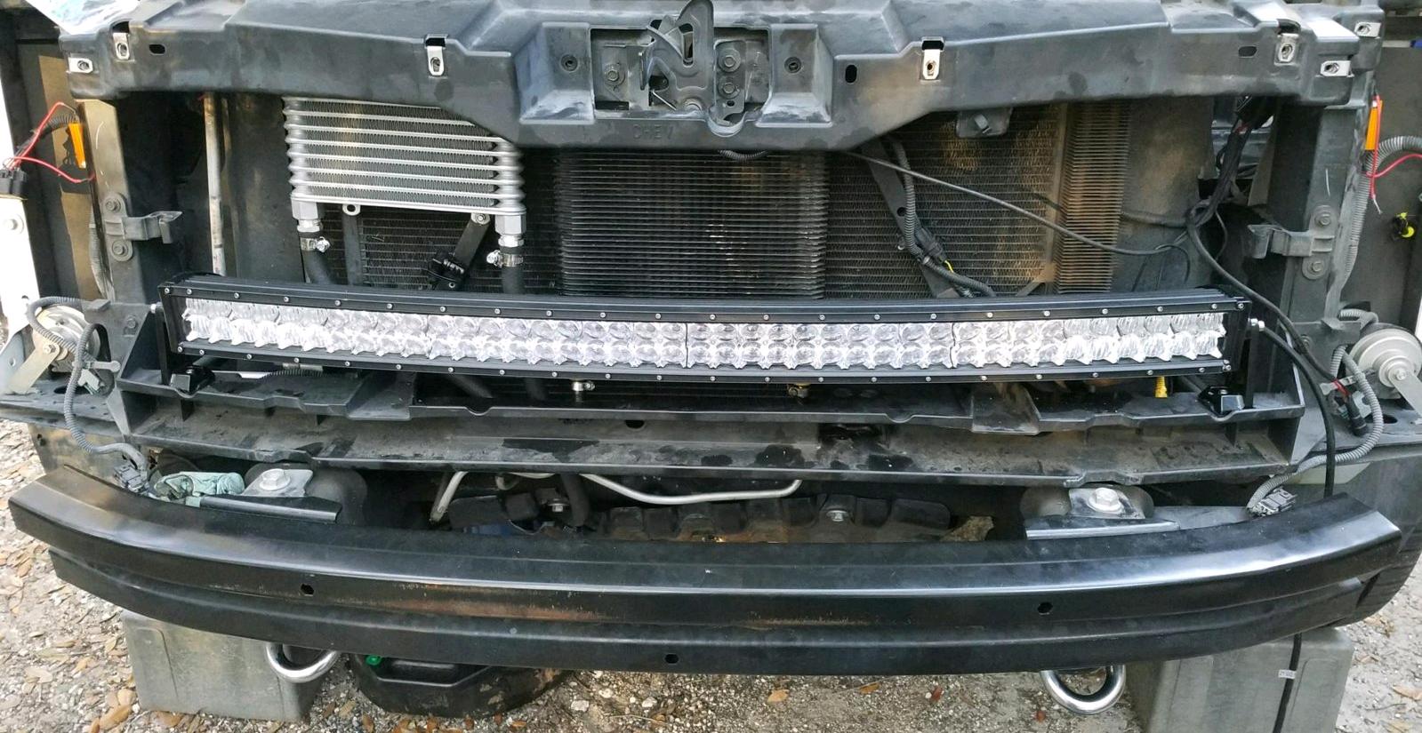

Ok so you just mounted it to that support piece behind the bumper. That seems reasonable. I got a shorter 20" bar so I'm hoping I can do that without removing everything.
The_Burban
Mar 19, 2018
287
193
This is all I did. Right atop the energy absorbing styrofoam. It has held in for thousands of miles . You could drill into the bumper.. or drill through a do a bolt/nut setup.
I didn't remove the front either. Just snuck in, peeling the grill back to gain access.

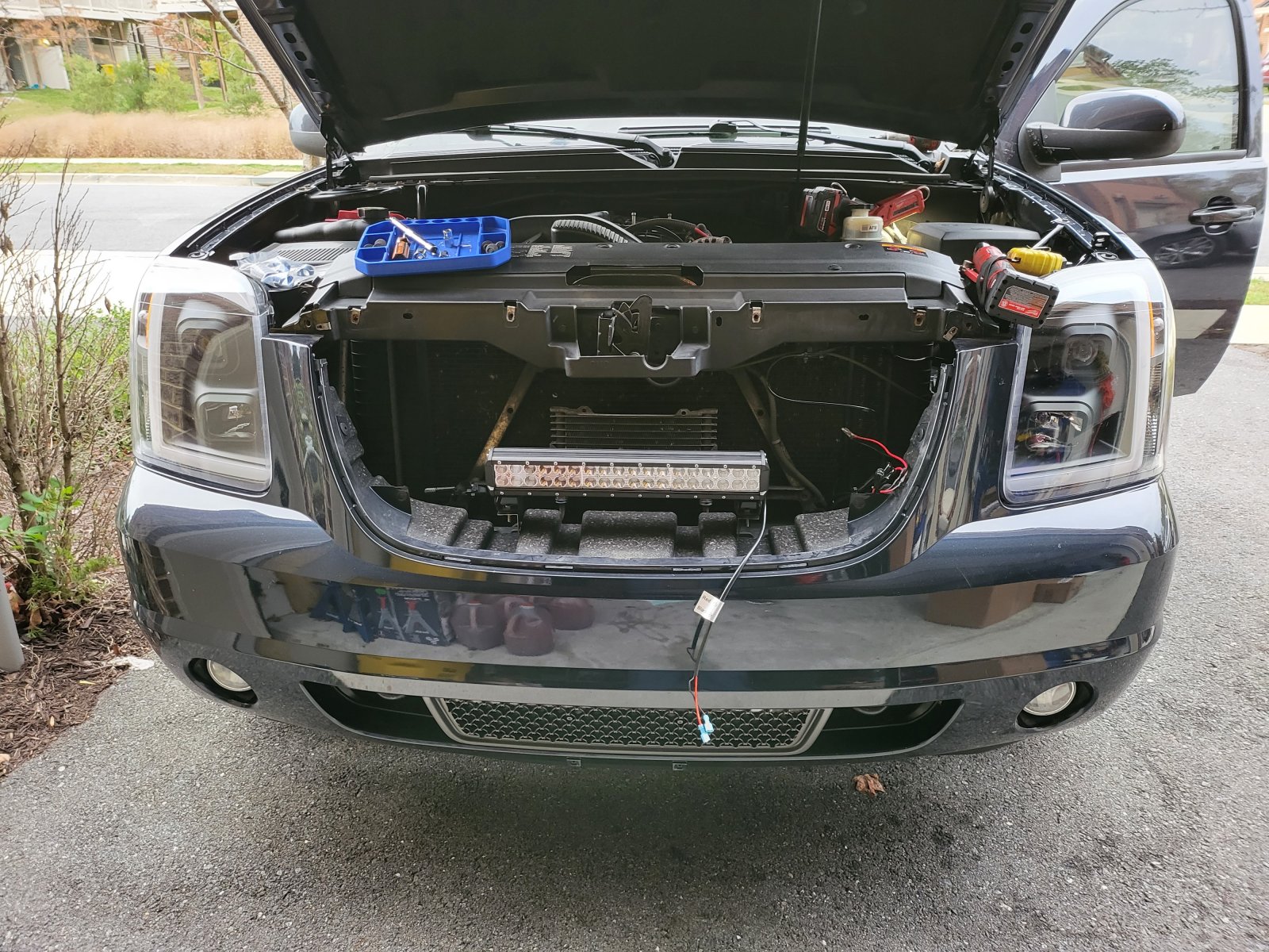

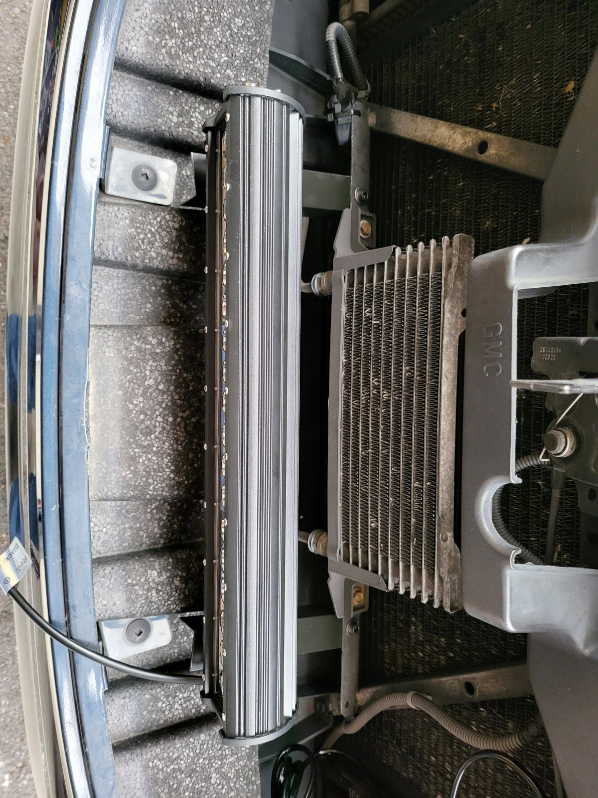

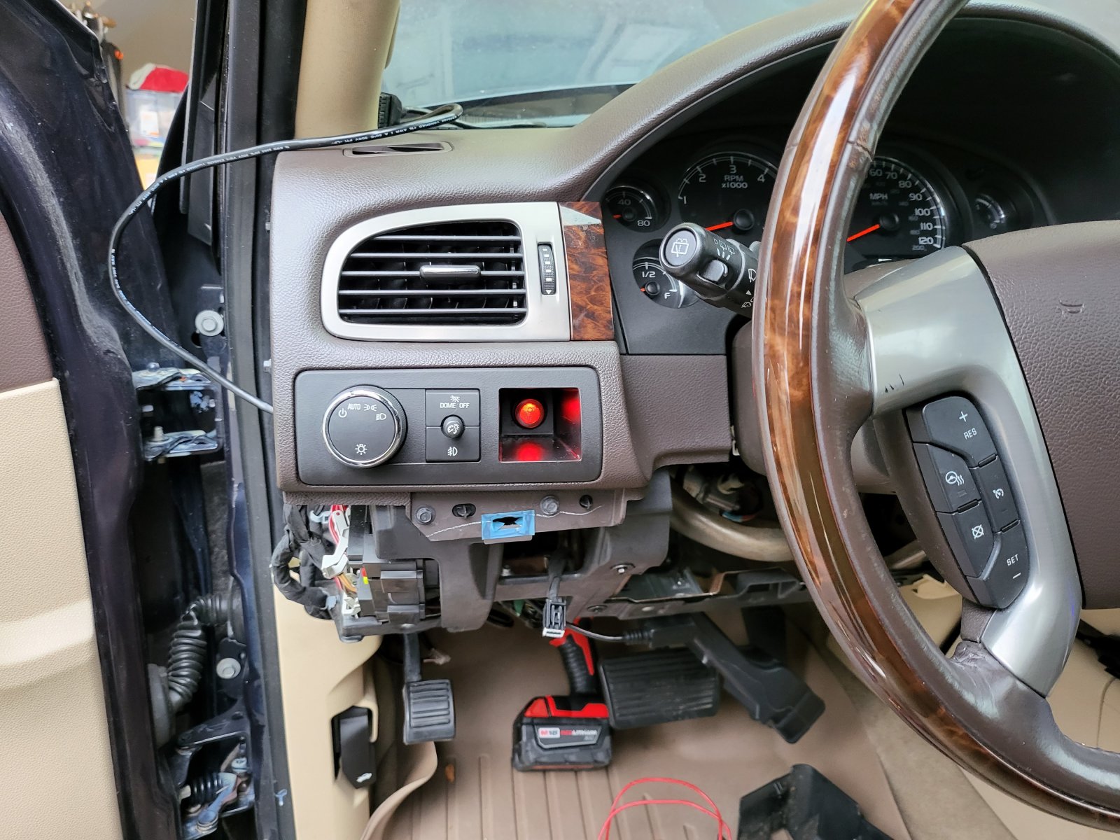

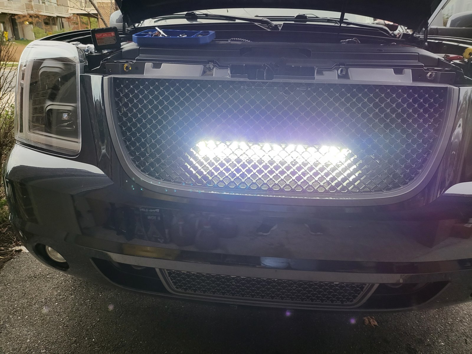

Finished mine finally, I mounted it behind the grill using concrete tapcon screws into the foam. The tapcons are thick and have lots of protrusions to grip better, that worked pretty good but I wanted it to hold better so I used some JB-Weld under the mounting bracket to further secure it to the foam. I then ran the wire to the battery, mounted the solenoid to the fender and ran the other wire across the back of the engine bay and through the door hinge and into the dash panel. I then drilled a hole in back of the empty spot and luckily the Nilight switch I bought fit perfectly snug in the opening.
View media item 28545View media item 28560View media item 28556View media item 28559

Looks Good!

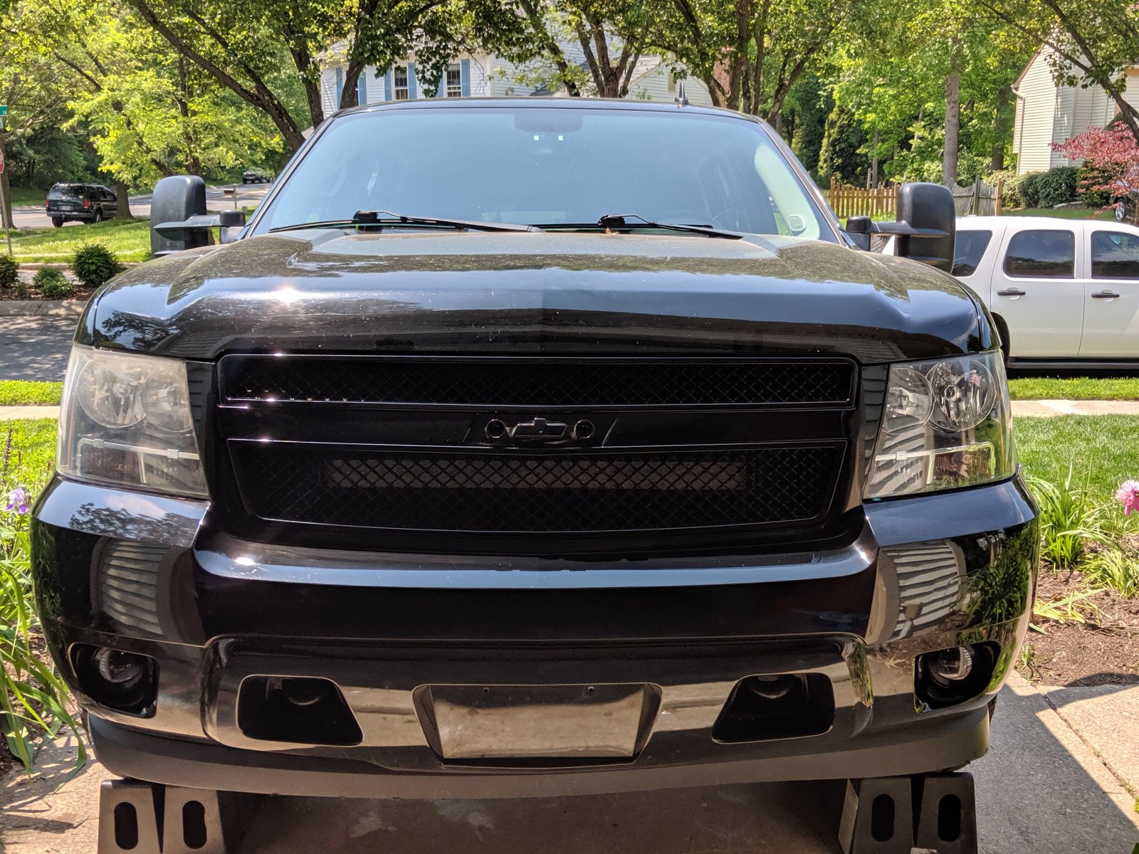

Think mines a 20". Installed the switch in the small pocket next to the light switch. Made a couple brackets to bolt it to the core support/trans cooler mount
