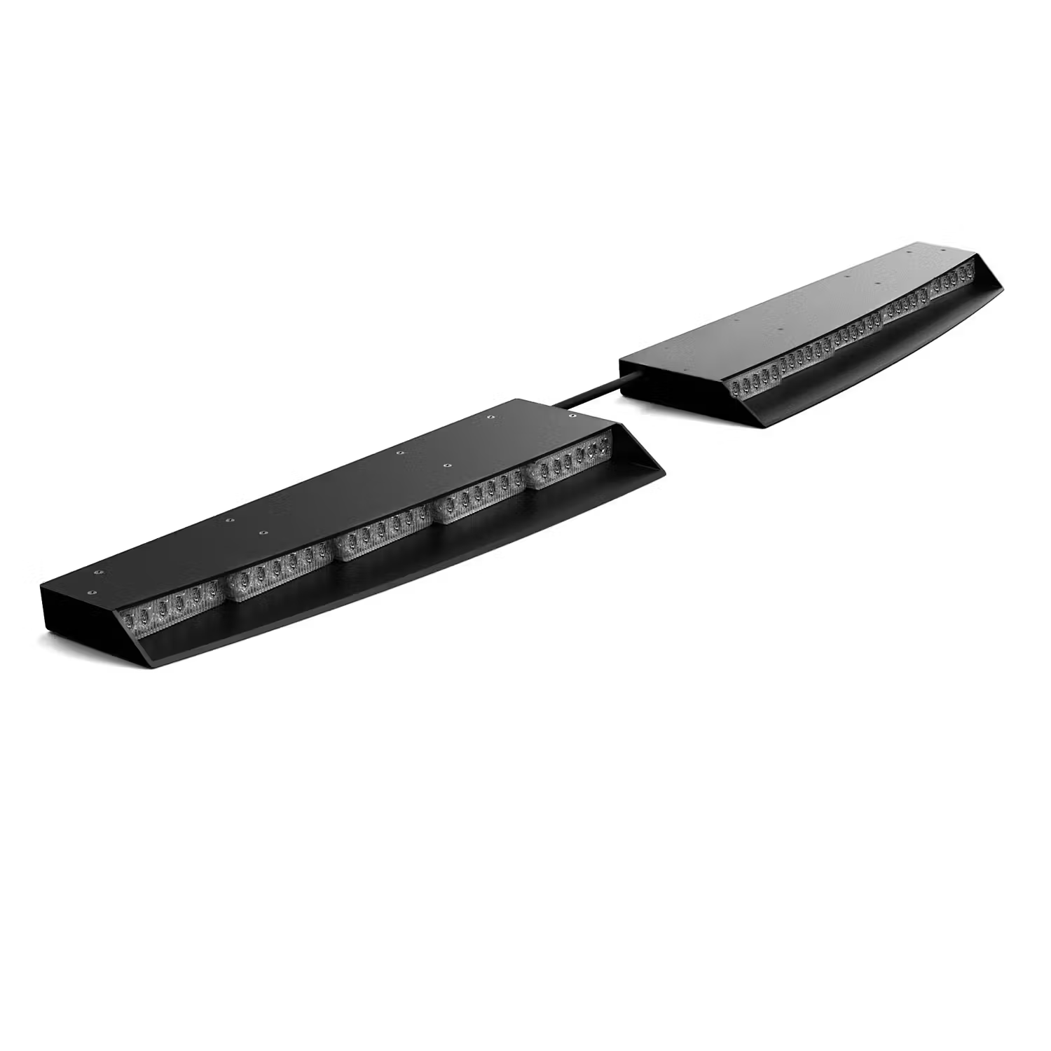

The other user provided a great description of it, below is a photo of what I was describing. I am more curious about how flush they sit with the roof and how much it affects the outward visibility from the drivers position.
Every vehicle is different and some are able to be mounted so they are out of the way, others sit lower and directly in the line of sight.

Any ILB will impact forward visibility. It depends on the manufacturer and model. The pic you posted looks like a Feniex ILB. My suggestion is to contact a local emergency vehicle upfitter in your area. It can be a task to install one, especially if you aren’t familiar with the process. Many emergency warning equipment manufacturers post basic install guides on their websites for reference. You can also find some informational videos by doing a simple search on YouTube.
