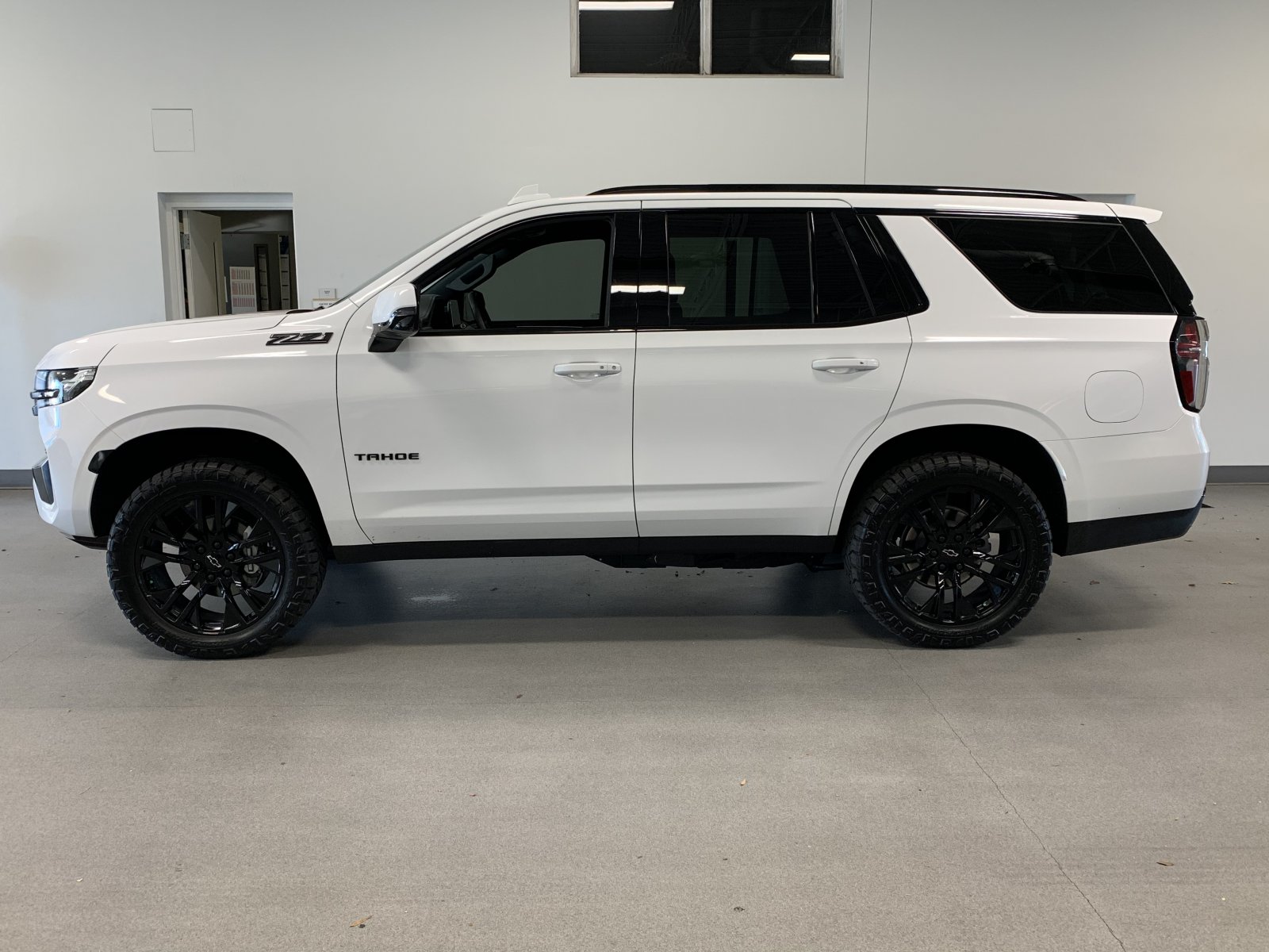

Alright. I’ve stalked this page for years and never actually posted any pics of our previous leveled vehicles. Looking back they were all white with black wheels. Not much changes I guess. Suspension maxx 2.5 front with new uca and 1.5 in the rear. Tires are 295/65/20 Toyo at2. Yes it’s tight, yes it required trimming and some more to be done this weekend. The grocery getter will definitely be set apart now.
Looks good! What is the overall height of the Yukon now? Looking to do something very similar but would like to still fit in the garage..

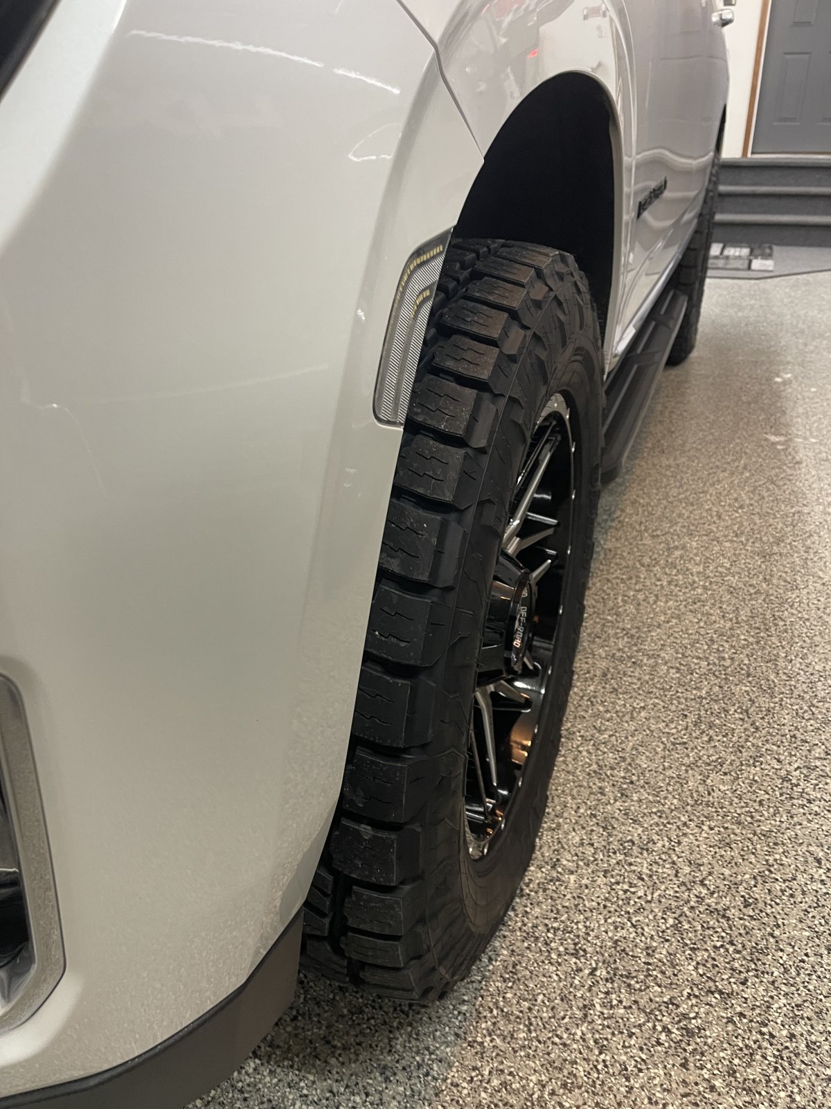

Traxda - 2" front / 1" rear lift
Wheels - XF Offroad 20x9 / +12 offset
Tires - Toyo AT3 285/60/20
Poke - No tread really showing but the bulge of the sidewall sticks out and the shoulder of the tire can be seen now. So, some "poke".
Trimming - So far just the front Husky mud flaps needed a little bit of trimming.
Roade noise - Not much at all, these are actually pretty quiet tires for an all terrain.
Raised height - Sorry guys, I was so excited I didn't get the before measurement.

I don't think so.
I did a quick super quick "test drive" and nothing seemed to rub on normal turns. I have not tried backing down the driveway apron while turning yet. If there will be any rub, this is usually where it will show up. I'll try and do a little experimenting today or tomorrow with that.
When I turn full left (maxed), the rear of the tire that is now cranked inwards towards the frame is right up again the fender well lining or at least really really close! If I end up with a rub in this area, I might try like a 1/4" wheel spacer......which I "think" would help that???? Unless I'm looking / thinking about that wrong?
I'll keep ya posted!!
FatDog
Dec 19, 2013
183
113
Did a little more test driving in and out of the driveway (backwards / forwards) while turning and no real issues.
It doe touch barely but not even enough to make noise on the felt wheel liner.
There is a small bracket that is bolted in behind the felt wheel liner that basically lines up about where the rub is. I think I'll mess around with pulling the liner and see if I can do anything with that.
Also, looking at things closer, any wheel spacer would definitely make the rub worse. I'm glad I did not add wheel spacers and I'm glad I did not go any more than the +12 offset on the wheel with this setup.

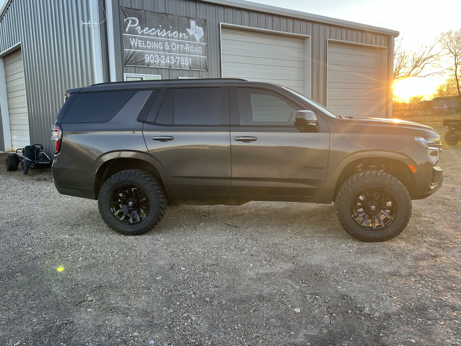

So after much research and searching around I finally ended on this set up. I’m very happy with the way it turned out!
3.5 rough country lift
295/60r20 nitro trail grappler
20x9 +01 fuel blitz rim
