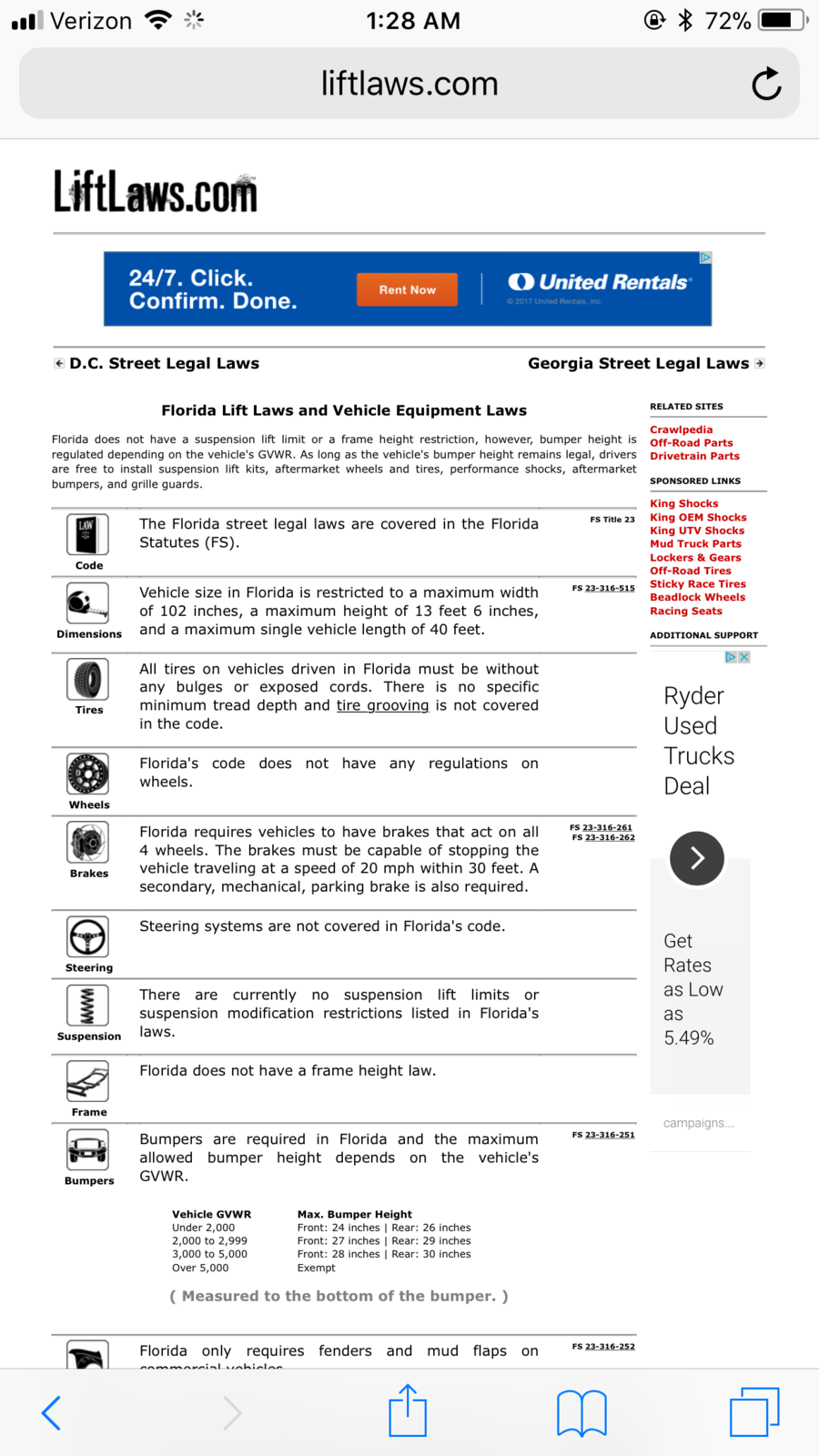

I've got a 2005 Z71 that I'm looking to put a mechanical lift on and larger tires. Only problem is I live in, and the vehicle is registered in, MA. Massachusetts has a mathematical equation for maximum lift on 4x4 vehicles: wheelbase x wheel track (outside edge of tire to outside edge of tire) / 2200 = X" of lift allowable. I can't find an exact measurement of factory wheel track width using that definition (I'll measure later myself unless someone has the #) - but I estimate that I can legally have 4" of mechanical lift. They also allow X" of tire lift using that same number. The good news is a violation to ride height has to be >1" before they can punish you for it, so right now I'm looking at the BDS 4 1/2" lift kit.
My questions are 1 - anyone here from MA and have you had any bad experiences getting stickers with their new stricter inspection procedures rolled out in October?
2. Anyone have any experience with the BDS lift kits? Are there any other 4" kits you'd recommend?
3. With a 4" lift, will I be able to fit 35"s (wheel spacers are also illegal in MA)?
Any other ideas or recommendations appreciated!
