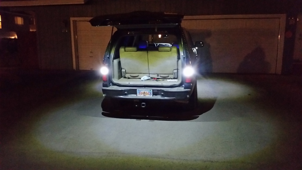

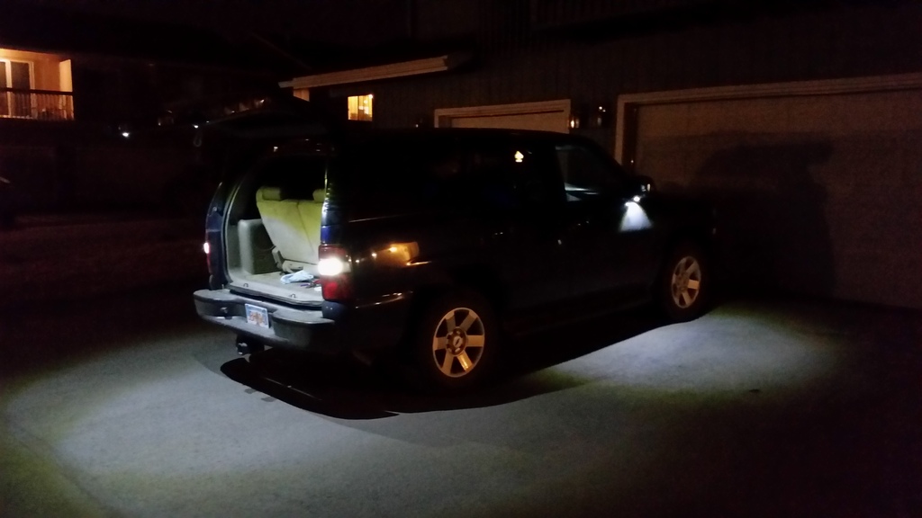

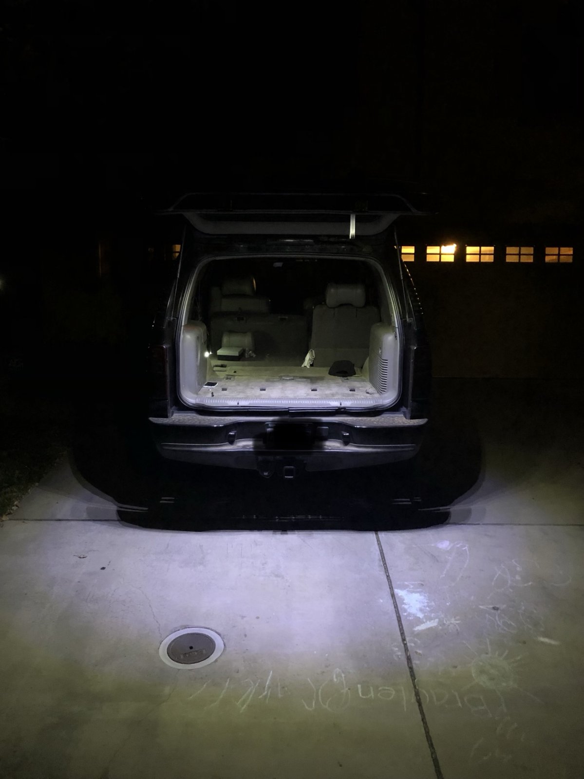

I did this mod with eagle eyes . Tapped into rear dome light . Working great no issues 3+ years.

View attachment 230912 View attachment 230913 View attachment 230914
