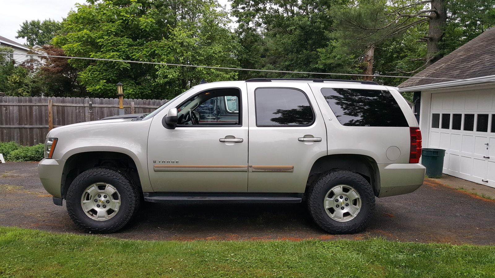

I believe it will by about an inch. I have a 2.5 CCM level on 07 Tahoe with 285/70R17 tires with stock wheels which I believe are a +31 offset. I want -12 offset Fuel Beast wheels and was told it would stick out which is what I am looking for. Heres a pic of my truck for comparison. I was also told by more than one tire place that a -12 offset with my level would require lots of trimming. I'm still trying to find out how much.

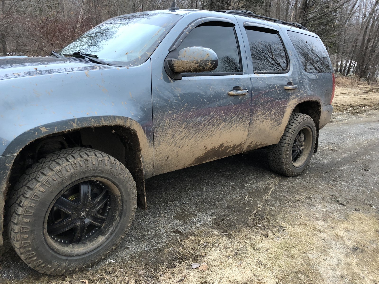

1945D1C2-2CF1-4F31-B5C8-77DE6C27FB0A.jpeg https://tiresize.com/wheel-offset-calculator/
Yea it’ll stick out. Gotta stay in the positive 30 range to be near stock.
Mine are 275/60/20 9.5” wide with a pos 30 offset and the tire just barely sticks out
