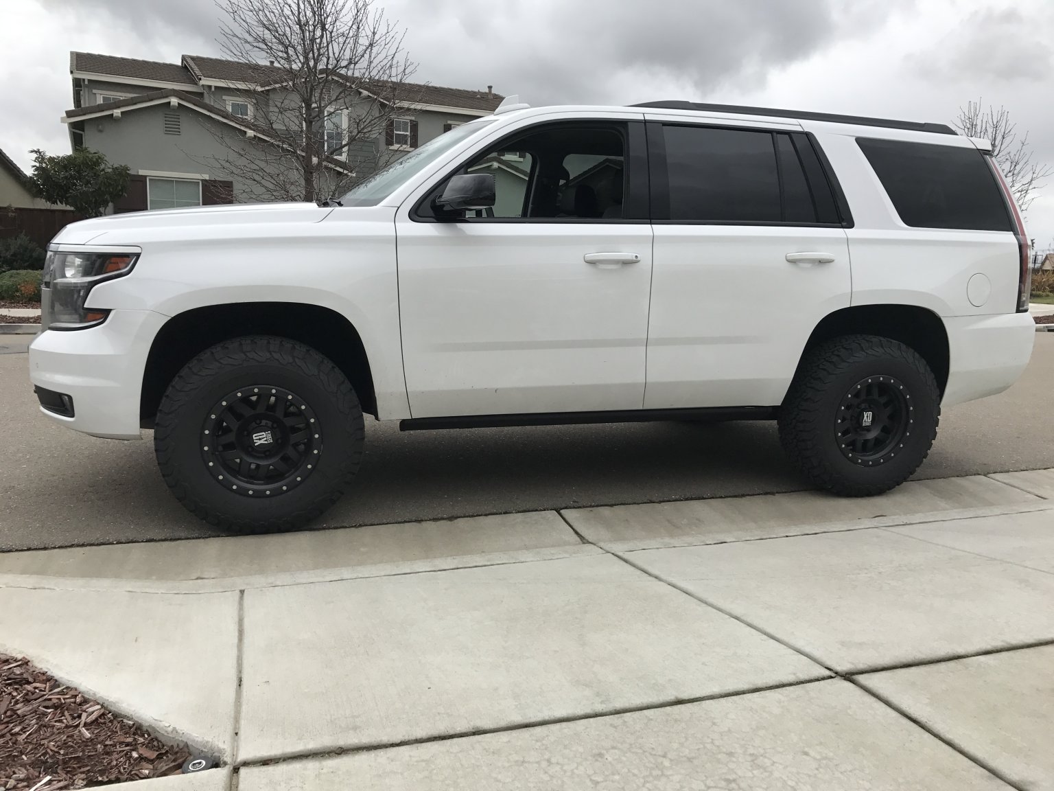

I find the 2" to 2.5" are very level, bordering on making the front a little high at times. I didn't want that, so I went with the 1.5". I really like the idea of the Bilstiens and being able to dial in exactly the height you want. I'll probably go that route when I need shocks but it's hard to beat the price of the spacers when the shocks aren't worn out.

Which leveling kit did you use & do you have any side pics? Planning on leveling mine soon, trying to decide between the 1.5" or the 2".

I'll see if i can get any side pics on a level spot. I have the Suspension Maxx 1.5". I also have the Max trailering pkg with the rear load leveling. You can get the 2" spacers cheaper than the 1.5" so that sort of sucks, but I knew I never wanted the front higher than the rear.
And for me the alignment was required after the spacers.

Thanks for the pic and info! I agree, I don't want the front higher than the rear either. Nice ride btw!
