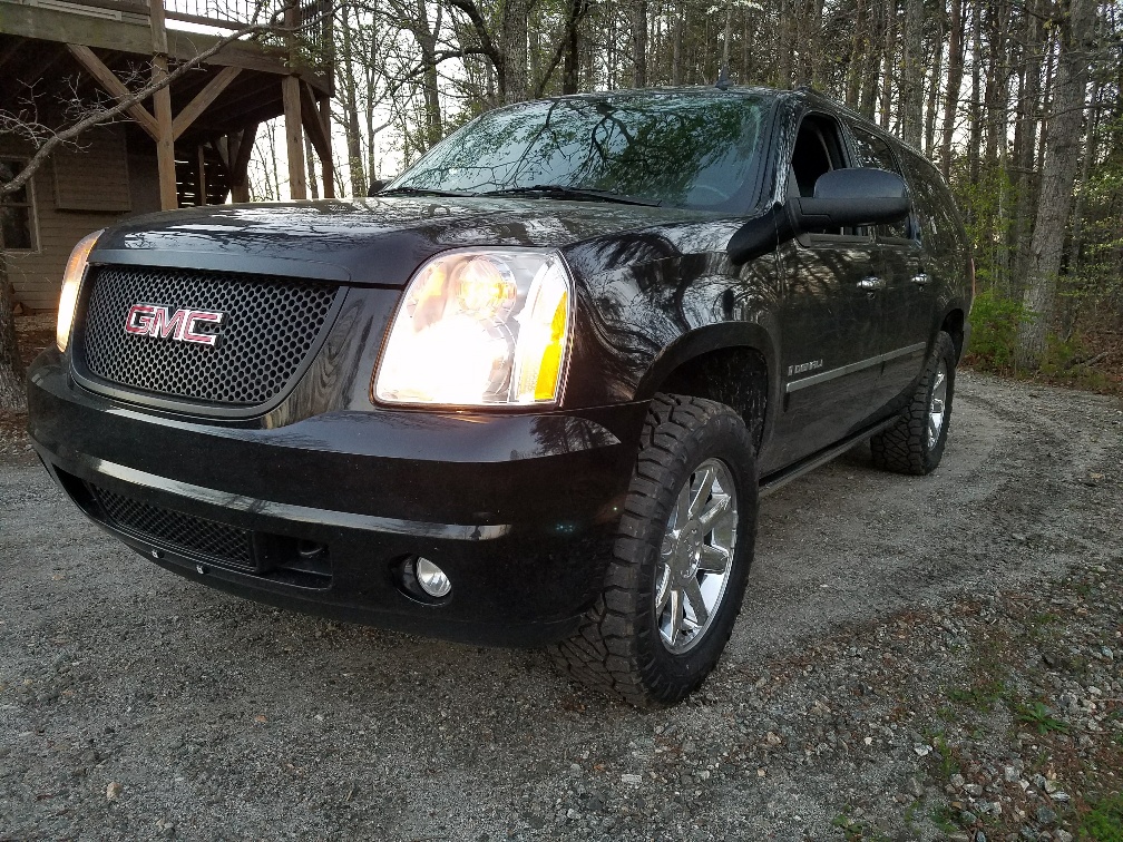

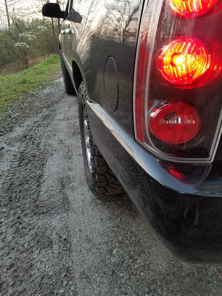

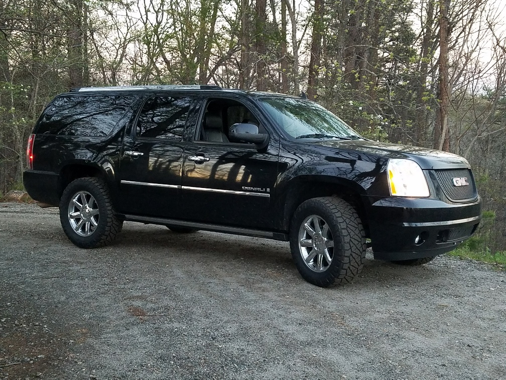

I just lifted my 09 Yukon XL Denali with a 2" RC on the bottom of the strut. I kelp the stock 20" rims also and wrapped with 295/60r20 Nitto Ridge Grapplers. I had to trim the back inside plastic some and on the front I pulled the plastic liner back so I could modify both front and back of fender well. At the firewall I used a sledge hammer and bent the bottom corner a little and reconnected the plastic (can't even tell I bent the metal). The front has a plastic shelf that the liner connects to at the bottom, I took a drimal and cut about an inch off it and reapplied the liner (can't tell it's been cut either). The 295 just barley sticks out past the fender and the rear is dead even. I hope this helps

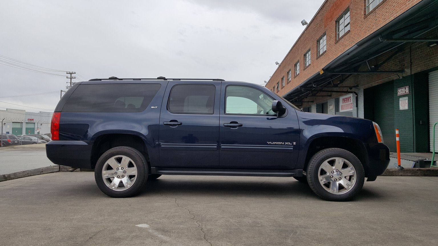

Question for the guys who've had leveling kits installed. If you're fender height measures 41" in the front and 43" in the rear, what's the purpose of installing something like the CCM 2/1 kit? Wouldn't it make more sense to just get a 2" kit up front to be level? I'm upgrading my shocks to Bilstein 5100's, replacing my tires with Nitto Terra Grappler G2's, and I need to decide how I want to level it out before this weekend because I'm planning on having all the work done Friday/Saturday.
Tractoman
Mar 1, 2017
59
24
Here's mine with CCM 2.5/1 kit installed. Still on 275/55r20's. Gonna go 275/60 or 65's but have too much tread now so I'll wait till I need tires. Put 5100's in when I did the CCM kit.
