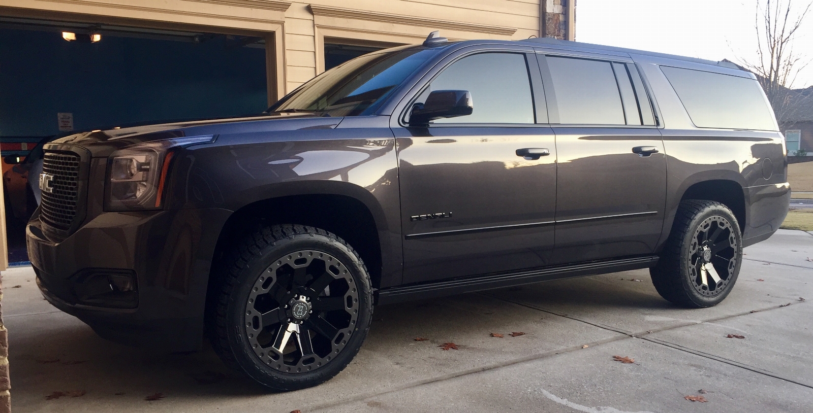

Just installed the SuspensionMaxx adjustable leveling kit for my 2016 yukon xl denali. Looks great! Rides smooth as ever! No problems so far. I'm getting new wheels installed tomorrow so I'll take some pics then...

Here's mine with 305/55R20's.......the only thing I will change is going to Nitto Ridge Grapplers next set.
