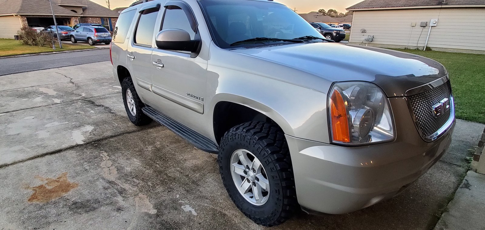

I ordered a CCM 2.5/1" leveling kit for my 2014. Should be in this Friday and hopefully I'll get it on this weekend. I also ordered a set of toyo open country at3's in 285/70/17 and a set of vision manx 2 overland wheels in a 17x9 +18 offset. Should give me a little poke but not extreme. I may be wrong on that. We will see. I'll post once the level is on and then when the wheels and tires get here from custom offsets. I can post about the install of the level if anyone is interested. Just let me know. First little build thread. Wanted to give it a whirl.

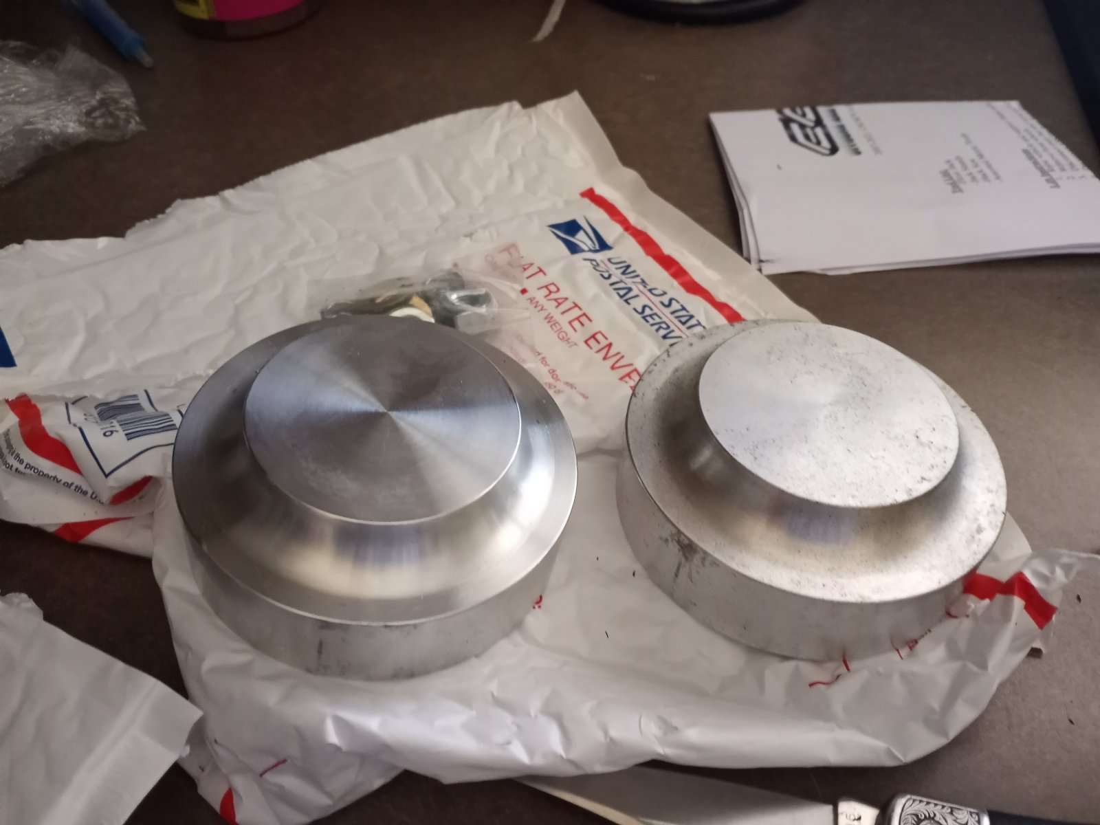

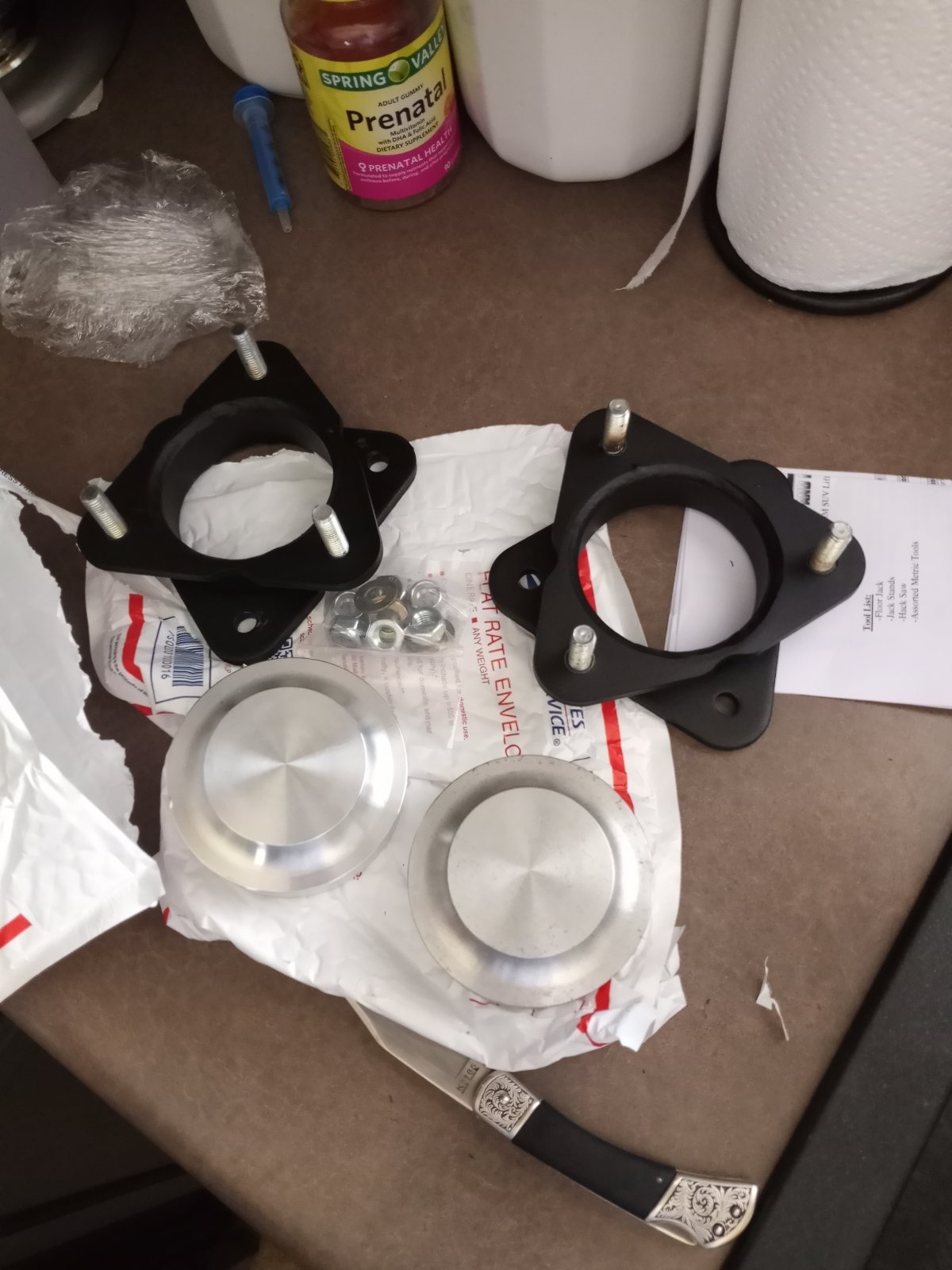

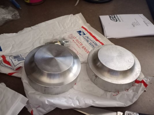

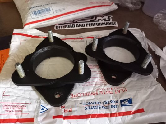

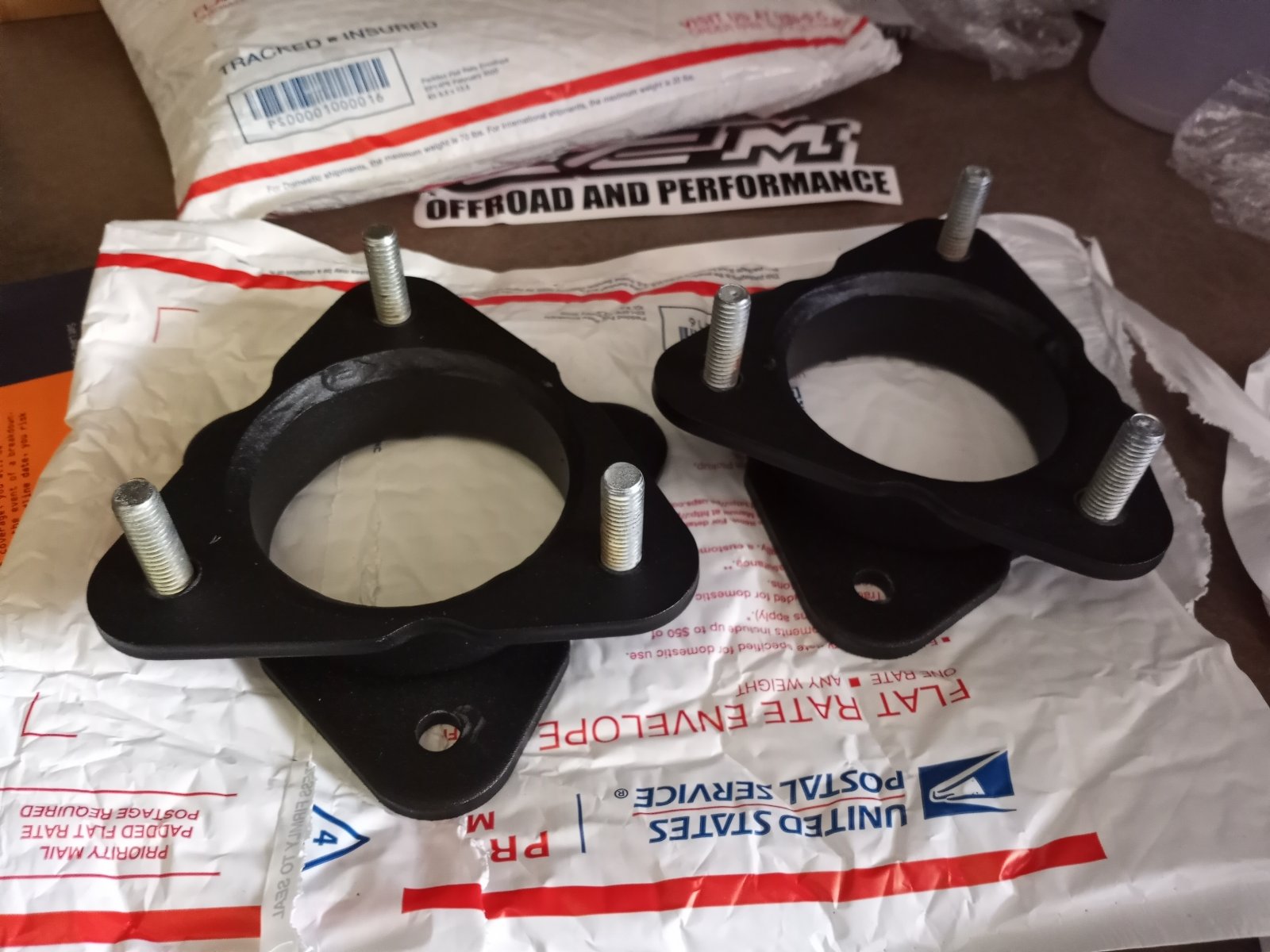

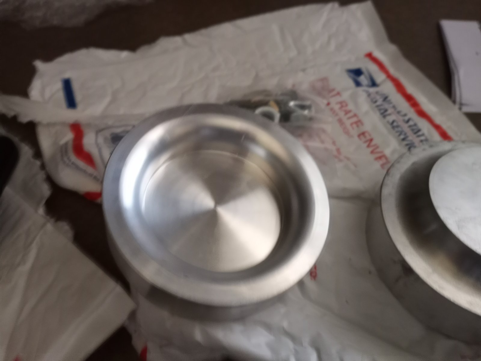

Quick update. Got the ccm level in and I'm very impressed with the quality. the rear spacers are billet and look great. For the front, the spacers have very nice welds and come with the hardware needed for install. Hopefully I can get this installed over the weekend.

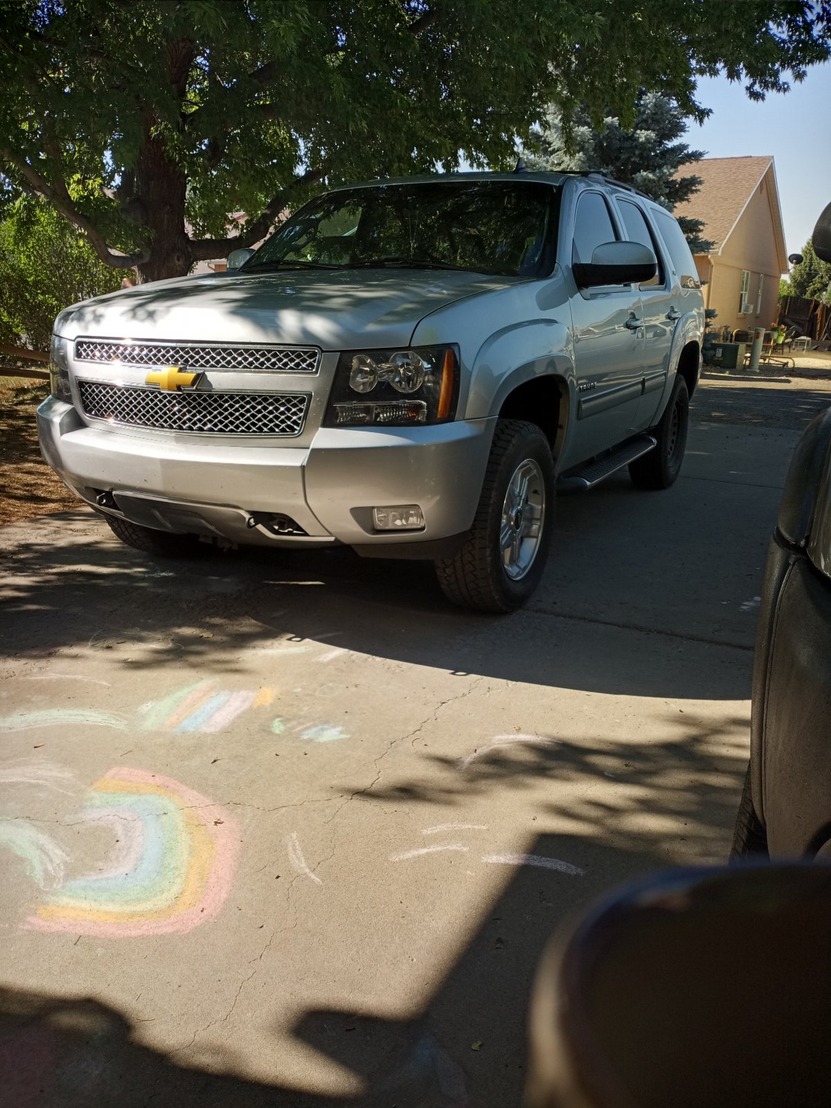

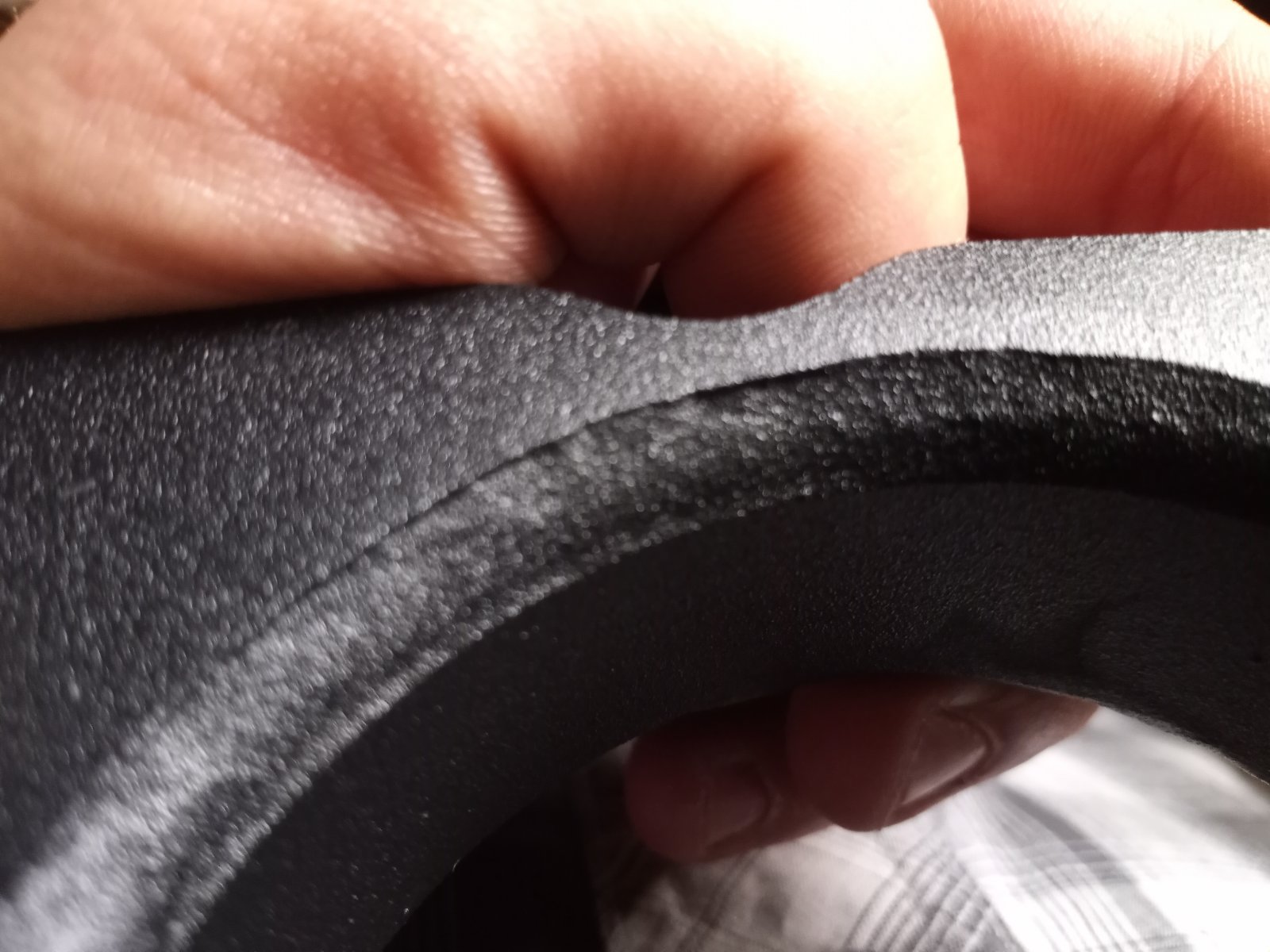

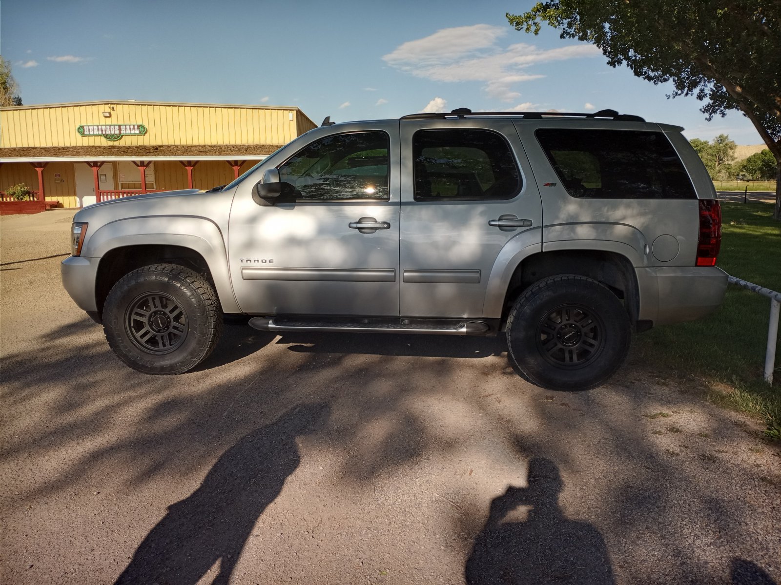

Ok got the wheels and tires on. Looks badass. With the +18 offset over the factory +34 (I think) I had to do some heavy trimming. I still need to do some minor touch up trimming so I'll post pictures of my less than impressive trim job when it clears completely.

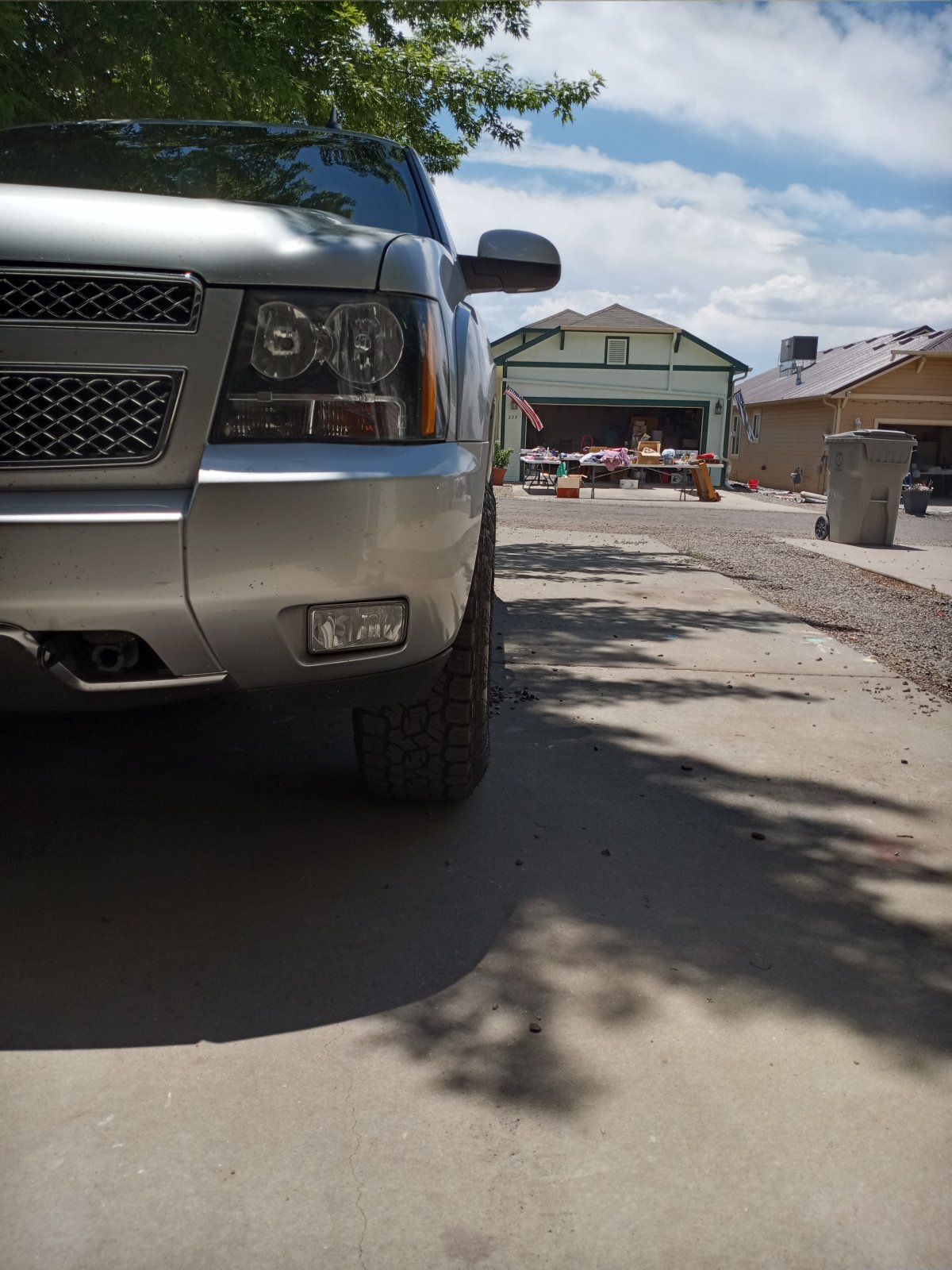

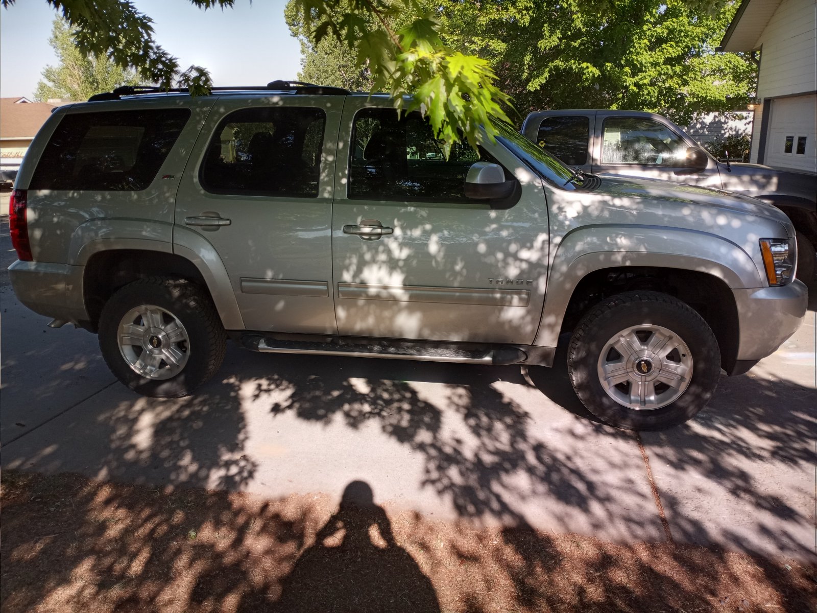

Side pics please. Would like to see how much they stick out past the fenders.
They are nearly flush. In person it looks really good. The sidewalls bulge just outside if that's the look you are going for.

Vision manx 2 overland wheels. 17x9 +18mm offset. Tires are toyo open country at3's in a 285/70/17. I still haven't got any pictures of my trim job. It's not pretty but had to so they would clear. I might see about getting new liners and doing it a little different. First time I have ever had to trim anything. This setup looks really good in person. I have more pictures on the custom offsets gallery. https://www.customwheeloffset.com/w...tahoe-vision-manx-2-overland-ccm-leveling-kit
