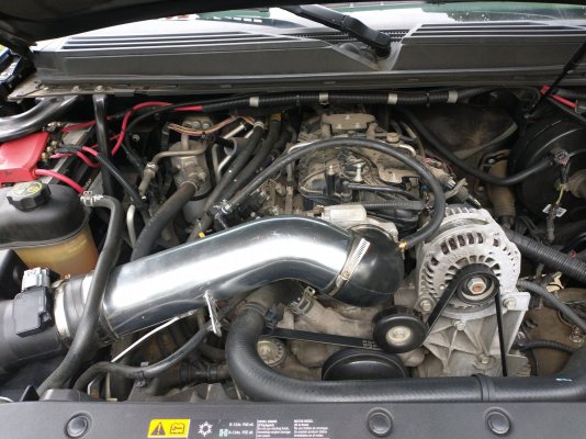

Yeah, I've tossed around all sorts of ideas for intakes. I probably won't actually use a dryer exhaust.
I mean, really, my current intake tube would be fine if I just switched out the rubber elbow for a "mandrel" bent variant.
Also, losing the resonator chambers will let you hear the intake growl in proportion to load. You'd probably barely hear it over the exhaust, though. I had my MIT before my muffler and was satisfied enough with the growl for a while that I didn't care about a louder muffler.
I like the BTR truck cam kit for under $400, with their mild "Torque" cam. It comes with springs and pushrods.
They put together good stuff. You're on the right mindset for this rig. Although, that 6L80 lets you get away with a little more cam, especially if you're interested in taller gears. But, it can be a slippery slope with more cam, a torque converter, etc. Pick a goal and stick to it.
