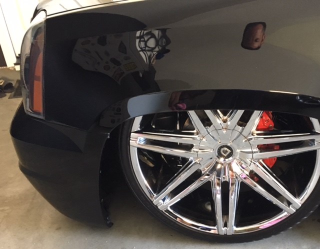

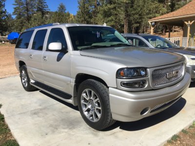

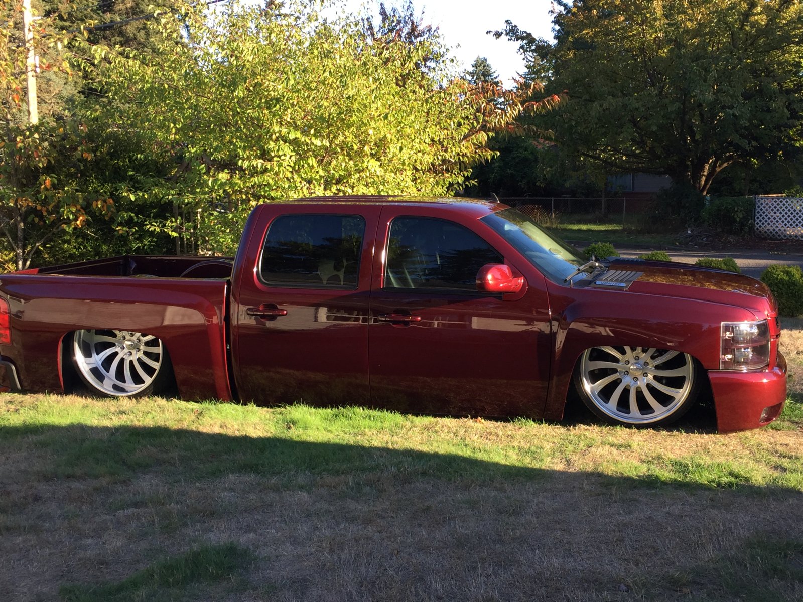

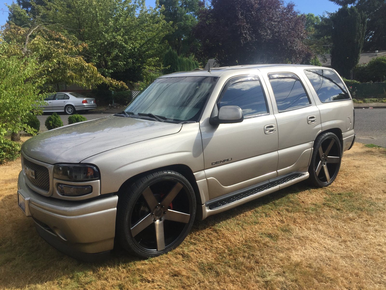

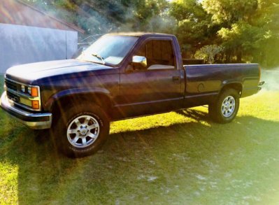

Any 6-lug GM wheel from any year of truck or SUV will fit as well as thousands of aftermarket wheels. Your choices are endless. Some here run up to 30" wheels on here but most stay in the 20-24" sizes. My 02 has run 26" Dub Ballers and currently 22" Replicas. My 08 Silverado is bagged and runs 26" custom intro billets. AWD has nothing to do with wheels other than it's important that the tires all need to be the same diameter.
View attachment 210206 View attachment 210207 View attachment 210208

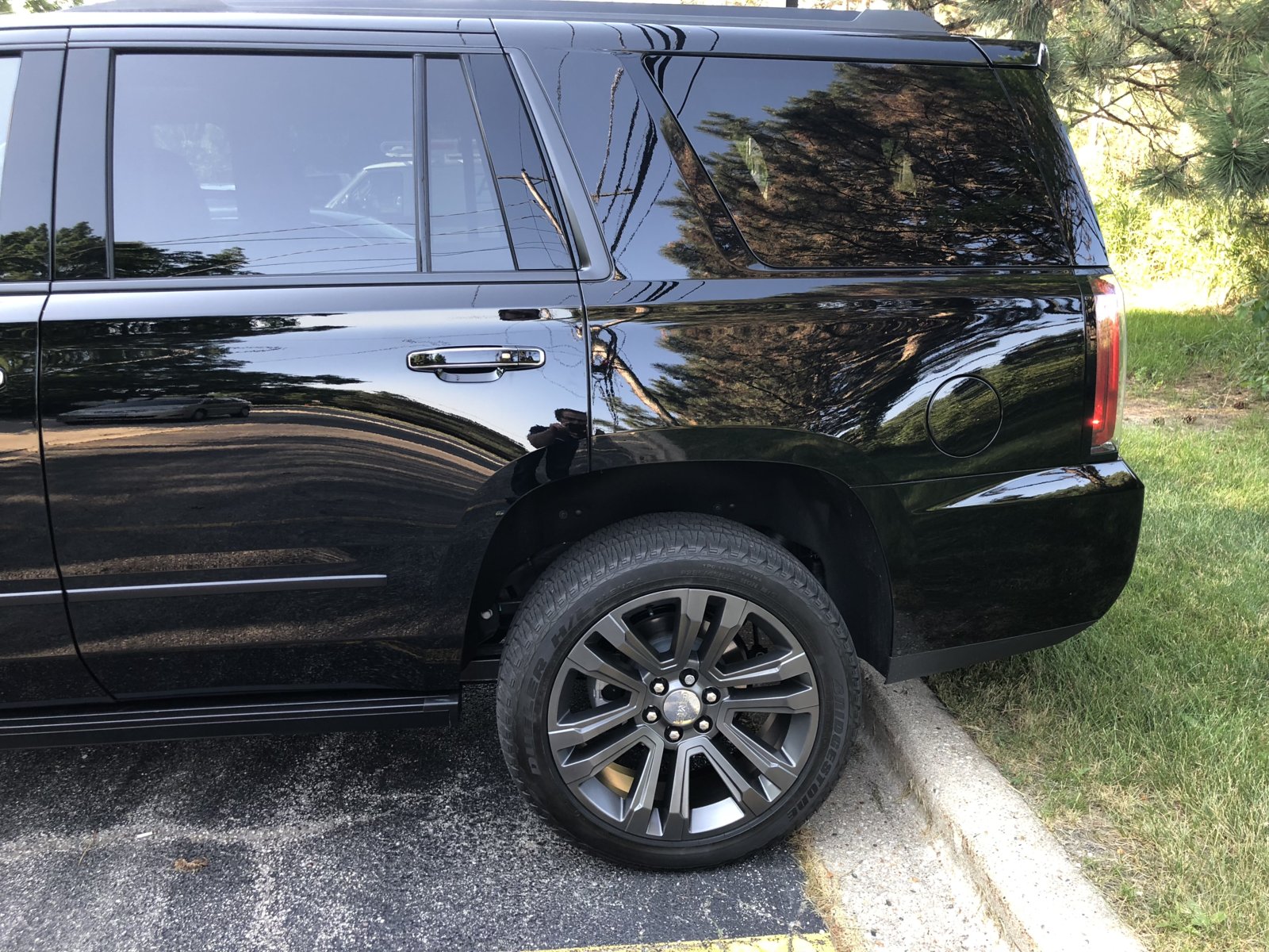

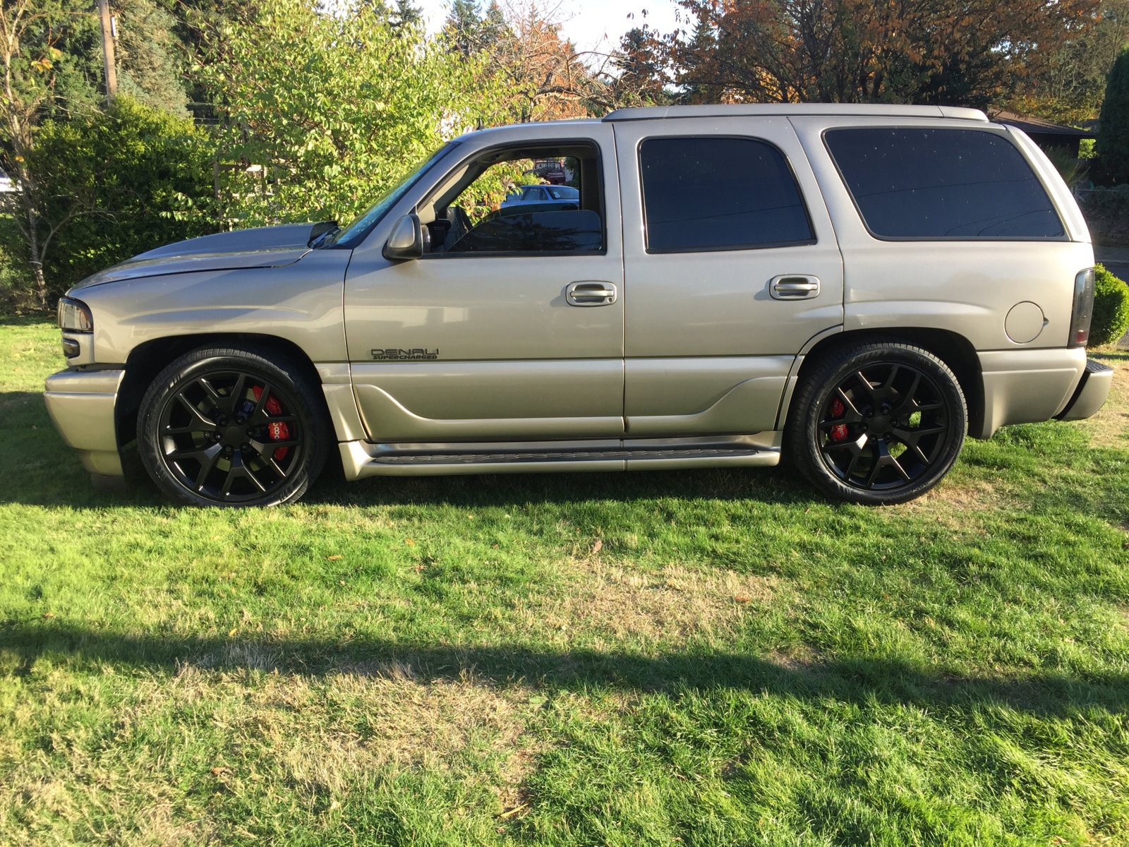

The other part to the AWD question is that tires need to all be the same tread pattern. Otherwise it screws up the stabilitrak. @TravisBurrell , But like he said all the 6x5.5” lug nut pattern wheels from the full size SUVs and trucks will fit on a 2014 Yukon Denali. I had the chrome 20” 8 spoke Denali wheels on my 2006 for about a year and a half. Currently I have a set of 2015 Denali 20s mounted up:
