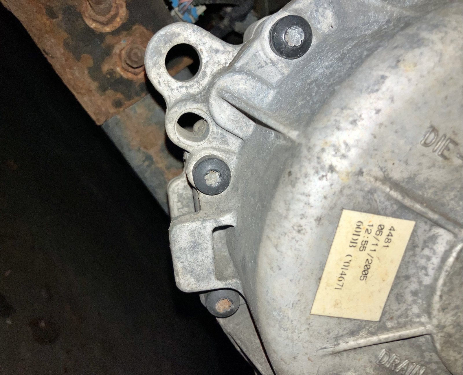

NP149, I think is what that model has?
Have you checked the Owner's Manual to see what it lists?
Autotrac fluid as @Fless mentioned (the blue stuff, but they do make a red version) is for the NP246. That one is unique in that it uses a clutchpack similar to an automatic transmission, so that's why that Tcase requires a special fluid. The non-auto Tcases don't require that.

I think you have the NP149, can you please confirm?
Those NP149s have been proven to be pretty stout in the dtag racing scenes, even though they weren't really designed for high powered stuff...

no worries…I do know the Auto-Trak ll stuff is for later trucks and not mine...
my transfer case has a 4481 sticker on it…I see NP5 on the RPO sticker...
