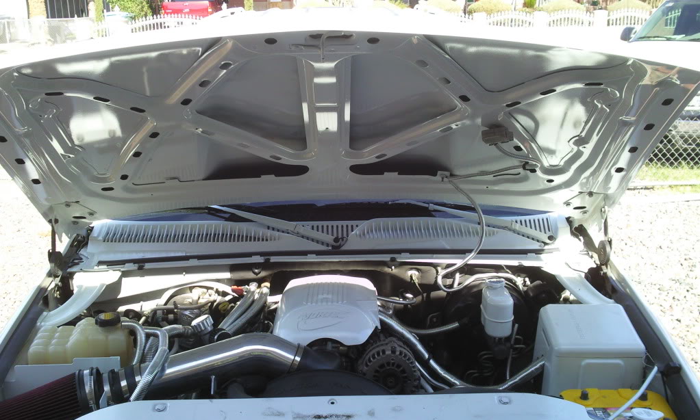

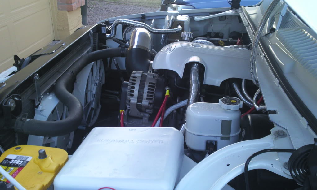

So I know most people don't dress up there engine compartment, but I always have cause I love working on my own rides and looking at something nice is always a plus. Here is some pics of my engine compartment
Lets see what you got!!! Always like getting ideas from other people!! BITIN!LOL

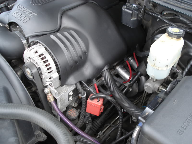

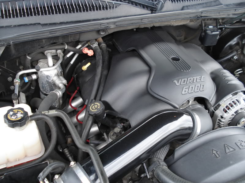

Didn't realize until now, but I don't think I took any good pics after I finished the s/c 6.0 build, but here's what I do have:

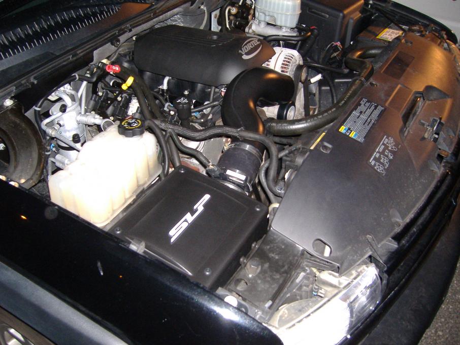

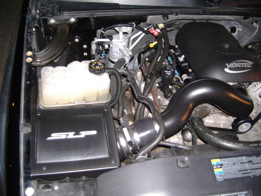

Only a SLP intake But hey why not. Pics from the other night when I put it in.

White out: one small critique.
get rid of those yellow plastic insulators on the crimp caps.
You can easily dress the ends up with some heat-shrink tubing.
Will both look better and actually do a far better job of protecting the connection (especially if you cover them with vaseline or dielectric grease before hand).
Just one of those little niggles that makes the difference between looking DIY/Shadetree and pro/stock.

I hear ya Eagle. Didn't even think about that till you brought it up. appreciate the critique. Looking good JK!!! Don't need to do much when you got a blown 6.0 under the hood!!!

Thanks man. One of these days I'm going to fiberglass a couple covers to go on each side to cover all the hoses, harnesses, etc to clean it up some. Thinking about painting them black then airbrush something like Supercharged 6.0 or something on them in some sort of wicked font. That's the plan anyway.

man the painted engine cover looks awesome! how hard was it to get the paint to stick?
Would like to know as well! SOme type of high temp rattle can paint?
There sure is a lot more room with those E-fans too. Really want to do those soon as well.

thanks!! Ya, the E-fans was the best thing so far, as far as engine dress up-owe ya, it also helped ALOT!!! I actually made them myself, instead of buying the $300 silverado e-fans, went to junk yard, bought some 13" fans, made some custom brackets, and walla!! turned out pretty good.
As fas as painting the plastics. Had my neighbor spray the coolant, brake and electric box plastics, did it cheap was the only reason. But for the middle vortec plastic cover, e-fans and some other plastics, used Krylon plastic paint with High Temp clear coat. So far, so good. Been on there for about 3 months now, with absolutely NO peeling, cracking, chipping, fading, yellowing, NOTHING!!!. If your not gonna use a plastic paint, and just a High Temp paint, make sure to sand thuroughly, use prep spray, and usually a paint inhebitor is the best bet. Also primer!! But gotta say, have used Krylon's plastic paint on alot of other stuff off the car, and it works great!!! Doesn't really get hot enough to peel paint inside engine bay, unless really close to headers. from my experience
