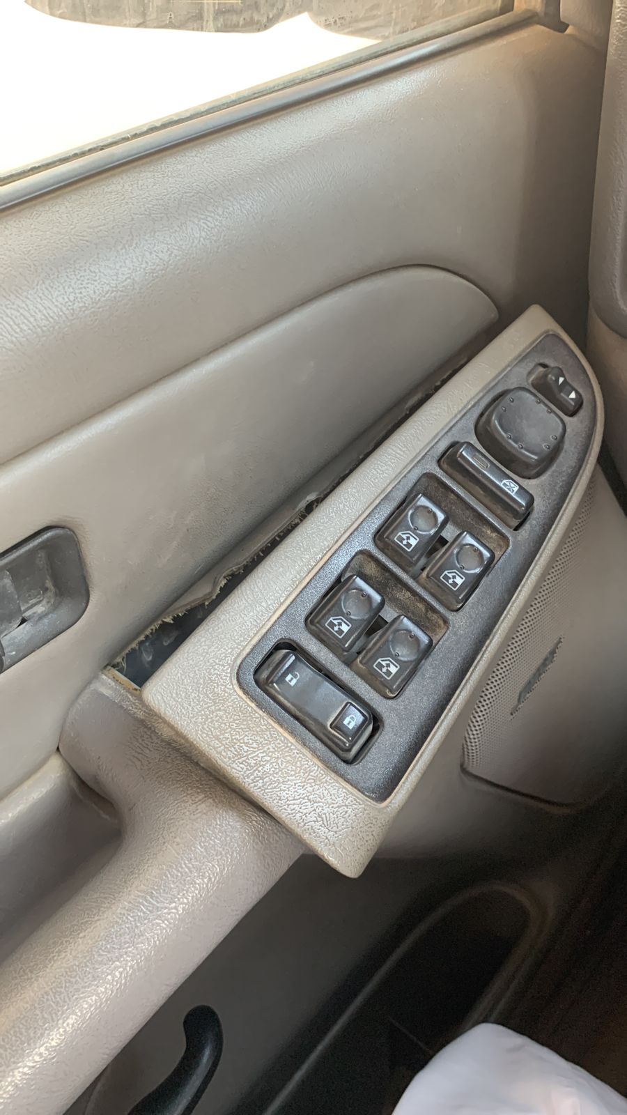

Can someone help me find a used Left Driver Side Front Door Panel. I did my best however, until now I am not able to find one.

The whole panel need to be replaced because of few damages from inside

Looks to be only the armrest needs to be replaced, not the entire panel. That plastic breaks all the time.
I think from looking it is the plastic retainer on the door panel side for that piece, where it attaches on the posterior portion to the door panel. I have that problem on both sides, you have to replace the panel. <sigh> There's not a replaceable clip there, it's a plastic piece that's molded in - unless you want to try to fab something, which would be difficult, as you can't permanently attach it. At least I don't think so.

You should send those panels back. Maybe you could plastic weld the old clips back on.

You are right, we have to replace the whole panel.

Your GMC dealer may be able to order one. When mine broke last year, there were a few in stock. I also some some avail on Amazon. Last, as others have suggested, try auto recyclers. You may have to use one that has nationwide connections. All that said, I just secured mine with clear silicon adhesive and it's going strong.

Funny... mine just broke in the same exact place when I was trying to pry out my window switch. I hate the idea of having to replace the ENTIRE panel for one stupid clip... I'm gonna fab up something to hold it in place. Was thinking of hot glue, but then I figure it might melt in the summer heat when it's parked outside.

The driver's door switch bezel on 2003 and 2004 (maybe also 2005-06) is held by a clip on one end and a screw on the other, IIRC. The door panel has to be removed to get at the screw; prying will break off the screw tower. Ask me how I know....

Mine is broken, too. It's just held on by silicon, right now. When the door panel is removed, a razor will remove the silicon. :)

So...you all are saying it's not the bezel itself, but something inside the door panel that's broken??? My panels are great looking. There has to be some other fix???
That's what it looks like to me too...same problem I have on mine! In the picture of the underside of the armrests I posted, you can see what the slots are supposed to look like in the white plastic. And you can see that they are far too easy to break off! But after doing a bunch of research, it does look like only the arm rest needs to be replaced...and they are available on ebay! As are the bezels, in case you broke the front screw too. Any idea how to R&R the arm rests?
I'm guess I'm going to have to buy a set of armrests with the tabs intact. How can I reinforce the tabs? Or does looking at the pic give anyone an idea of how to fix them?
