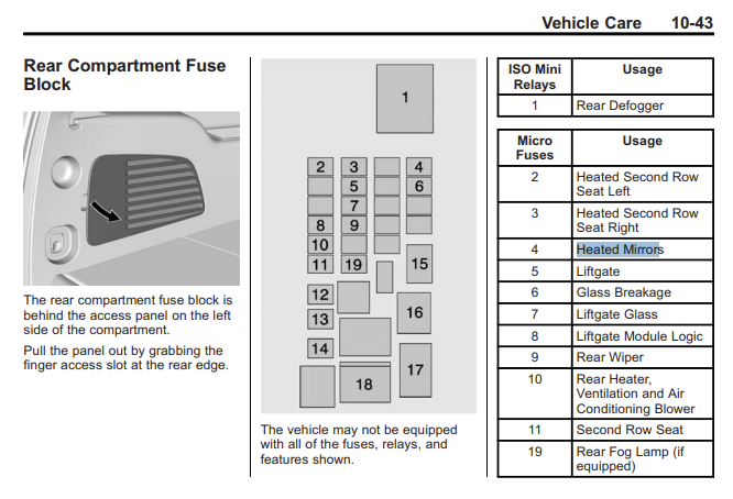

I just went back there and this is what I have, slightly different? There are no teeth for the fuse to grab in space 4? On my sticker in my glove box I do show DL3, which I understood is heated mirrors. The mirrors do have blind spot detection, turn signals, and power folding.

I found out my owners manual shows spot three for heated mirrors, and the fuse looks good, but they are still not warming up.
Any other thoughts?
[EDIT] It was actually this website that shows it, the GMC Manual page shows the spot that @Fless showed me. Fuse Panel

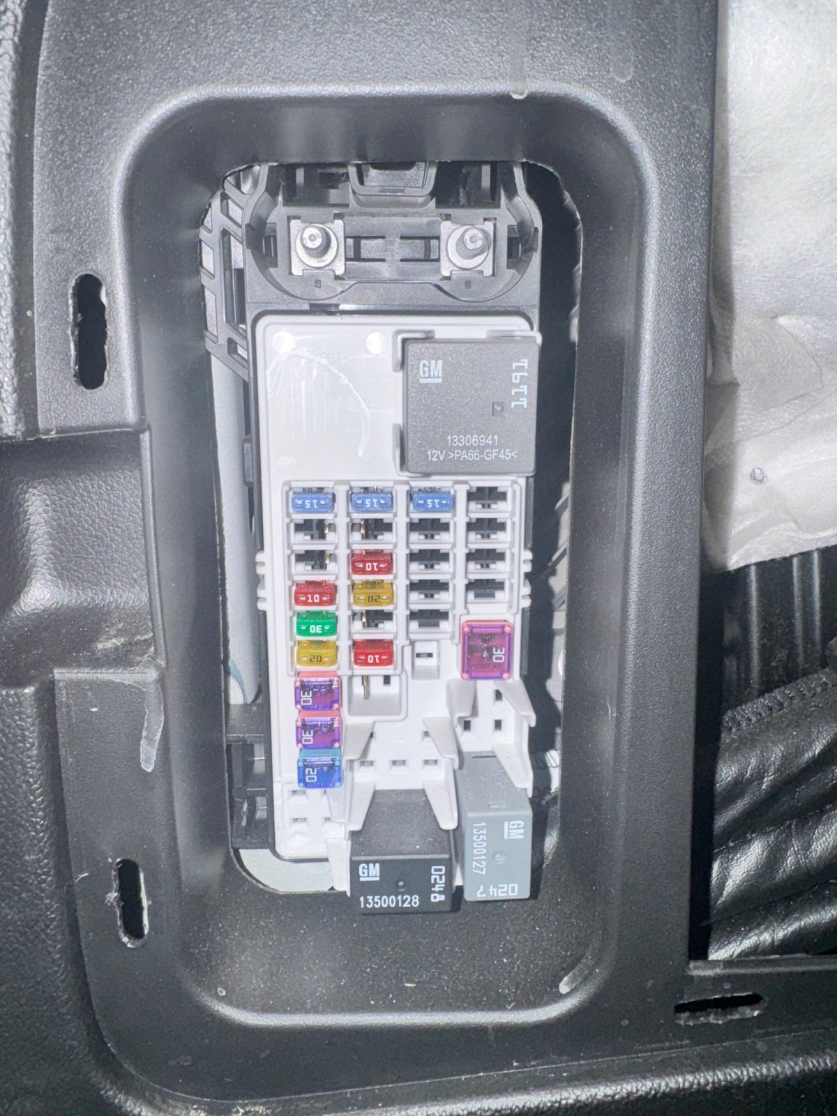

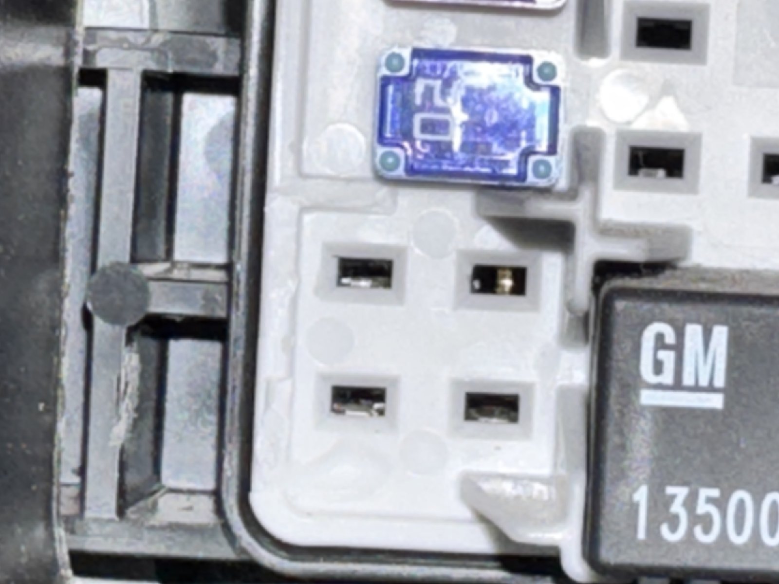

Very concerning that I’m missing that relay in the back? The 19-2? I can’t tell if it has teeth or not to receive/hold the relay. Photo attached.
I have a voltmeter and its current set to DC. When I touch the black and red to each fuse, it beeps. Am I doing that part right?
When testing the mirrors, do I test with the rear defroster on? Do I touch the pins to the female wire connectors or male part that is in the mirror?

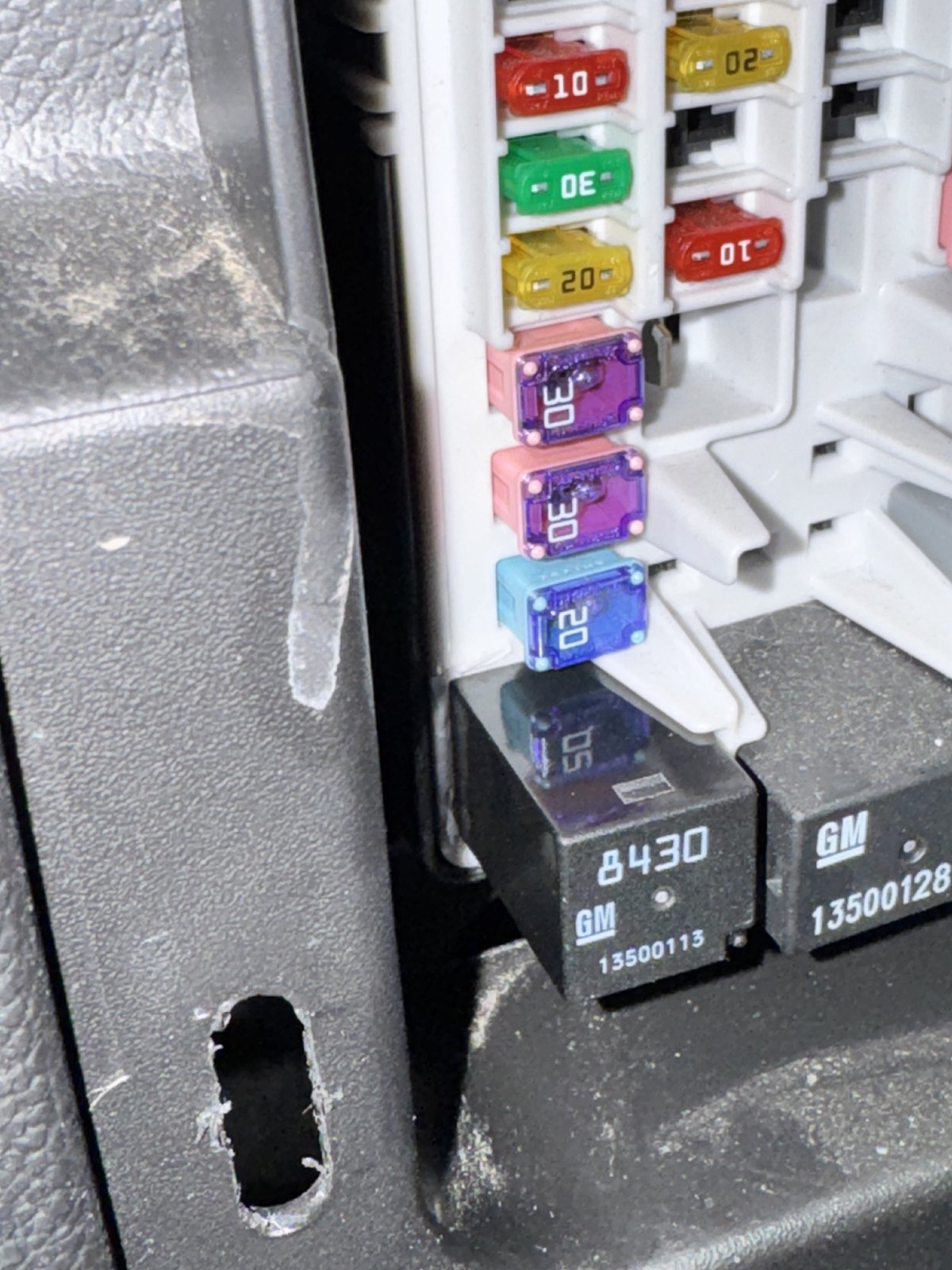

Solved! Turns out the relayfor heated mirrors (8430/13500113) was missing. Popped a new one in from Amazon and they heated right up!
