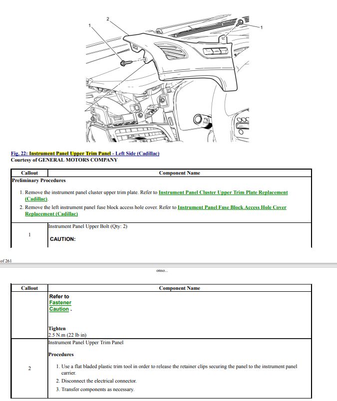

Does anyone know how to remove this trim/vent from a 2015-2022 Yukon? I'd like to replace it with a new, non-scratched piece and don't know how much is involved in the swap. Thanks!

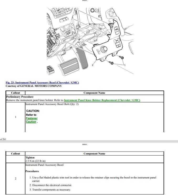

Maybe this will help?
