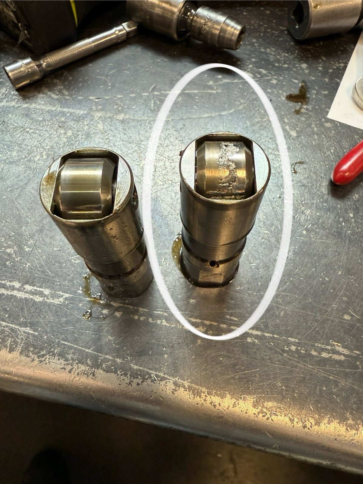

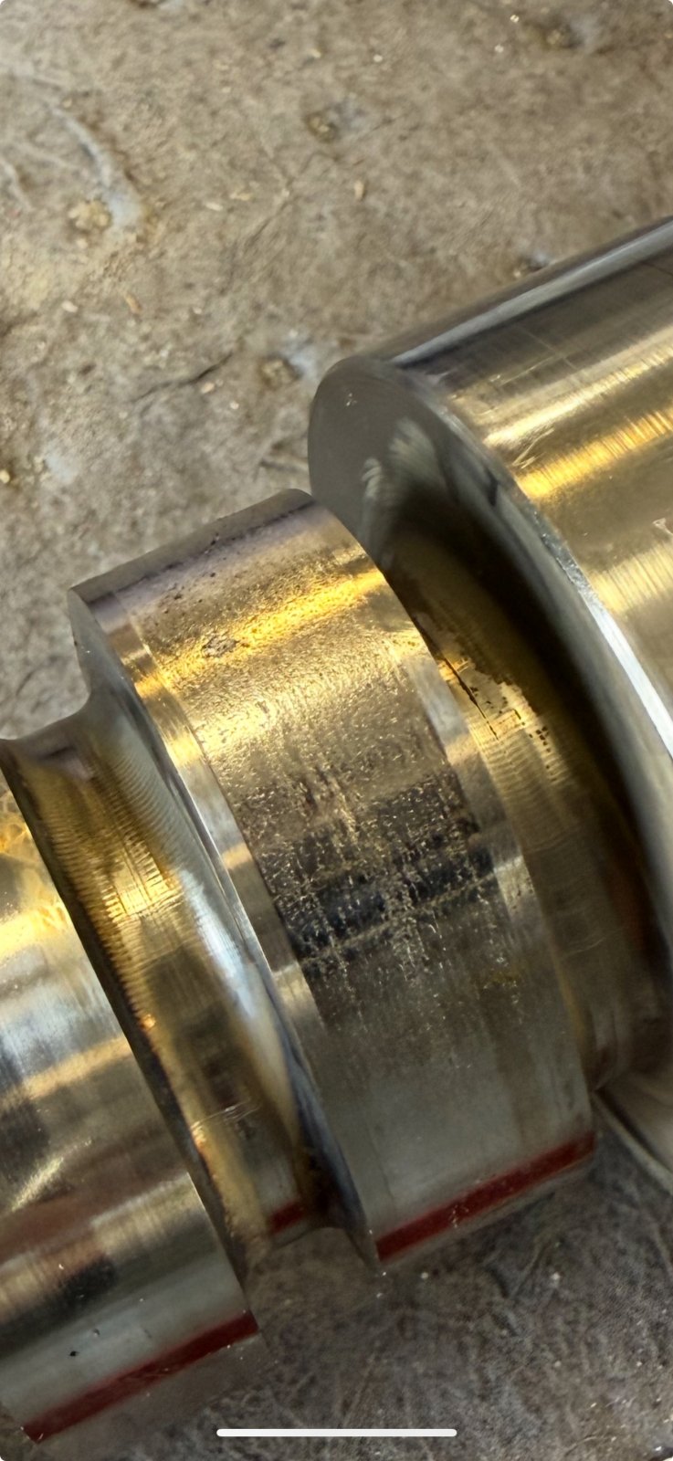

Hi, This old man advice doesn’t help you choose another exhaust system, but save your money for absolutely necessary repairs. I have a 2018 Denali with the 6.2, 72,000 km (about 45,000 miles) and had an AFM lifter failure. That took out the cam lobe, requiring replacement of the oil pump as well. Out of warranty so dealer repair was $12,000 Cdn (about $8600 US). Needless to say that was painful as it was not a budgeted repair. I have owned a Surburban or Yukon since 1981 and this will be my last.

Ouch. I have a 2018 Denali ultimate and just crossed 125K miles. I just replaced my belt and noticed my water pump is failing and a new one from rockauto was just delivered today so I’ll nip that in the bud this weekend. Curious, did you disable AFM after your lifter failure? What did the repair entail? I figure if/when I have that issue I’m gonna rebuild and change cams and just delete the AFM mechanically.

No, I didn’t have the AFM disabled when the repair was done. The local GM dealer accomplished the job and I don’t think they would disable it. It now has a 1 year warranty, valid at any GM dealer. The repair entailed Replacing: cam, lifters, oil pump, heads out for overhaul (guides, seals and machining) extensive flushing, waterpump as a precaution. Then new oil, filter, antifreeze and all new fasteners and gaskets. The mechanic did a great job and the result is a smooth running 6.2 with more power. After the countless GM engines in cars, trucks and boats there won’t be any more. I will be going over to the dark side!
