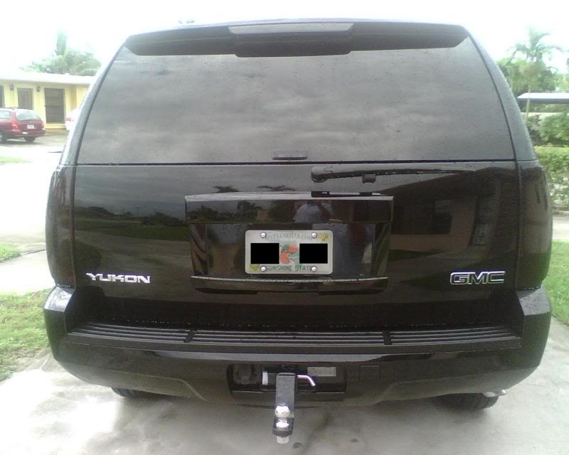

Don't like those too much. I want them to be stock looking, but LED, and black them out completely. this is my truck now.
want it just like this, but with the LED lights.

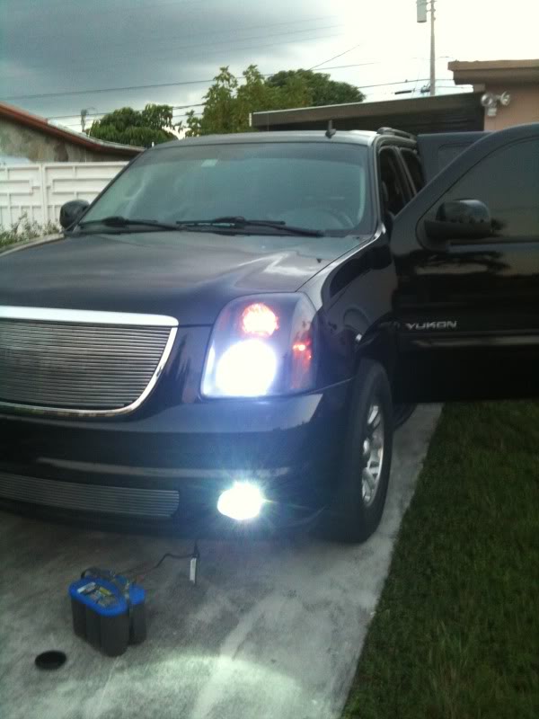

picked up my fog lights today and got the 2 new hid kits a couple days ago.. should have everything on by the weekend.

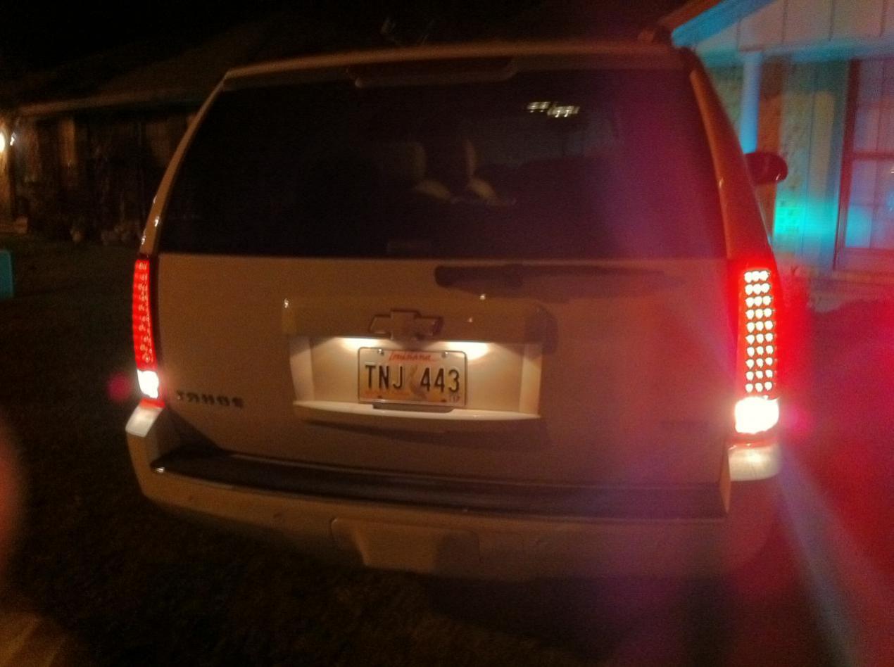

KMeloney you are right-- they didn't change them you just have to pry off the other ones. I installed them the other day and it actually messed up my blinking speed when i INSTALLED the 6 ohm resistors. I took the 6 ohm resistors off I got from vled's website and put on the 10 ohm one (Black box) that came with it, and it worked great plug-n-play!

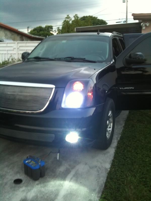

installed the foglights today. A LOT easier than I thought it was. I'm stuck on something though. when you have to lift up and remove that fuse board, to plug in the cable for the harness, I can't take the fuse board completely off to see where I have to plug the wire into.. these is turning them on with that optima, and the low beams are the old ones, new ones on the weekend.

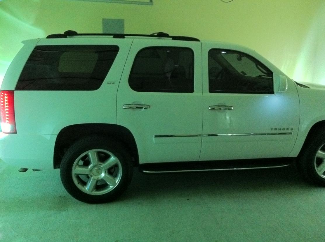

funny that you ask... i installed one first, and afterwards i turned my car on and put the blinker on... no difference in blink speed... i know this sounds stupid but.. "if it ain't broke don't fix it"... instead i decided to install the 6ohm resistors since everyone was saying that the computer would throw an error and cause it to blink faster then normal.
As soon as i installed the 6 ohm resistor, i turned the car back on and it blinked correctly for 2-3 seconds before going into "hyper mode" and blinking freakishly fast. As soon as i spliced the ORIGINAL black box 10 ohm resistors, the blinking stopped. On the 2nd tail light I left the stock 10 ohm resistor. What's weird but makes sense is that I left one 6 ohm and one 10 ohm and tested it and they BOTH started blinking hyper mode.
When I put both 10 ohm resistors back on they were good to go.. weird. So I have the 6 ohm resistors from vled 's website JUST incase it ever starts happenning but it's been a few days since i've had them in and the everything has been blinking in-sync. here is a before and after pic of my new G4 LED tail's w/ HID 8k reverse lights.. thanks to everyone on the forum for all the info btw, i wouldn't have EITHER of these installs without reading all of this great info!!
