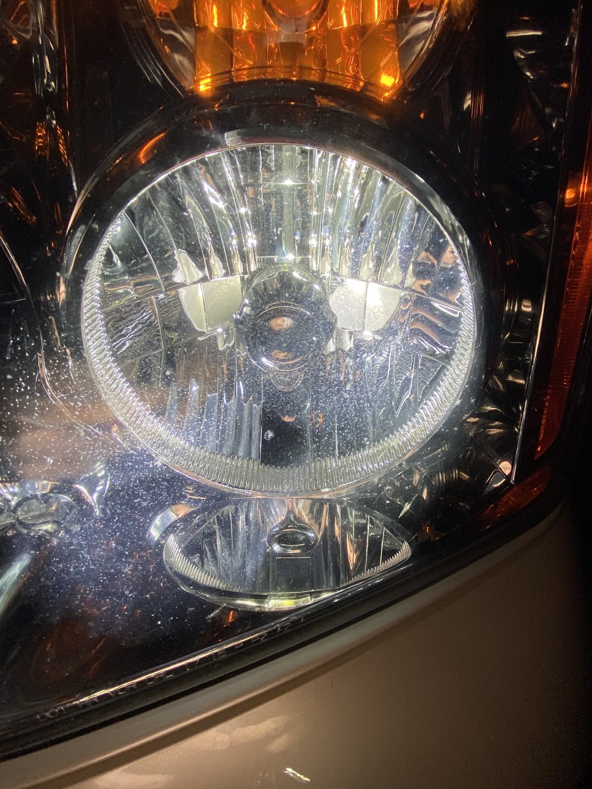

I ordered some Sealight LED bulbs off Amazon to replace the stock ones (H13). Installation wasn’t too bad. I found some videos on YouTube on how to go from the engine bay instead of taking off the grille, unbolting the headlight housing etc. They look great but one shines low (normal I guess for low beams) and the other high. But when I switch to high beams, the orientation reverses and again one high and one low. After looking at the reflector I’m thinking one side of the LEDs should face straight up and the other set down. So essentially oriented up and down. As it sits the LEDs are at an angle so depending on what setting it either shines out and up or down and in. If you look closely at my pic you can see where the bulb rests inside the housing and the LEDs are oriented at an angle. Hard to see. Just curious if anyone has a set that they could look at and see if there’s sit at an angle or up and down. Also after installing these and a set of fog lights my dash is saying to service the stabilitrak and traction control. Anyone know if these are related? I figure tomorrow I’ll put the stock ones back in and see if it’s from the LED bulbs. Thank you for any advice.

The LED chips should be facing left and right, NOT up and down, and certainly not at an angle.

I was able to take them out and they had two set screws along with premarked screw holes that allowed me to rotate the bulb in 1/8 increments. Lined them up side to side and sure enough it works great. Thanks for the advice!
