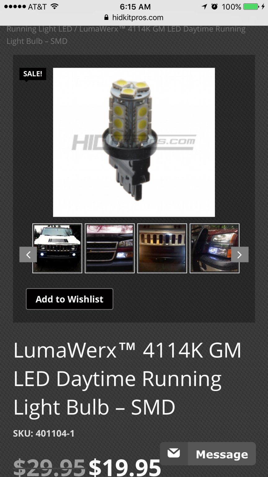

Reverse light and drl are different bulbs. Same base.
Reverse light is 3157
Drl is 4114L will last for a long time

4114 DRL's in the Silverado had them for a year no issues

I use these in my DRLs.
They are only 10w, I've had them in my truck for only 2 months, but so far, I havent had any trouble.

the LED bulb I linked to fits all these base types: 3156 3056 3356 3456 4156 3157 3047 3057 3357 3457 4057 4111 4114 4157.
There is no "4114" LED.
The problem that you have to worry about is the heat that the lamps create.
The 1200 lumen JDM ASTAR isn't well heat sinked, so it tends to kill it self when ran for long periods of time in a small enclosed area like the where the DRLs sit in our trucks (but it does work just fine when used as a reverse light because it runs for such short periods of time, it doesn't have time to heat up much).
The one I linked to in my post claim to run at 10w (that is almost 20w less than the stock DRL bulbs), so they should work just fine in that application.

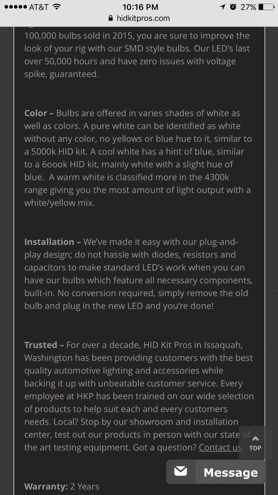

Sweet, thanks guys for all the input on it. I actually found the bulbs you found 05single and was also considering them because they had a good name behind them and were a pretty good price so I'm glad you looked at the reviews W8TVI because I think I would have regretted it lol. 95escahoe are your bulbs white or do they have a blue tint to them? I can't tell for sure from the pics you posted.

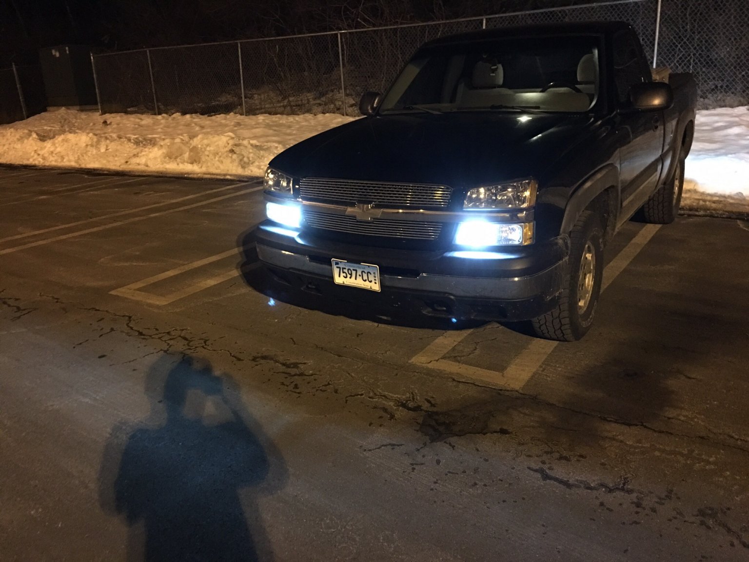

95escahoe
Aug 2, 2010
5,162
4,466
There is a slight blue tint, pure white is the one you want these are cool white I think
