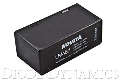

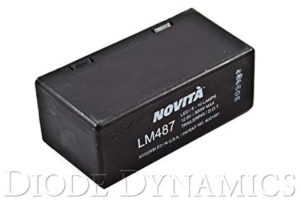

I would wire resistors for only the brake lights so you still have cruise control.
For turn signals I would get the novita led flasher. That way you dont have 2 sets of hot resistors behind your light housing.

Depending on your electrical system, you may need a different relay than this one. I have an ‘05 Tahoe, and mine needed a different LED-compatible relay than earlier models.
If you do a search online, some SSR owners were having the same issue, and they detailed that the LM486 worked for them. This is what I have installed on my truck, and it works for me.
Good to know. I've only used old fashion resistors.

You have a picture to where that installs? I'm running those resistors for my front signals (switchbacks) and wouldn't mind pulling the resistors in place of a relay
05Single
afraid of the dark
Feb 26, 2015
8,244
11,648
Drivers side behind the lower panel by your left knee.

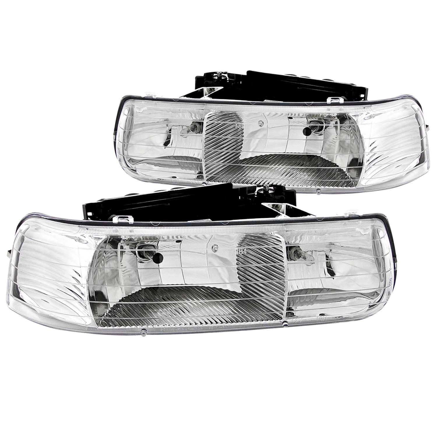

Hid or led in stock housing. Your preference. Stick with 5000k (white) or 6000k (white/blue) color temp.

Thanks, I am behind the times. I didn't think there was an LED headlight out there, and I thought HIDs only work with HID housings. Good to know. I'll definitely look into them.
Well it's usually a no no to put hids in stock housings. But ours have a diffuser lens (older style lights) so it dispurses the light much better than crystal clear lenses (aftermarket or newer vehicle lights) . So hids do fine in our lights.
Stock lights with diffuser lens
Aftermarket with crystal clear lens, try not to put hids or leds in these.
