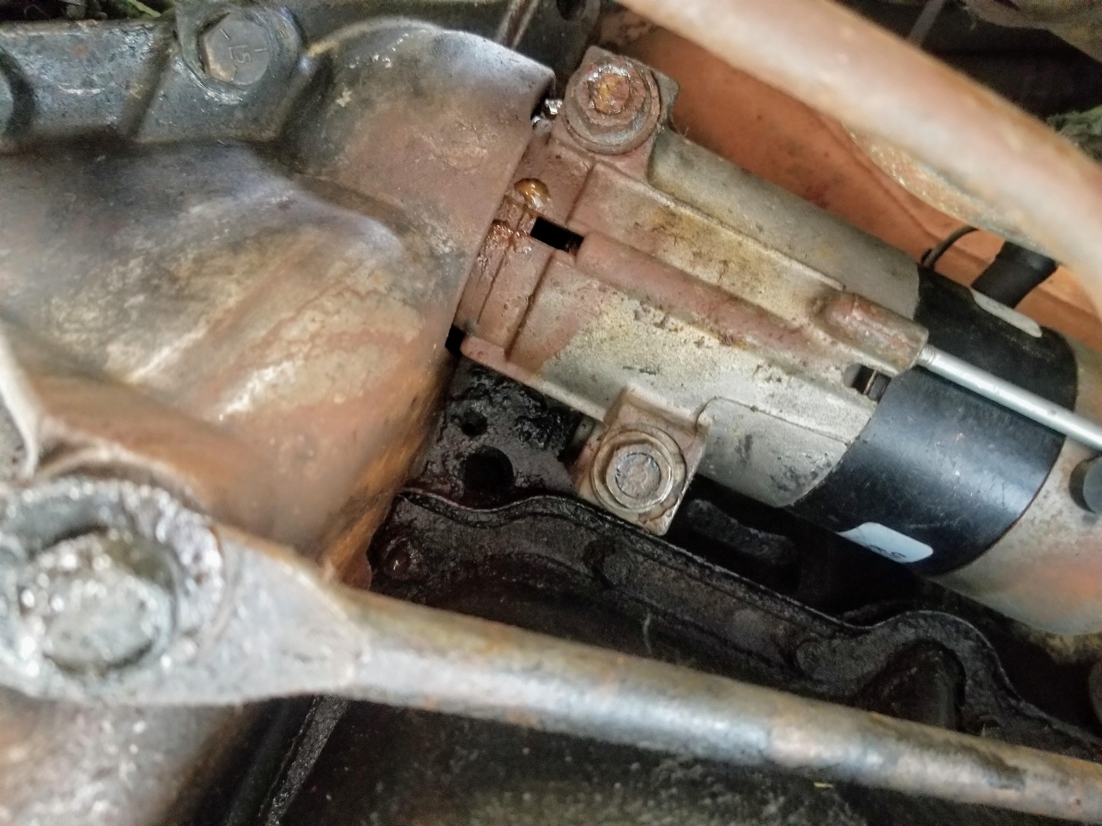

It’s easier to stick to one thread (helps everyone keep track of things), but there isn’t going to be a coolant leak originating at that drip point on the starter. It’s coming from somewhere else - either above or from in front and being blown back by the fan and while driving.
First suggestion is to hose it all off and let it dry. If it’s leaking as bad as you mentioned in your other thread, it should be easy to spot the leak source.

-Knock sensor which is the round plug with an electrical connector just in front of the starter on the bottom side of the block. It looked dry in the photo on your other thread but would be easy to see if it’s leaking. Odds are lower on this.
