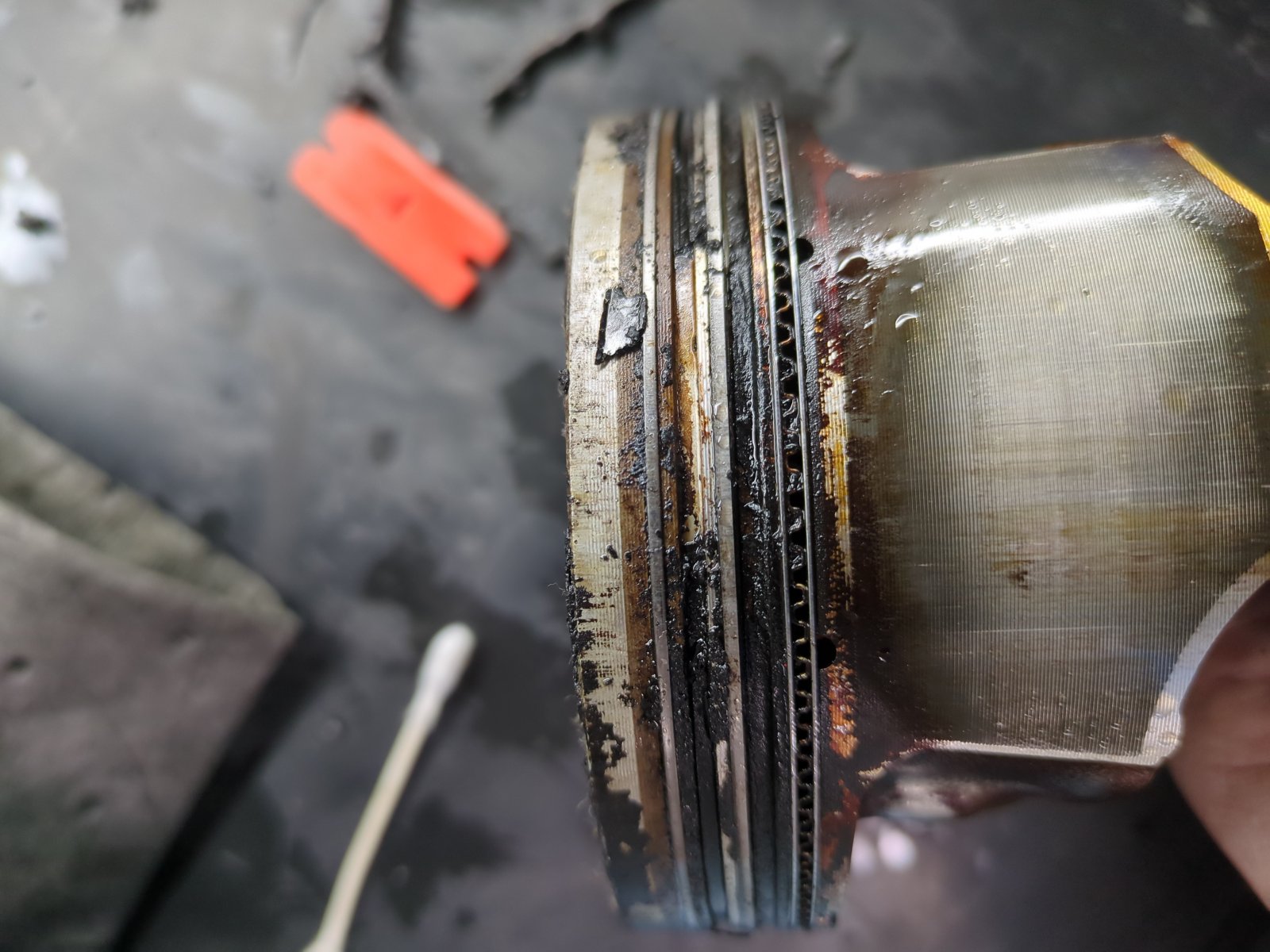

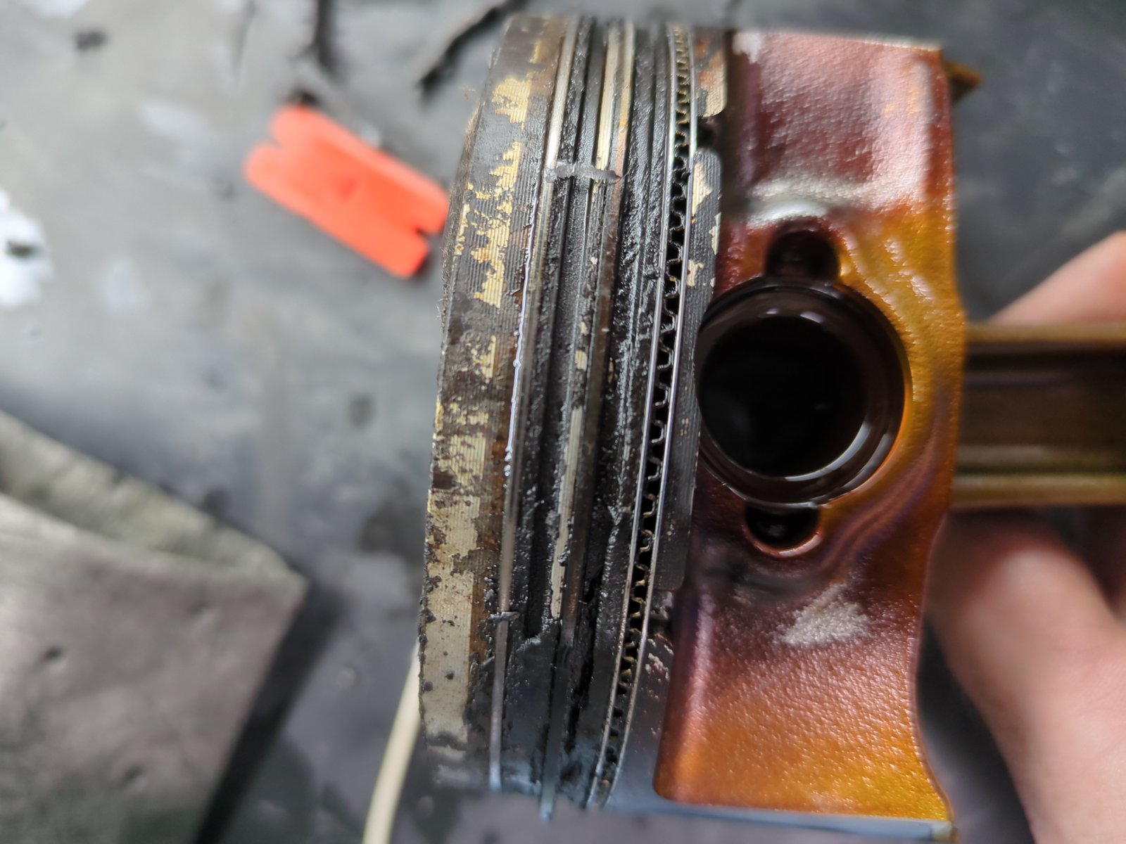

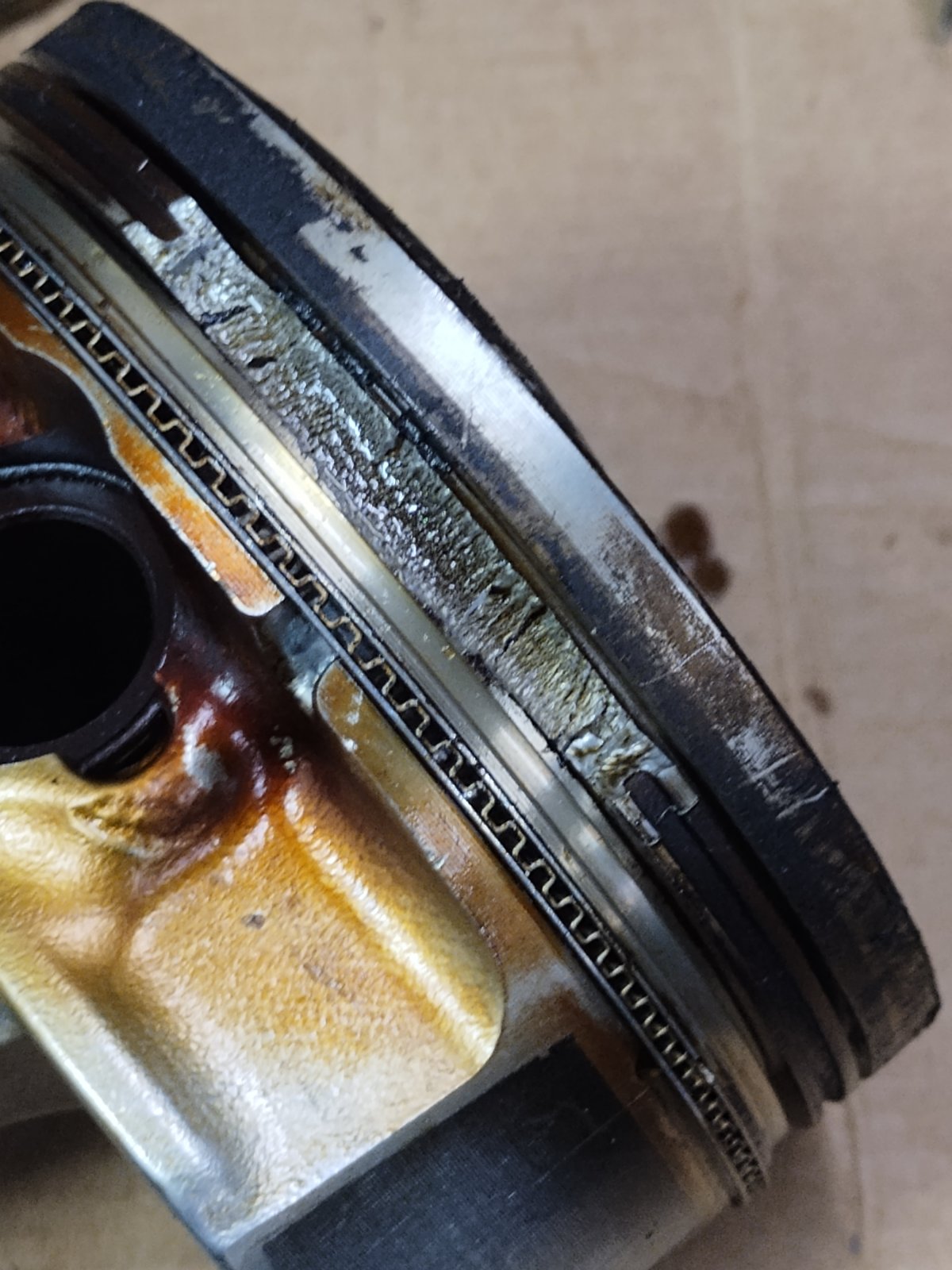

i've removed the piston and found what i more or less expected:
- a lot of carbon buildup on the outside surface of the piston
- top compression ring was so stuck inside its groove that it was hard to find the gap, and it took several minutes to carefully pry it out
- bottom compression ring cracked in 2 as i was removing it

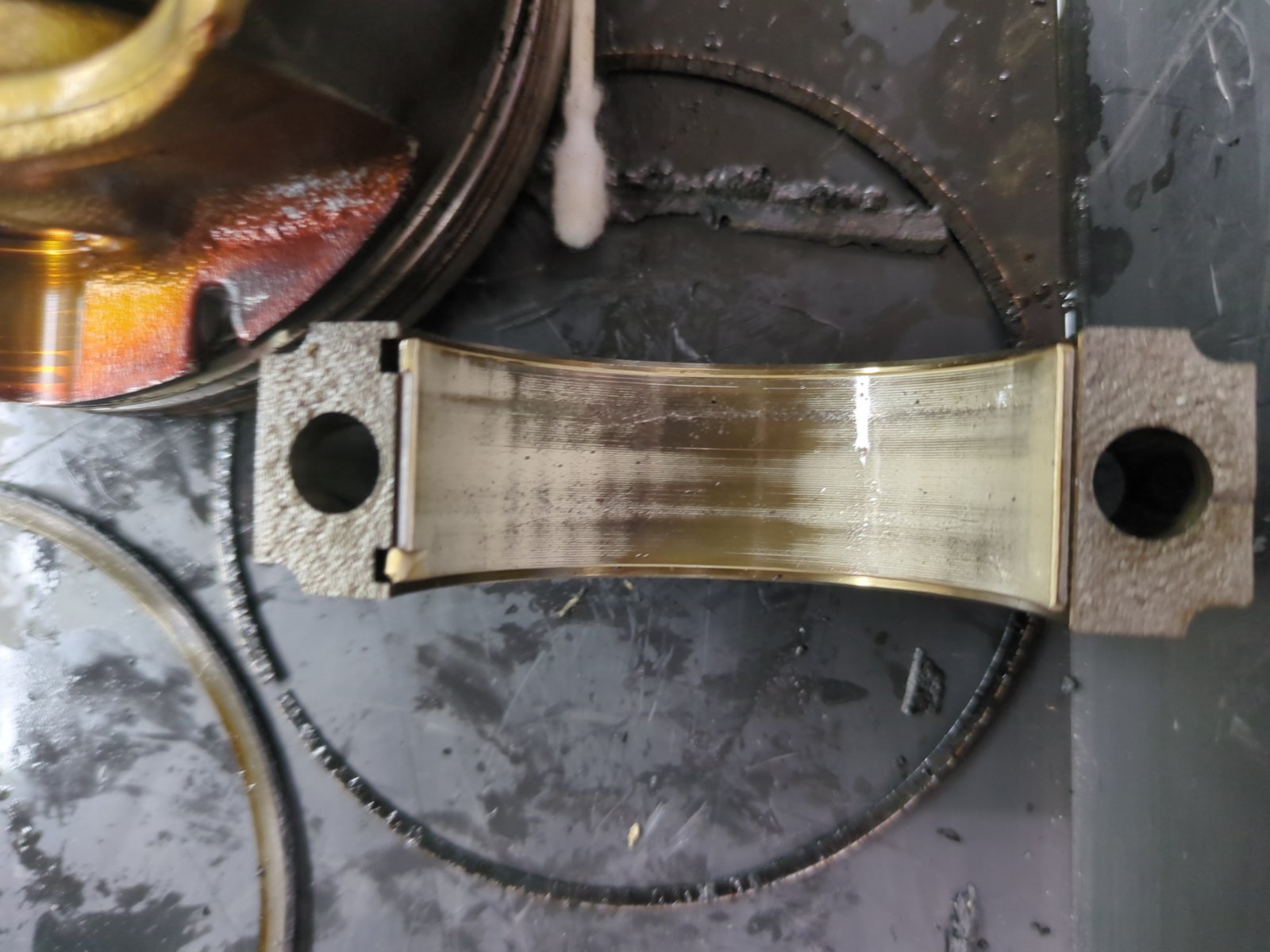

- connecting rod bearings are visibly worn to the point they need replacement, and the bearing surface is notably rough to the touch where worn
- crankshaft surface where connecting rod bearing seats has some mild wear, but nothing in comparison to the rod bearing
i have a set of replacement piston rings here, part 12685185, but i noticed there are only 4 rings in the kit instead the 5 that were on the piston. the 3rd ring from this kit appears to be approximately twice the thickness of bottom rings i removed. the piston ring kit with 5 rings, part 12687779, appears to have a substantial lead time (3+ weeks). any thoughts on using the 4 ring kit instead of the 5 ring one?
i see that the relevant oem connecting rod bearings, part 12735504, are hard to come by (even gmpartsdirect lists them as "backordered"), and i am unsure of aftermarket compatibility. not sure what to do here.

Yikes. It's a safe bet that your other rod bearings are in similar shape. And given the issues cropping up with the stock pistons, I would be inclined to strip the whole engine block and build it back up with aftermarket parts from reliable suppliers. As part of that, I'd have a machine shop look at the crank and clean it up if needed. Call and talk to a pro at either Summit Racing or Brian Tooley Racing and see what they can offer you in terms of aftermarket parts that will fit.
To answer your question directly though, I wouldn't use a 4-ring kit on a 5-ring piston.
Update: Summit lists several aftermarket pistons, rings and rod bearings for the L86.

Tough one. Consider that you have a bad injector on that cylinder, which would explain the rough running, excessive carbon buildup on the ring lands (detonation blowing the oil off the cylinders and overheating the rings, causing oil from below to coke up) and possibly collapsing the piston itself seizing the rings. The bearings may or may not be limited to this cylinder only. As long as it's out, I'd have the injectors tested and cleaned ( injectorrx.com )
after reading your suggestion re full rebuild, i called a friend of mine who was a chinook mechanic in the army for several years to get his take re the connecting rod bearings.
his take is that the bearing wear is not atypical for a car with 90k mi from a visual inspection, and when i demonstrated the limited longitudinal (along crank axis) play in the connecting rod bearings for the installed pistons, he thought there was no need to change out the bearings imminently.
re the 4 vs 5 ring piston ring set, it ends up i was being a doofus and there are indeed 5 rings in the kit. the 2 oil rings that go above and below the spring ring were stuck together and looked like a single ring on initial inspection.
since this is my wife's car, i'm hopeful that it will make it another 50k mi until i'm ready to get her a new car (tahoe), so i don't have to pull the engine out and do a full rebuild.
that is a decent hypothesis.
i've pulled the right side head with the fuel rail and injectors still installed, so i'd have to remove the rail and injectors to test them. i haven't done that previously, and my recollection is that this is typically done with the head installed using a prybar and some puller tool.
i will probably remove the injectors once i get the rest of it back together and see about testing them.

I agree with your friend about the condition of that bearing. It's more wear than I would like to see, but it's not spalling or heavily scored yet, so it's technically serviceable. And if all you're looking for is another 50K, then you'll probably be fine with your plan.
