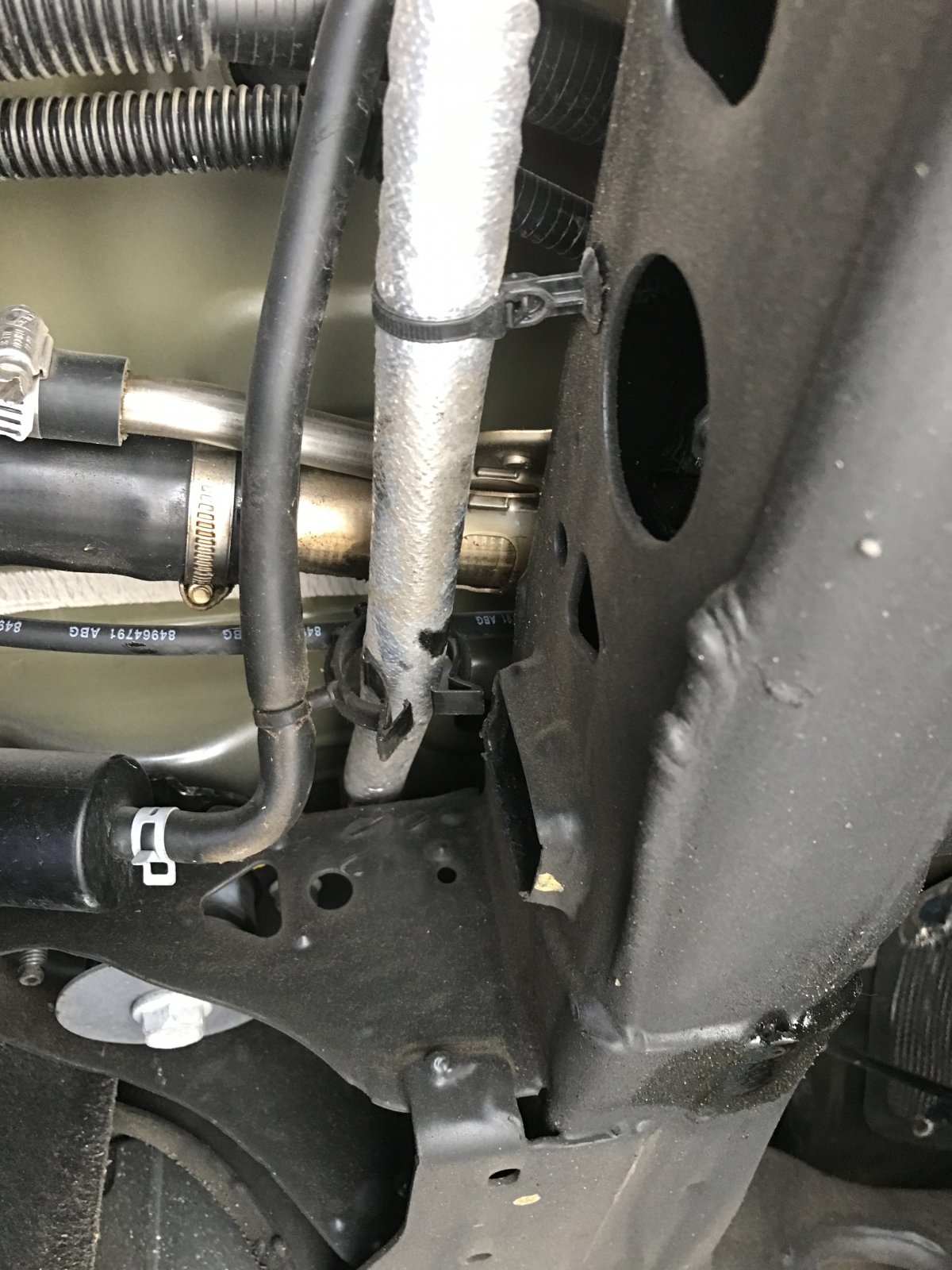

Started to notice a drip on the garage floor that looked like oil. Slipped underneath, and see that it appears to be coming from the large fuel filler line that goes to the tank. The whole line is greasy and slippery from about the time it turned horizontal till it goes to the tank. Finally got bad enough that it dripped down on the frame crossmember and hit the ground. Anybody ever see anything like this?
Obviously a trip to the dealer is in order….
you can see the black spot on the frame.

My guess would be that worm clamp has loosened a bit (classic problem with screw drive clamps). Also, I would shift it to the left by about 1/4". Clamps should be installed just after the bead on the tube. It's a bummer that access to the screw is on the wrong side (mine is the same orientation). I would put a box end wrench on it, loosen, turn 180, shift closer to the bead and retighten.

Fuel neck replaced and all good there. The actual hose itself was split underneath the worm clamp....

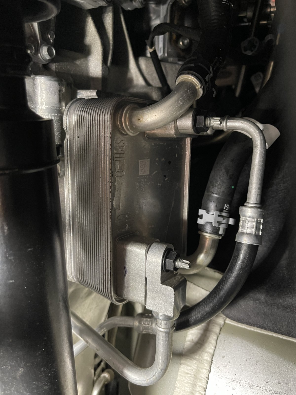

While underneath the tech noticed the transmission cooler leaking and replaced that too. Pt # 24288625... Does engine coolant flow thru this exchanger? If so, that may be the cause of why my coolant was going low....Took over a week, but all good if everything is fixed....

I probably don’t understand how it works, but I only see 2 hose connections… does fluids flow thru the blocks with the studs in them also?

Yep, the studded ports are for tranny fluid (higher pressure hence the bolted connection) and the beaded pipe connections are for engine coolant.
Here’s a picture of it in action. It’s right above the front diff. driveshaft.
This works in conjunction with a cooler mounted in front of the radiator. In between the two coolers is a thermal bypass valve (second picture) I believe it works such that unless additional cooling is needed, tranny fluid does not flow to the cooler mounted on the radiator.
Well sadly, it’s leaking again. Should I…
Take it back?
Try to tighten clamp myself?
Try to put on a new or 2nd clamp?
If I remove this one to replace is there any fear of hose pushing off on its own? Any better clamp to use?
Take it back?
I would just take it back - GM has an issue going on here and needs to see warranty claims coming in for this assembly so they can examine/root cause/fix.

Have you seen this before or heard of this problem? They did replace the hose that goes from the filler to the tank but I don’t think they did a great job with clamps. They look like the cheapest hose clamps you could ever use. I’m about ready to buy some t bolt clamps and fix it myself but when I put my hand up on the steel part of the neck where the filler neck goes in, it’s wet with diesel. It could be wicking up there.
but there is a definite drip line from the very top of the assembly, running down the hose and dripping at the bottom, where it is clamped at the bottom. It could be just as simple as better, or new clamps, or it could be that the upper steel assembly where the fuel and DEF go in could be cracked or bad welds or something. I’m supposed to take it for a parts evaluation tomorrow and then if they need to order some thing I can keep driving it until the parts come in.
The dealership said that parts like this are pretty hard to get and could be weeks…
