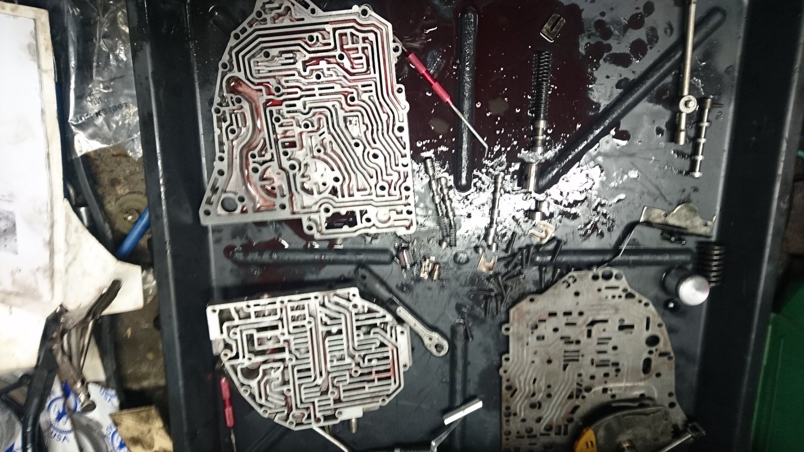

Two forms of deposits can form in a transmission. The first is abrasion of the pressure plates, which are made of steel.
This is very fine metallic abrasion that normally collects on the magnet in the pan.
The second is the friction lining of the friction disks. They have a similar structure to clutch plates in a manual transmission.
This is very fine abrasion that normally remains in suspension and is removed when the oil is changed.
It does happen that there is abrasion from the friction discs or mud in some corners. especially if you don't change the oil for a long time.
But these are usually very small amounts compared to an engine, for example.
In the attached picture for example you see a vent body of a Chrysler lebaron transmission. If you look very closely you see the small amount of deposit as dark shadows.
But thats it. From a flush, there can not be loosen deposit which damage your unit.
And again: The purpose of a flush is not to get dirt or mud out of the gearbox, but to get the oil out of all channels, oil pump, pistons, torque converter, oil cooler and so on.

The way I see it is this: the friction material is normally BONDED to backing plate and that's how it allows rotational force transmission with the aid of the clamping pressure. The "bonded" is what people forget here.
Once the material is knocked loose and is suspended in the fluid, it may as well just be a ball bearing. At least that's what picture in my mind are the mechanics of this. I don't see this "grit" being able to transmit any of rotational force anymore. There isn't even that much friction material in a single clutch once it's suspended like 12 quarts of fluid or whatever. Unless you have several clutch assemblies failing, then you have much larger issues.
Bearings, bushings, and races and other precisely machined surfaces are pretty much destroyed if enough clutch material circulates through them, as is the case of the TCC failure of the GM 6L family of transmissions.
I would simply say it's a coincidence that a transmission fails shortly after a fluid change, and those people believe in the old-wives tale to be true, which in their eyes, the fluid change is perceived as the event that caused the tranny to fail.

Thank you for the explanation. Essentially, a flush is good for your transmission, unless it is already on the way out: i.e. If you have larger than expected particles in there already.
