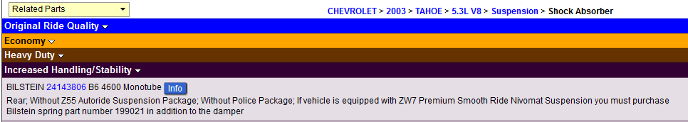

To explain a little more, the G65 RPO code designates Nivomat technology shocks on the rear, and those are manual self-leveling. They are beefy shocks that adjust to the load as you drive. They are paired with softer springs, hence the Premium Smooth Ride (PSR) designation. If you replace them with standard shocks you'll need to replace the springs with either Z71 (non PSR) springs or what Bilstein indicates (199021), and those stiffer springs would work with standard shocks. But you lose the self-adjusting feature of the Nivomats. (I'm not sure if there is a third style of spring for this model year.) Not changing the springs when converting to standard shocks will cause dangerous sway under normal driving conditions.

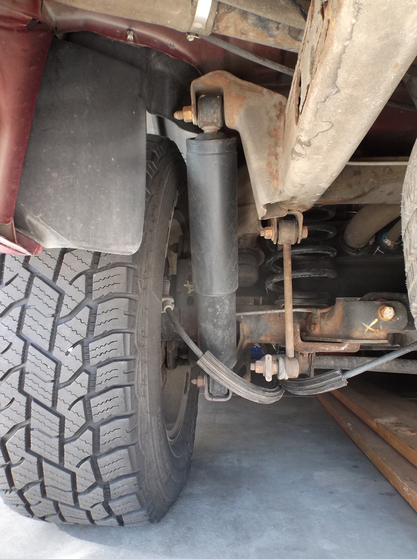

Pic of Nivomat shock:

I replaced my Nivomat shocks so many years ago I can’t remember. My issue was due to the driver side shock leaking. When I was told the cost of replacements I literally chocked. It was this forum that I learned about the need to change the springs if I did not go with the Nivomat. I went the Bilstein route usising the springs recommended by Bilstein (199021) and this forum. Like I said couldn’t be happier and we tow a camper all he time.

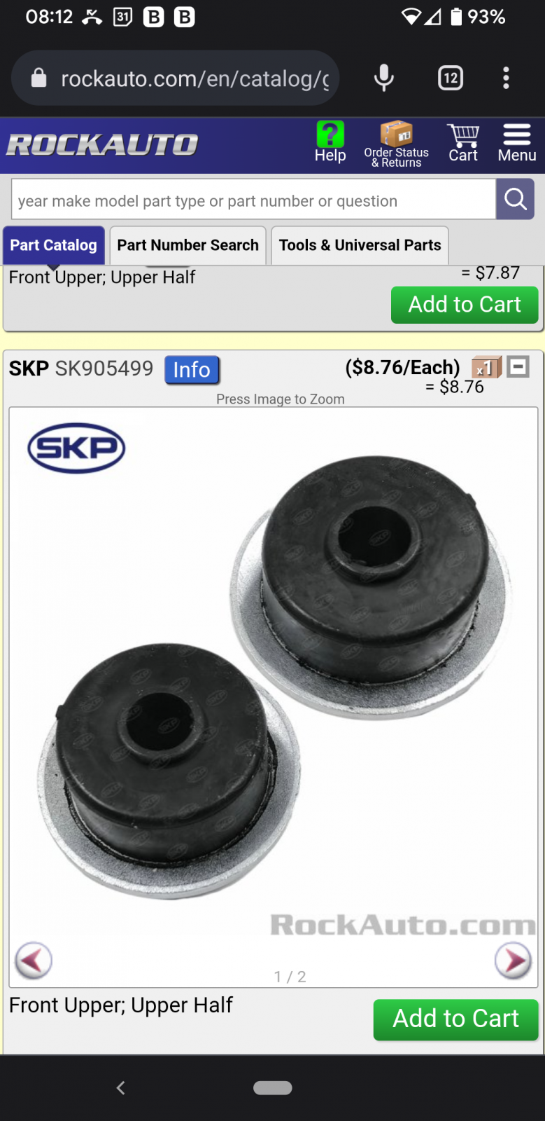

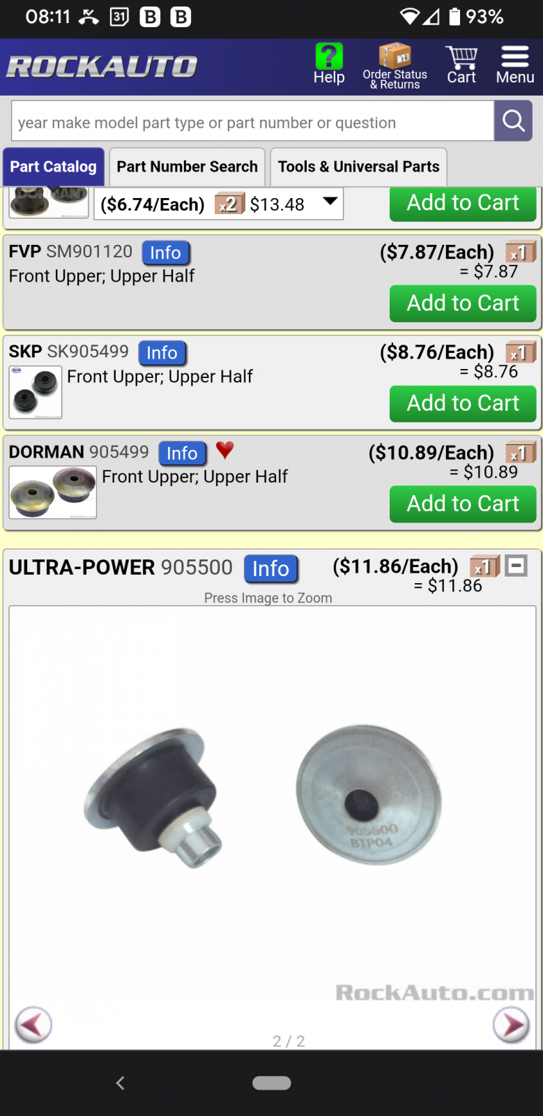

Fless, I ordered the kyb kg5040 for my fronts as well, having my an oem pair up front now. When I took off the oem, it has some plastic collar for the top mount, and the oem bushings have a larger hole to accommodate that collar. The kyb bushings don’t have that. Kyb bushings have this little extra lip that I guess is suppose to fit in the upper shock mount hole in the frame? That lip was too wide diameter to fit in the hole, I wasn’t sure how that setup was going to keep the upper shock in position. Hope that made sense. 2002 Yukon with zw7/g65. I couldn’t find a front oem replacement on rock auto or Amazon. the rears replaced with nivomats again already. Any advice appreciated, hopefully this helps the OP too, but maybe everyone is just smarter than me.

Hopefully you can see the screenshots. I took these off rockauto and these upper insulators are what the oem setup has. There's a rigid collar that sits in the bushing. The kybs don't use anything like that collar. The stem of the shock sits inside the collar.

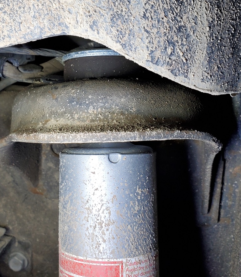

I'm not sure if this answers your question, but here are two pics from the KYB instructions. The bushings they provide don't have a metal sleeve which is not uncommon.
When you assemble the bushings on the shock, put the metal cup (necessary to support the bushing) on first, then a bushing with the flat side to the metal cup (might have to kind of screw it on since it will probably be tight). Then stick the threaded shock shaft through the mount. Put the top bushing on the shaft, then the metal cup.
Here's mine so you can see the top bushing and cup. The bushing under the mount is hidden, of course, by the shape of the mount.

The metal/plastic oem collar won't fit the new kyb bushings, as the latter's hole will just fit the shock stem, not the collar. The OEM setup is such that the stem sits inside that collar, and the collar sits inside the bushing, as well as the mounting hole. Sorry, wish I am able to show pictures better. I'm just not understanding how the new bushings center the stem. In one of the pics you supplied, it shows the bushing sitting in the mount hole, with a part of that bushing just fitting into the frame hole. The bushing i got has an extension for that purpose, but it's just a little too wide to fit into that mounting hole. I hope that made sense.

The protrusion on the bushings mates with the hole in the mount and centers (and buffers) the shock mounting stem so it's not hitting the sides of the metal hole. Once the stem is tightened down the bushing should be fully contacting the mount surface, with the protrusions fully inside the mount hole.

I understand now...that's what I was thinking...I guess those protrusions squish in the hole once I tighten down. I was thinking they should at least fit in the hole without tightening first, and was actually contemplating dremeling down the radius a little to fit. Well gents, another closed case, no thanks to me being just an idjut.
