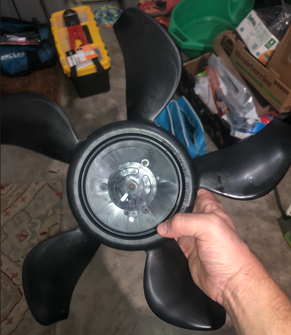

Is that fan a 5 blade, with the connecting ring or without?

5 blades, no connecting ring. The fans in my 2007 have the connecting ring so somewhere between 2007 and 2012, they changed the design. Here's a pic of the K5L fan I installed.

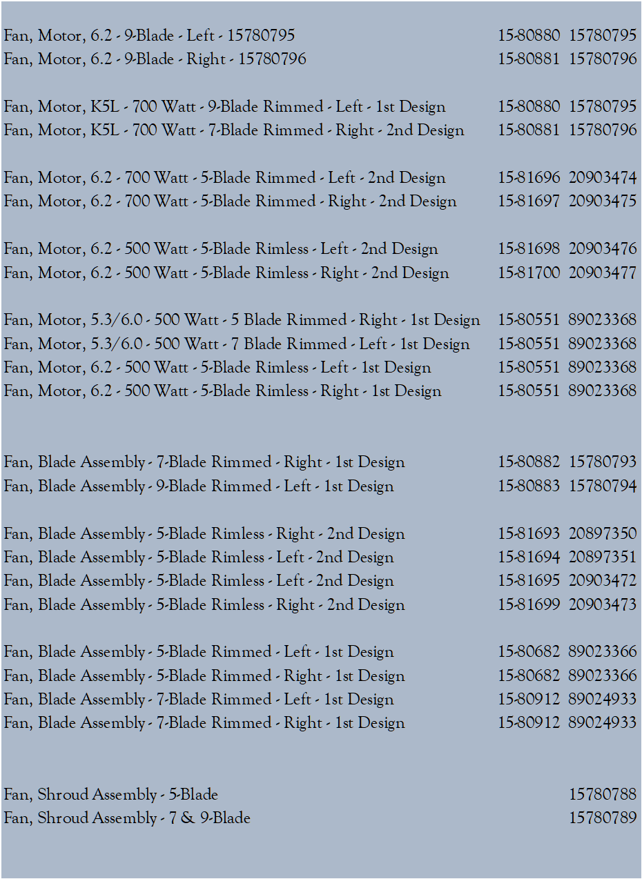

Well I just bought a motor and fan as well. Found it a little cheaper on ebay buying from World Parts Direct. Any visual difference between the 700w vs the 500w motor?

This has been a work in progress and am trying to complete the associations, which motors go to which blades, etc. Doing this for both the wagons and the pickups.

Both my fans are rimless 5 blades, but I apparently have the 500w motors (non-K5L rpo). I'm interested in changing one to a 700w motor like @Geotrash did and wondering if my existing 5 blade fan can be used on the 700w motor?

My understanding is no because the fan for the 500w motor is a different part number. It’s also why I replaced the fan when I bought the 700w motor.

Don't know if the motors and fans are swappable. I reckon that GM made these different configurations for each other so as not to burn up the motors or draw too many amps.
My Yukon and Sierra run different part numbers for their radiators but from the descriptions at ACDelco they appear to use the same core. Both have engine oil coolers plumbed into the driver's side tank.
There are left and right motors and most of the fans are left or right as well.
Would like to pair the fans up with the blades and shrouds and then see if there are different relays and such.
