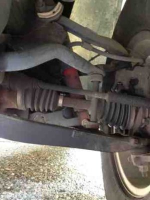

Got em cranked. Only achieved an inch. I'm still 38" in the rear and 36.25 in both front wells.
Here where my cv's are. I think.

Don't see why you couldn't. I think the extenders are a cheaper option.

Dont crank more than 2inches bad idea and will wrar everthing badly. And yea you can get longer shocks but id just *** extenders. They do the job for alot less
