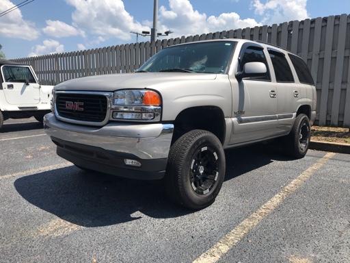

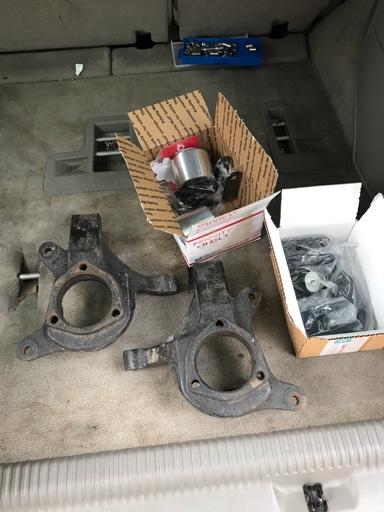

3” Keys , 3” inch lift spindles, 3 inch coil spacers I don’t plan on turning my keys all the way just wanted some Wiggle room, keys and coils came with shock extenders.
My boy Bear ready for me to put the lift on my truck, anything I should know or be prepared for before I get started,

You got 3 inch spindles. Are those the lift spindles for 2wd or are the just the 3 inch spindles for correcting geometry that doesn't actually do any sort of lifting?
Curious because I have the corrected geometry spindles sitting in the corner of my garage because I have no use for them... Yet.
These are the 3 inch lift spindles

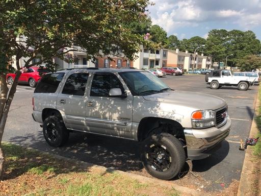

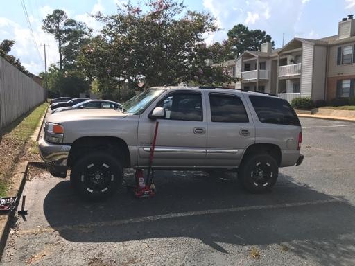

Does it sit higher in the front? or is that just the angle of the pic?
And that’s with the stock keys turned, idk how much PO turned them, but I’m going to replace with after market keys and shock extenders
