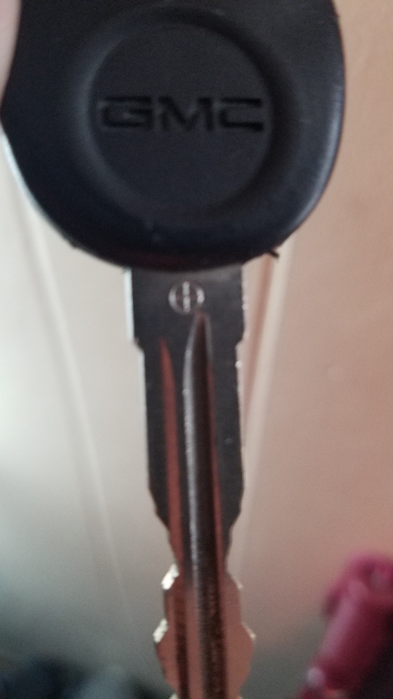

Is the key you're using chipped? Does it have a circled + near the base like in the pic?
Sent from my SM-G930V using Tapatalk
Thinking the same. OP may have gotten a spare key made at a Home Depot, but they need to be copied with a special chip key.

Actually, I just tried mine and it started honking the horn after opening the door until I inserted the key into the ignition or hit the unlock button on the key fob. Now when opening the locked door with the key it doesn't honk the horn. Maybe it just needs to be "recognized" once, like when programming a new chipped key.
