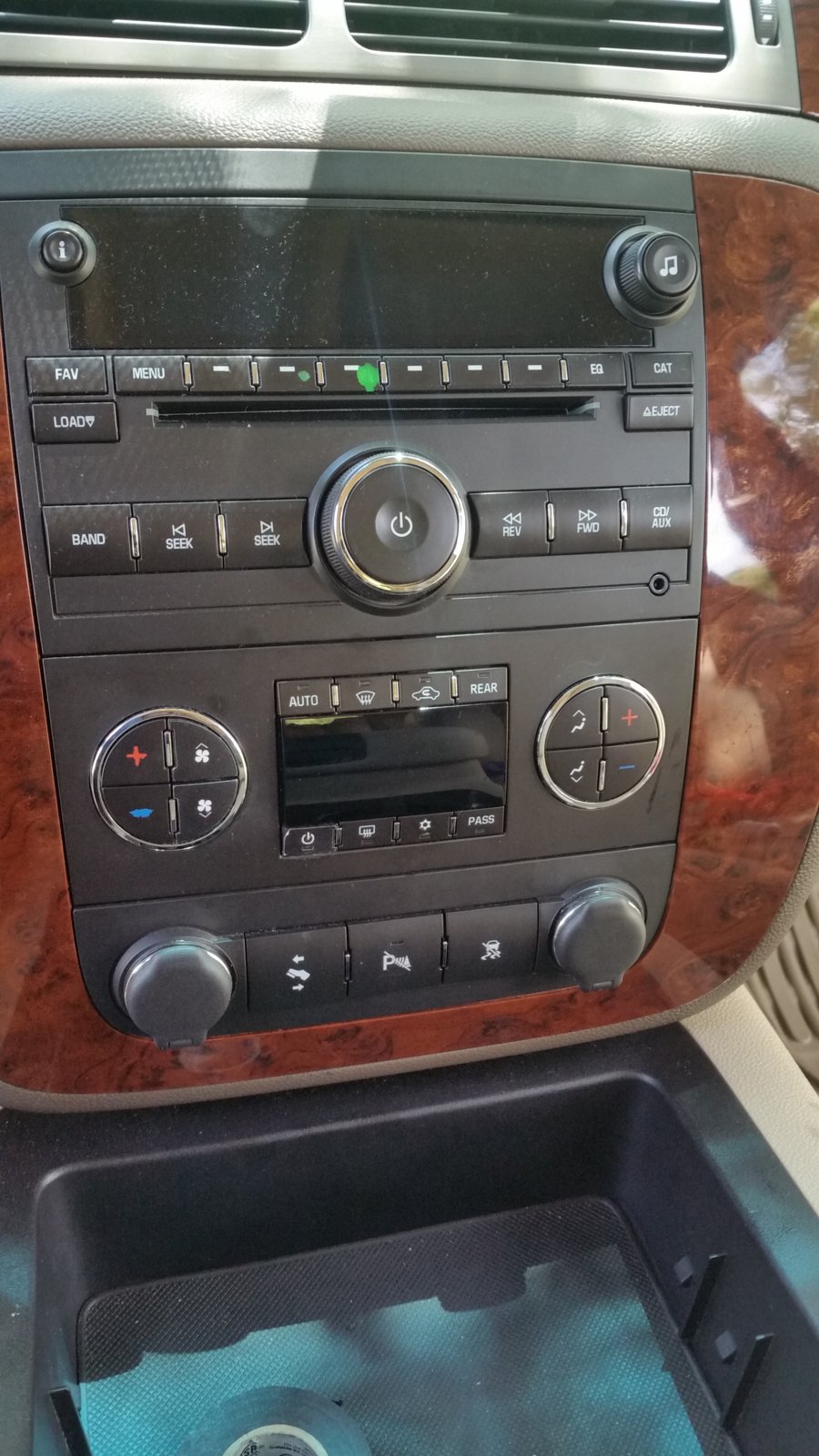

Saturday I found a shade tree out back and I set out to replace the cigarette lighter bezels and do the USB charger mod. While I was at it, I decided to do some more searching for my radio/speaker issue.

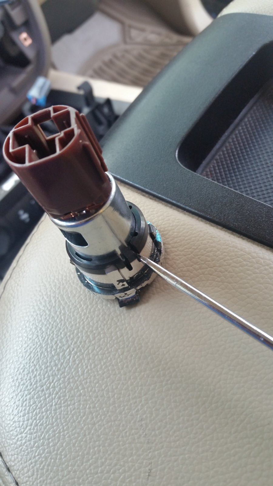

I pulled the trim off around the radio and removed the panel holding the two sockets. I believe the screws are 7mm. You will notice that the panels are stacked to where you have to remove the bottom first and work up.

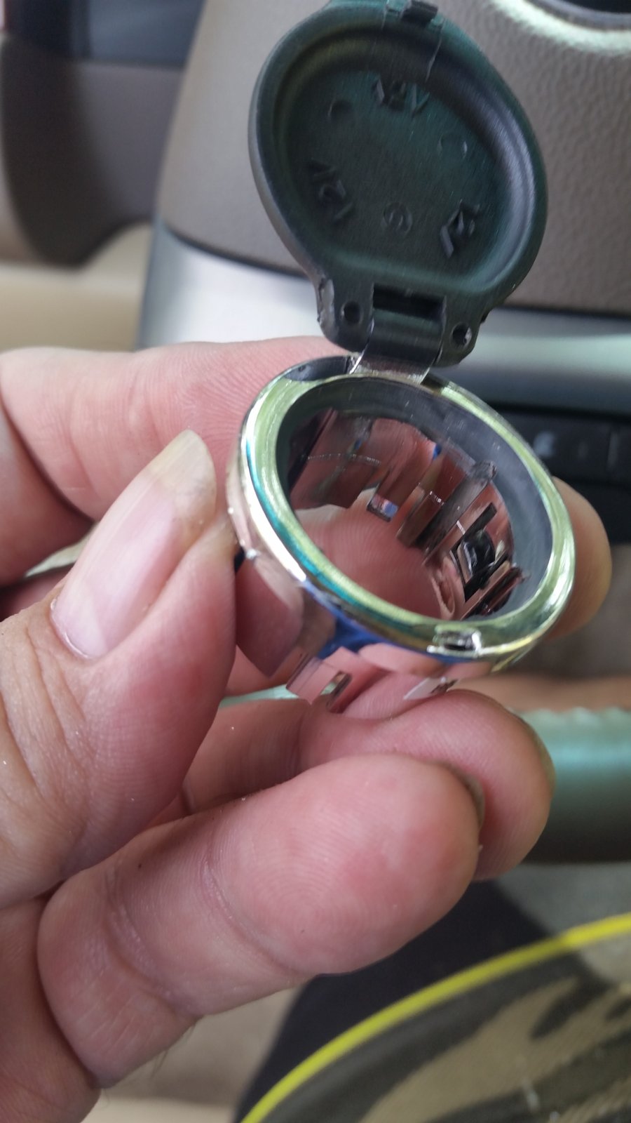

In order to remove the sockets from the bezels you have to release the tabs holding it into the bezels using a screw driver. I show it out already for clarity. Once it is out, the bezel pops right out.

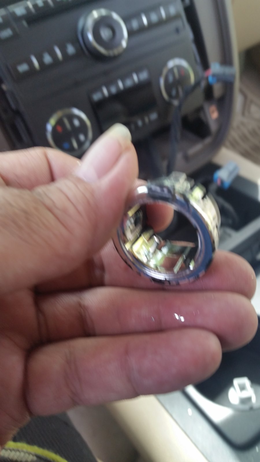

Now if you are going to install the USB, take note here. You need to get the bezel that is made for the USB adapter as I had to modify mine to make it lock into the bezel. The one for the cigarette lighter is not the same part. I took my dremel and countersunk the I.D. so that the USB would sit flush and the lid would close.
The bezels will only fit in one way due to the tab having to fit into the slot. Just pop the bezel in and then the socket or USB will follow. Notice that I had to modify my USB adapter so that the tabs would have a spot to catch and then I staked it so that it would stay put.
The cigarette lighter socket will only fit one way also. Notice the alignment slots and tabs.

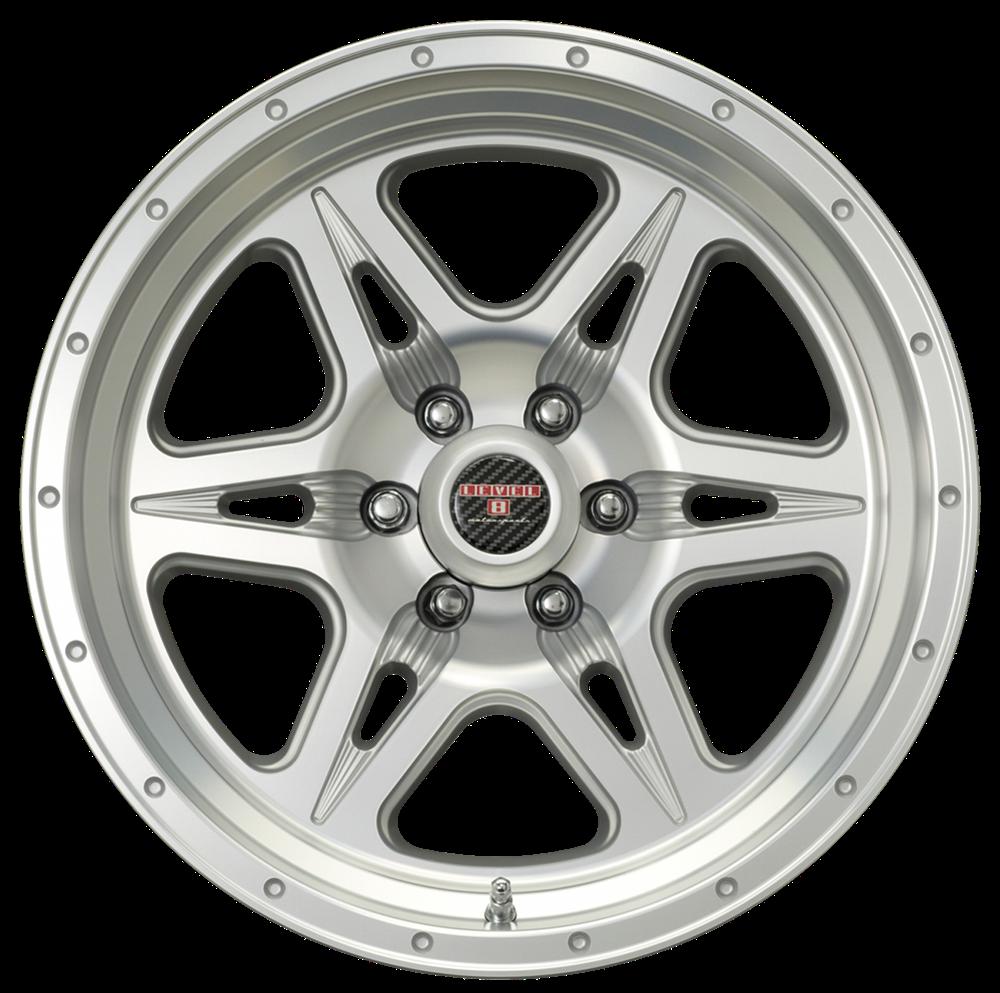

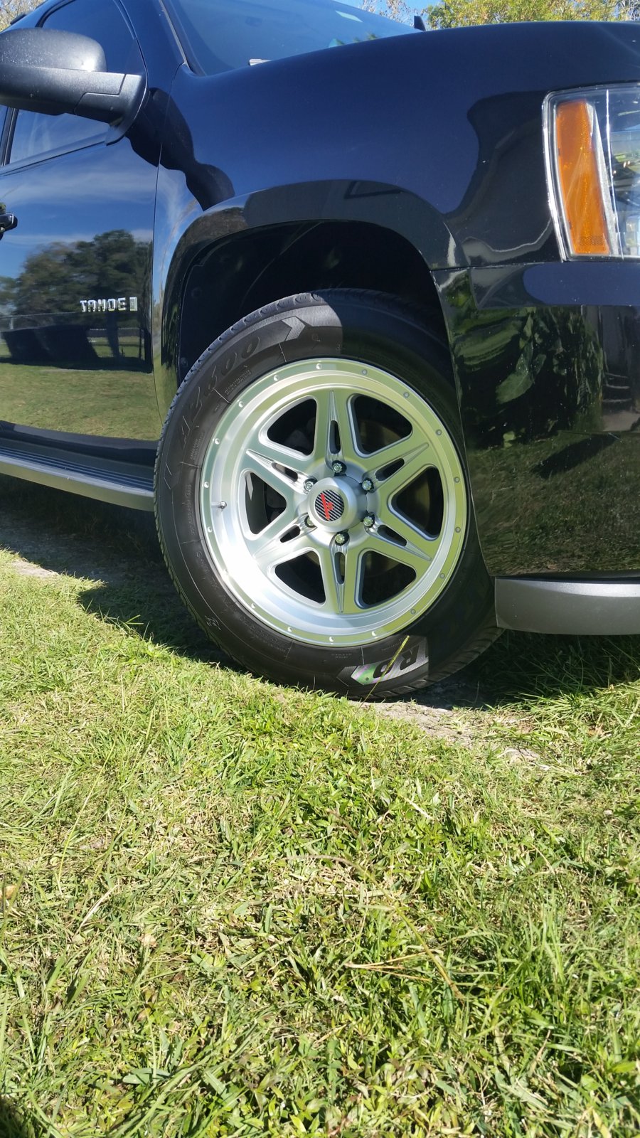

Just placed an order for new wheels. My factory wheels somehow ended up bent. Lugs, hub centric rings, center caps, and lifetime balance/rotation included in package. Lttle over $900 OTD. Should be in within a week. Probably after Thanksgiving. I went with these instead of OEM replicas because these look a little beefier and have a 0 offset. I'll put pics of the real thing but here is the wheel and a photoshopped pic.
View attachment 186981 View attachment 186982
Bad. Ass.
52,954
Looking forward to the real picture.
45,014
Tough-looking wheels. They look much better in that size than how they appeared in the Photoshopped pic.
