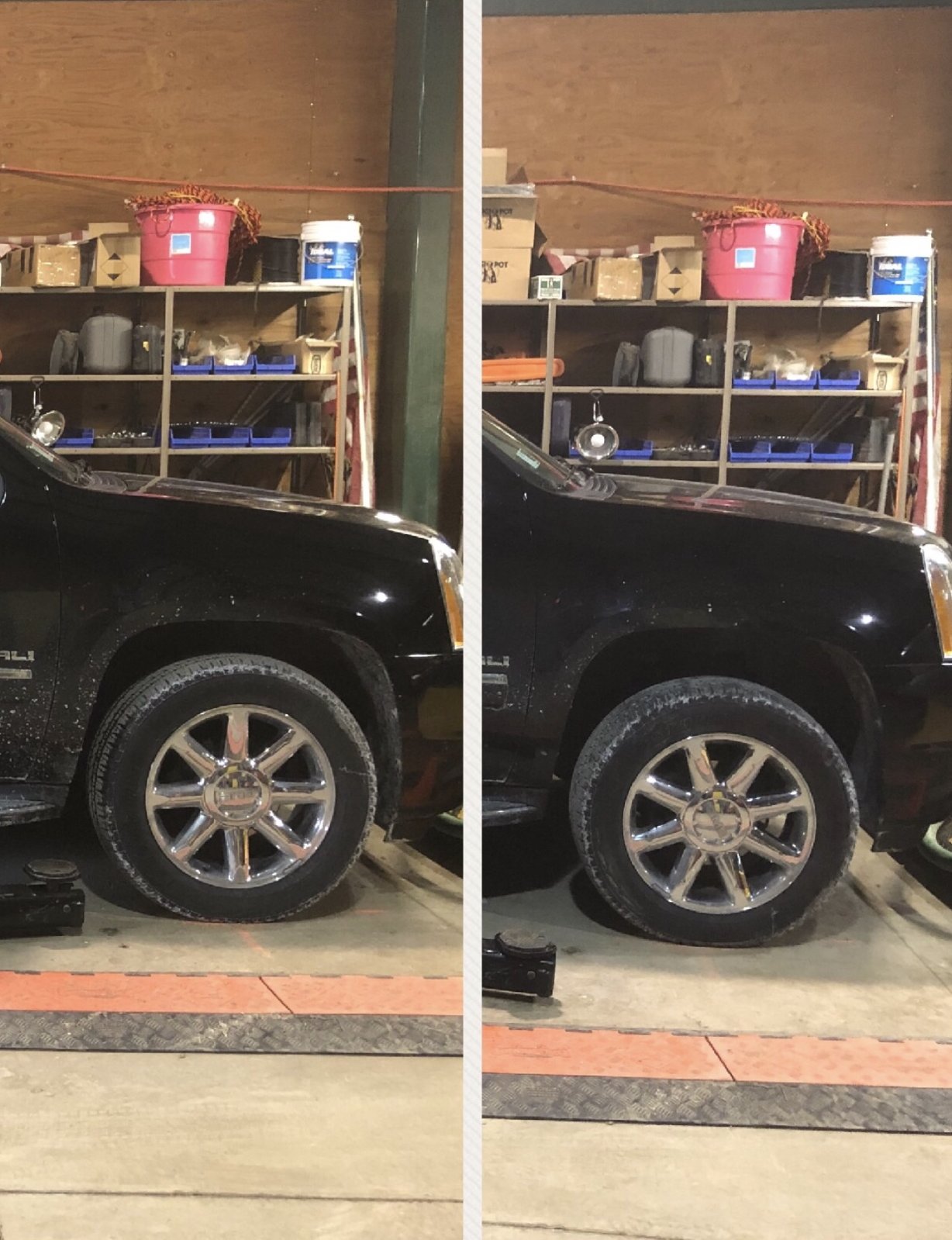

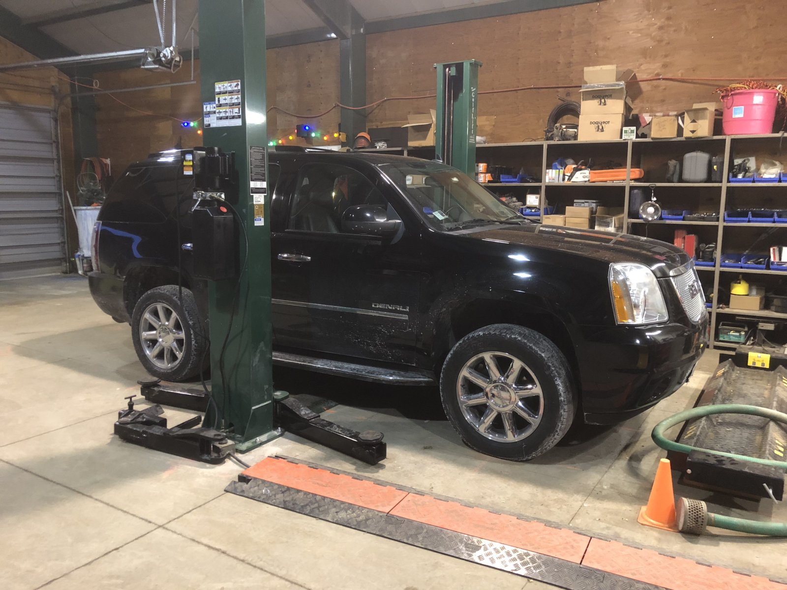

Well I have gone and done it now. Decided I no longer liked the rake of my 2010 Denali so I got a 2” leveling kit in the front. Just at the alignment shop now having it setup so I don’t destroy my tires. Here’s the before. Next post will be the after.
