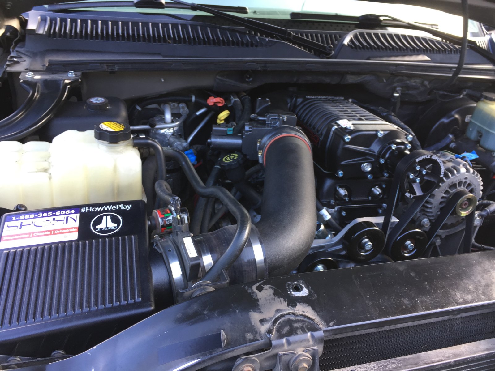

For any of you with naturally-aspirated engines that think you need more airflow than what the stock airbox or throttle body affords, or that it will net you any HP gains, I'd like to point out that Whipple utilizes the stock airbox and TB along with a high flow air filter and clean-flowing tube between the box and TB for their supercharger applications. If it's good enough for 600 HP or more, I guarantee it flows more than enough for 300-350. I'd love to see the dyno proof @justinesky that you see any increase in power. There are also dyno results here on the forum showing that the best CAI's result in, at the most, 2 HP gains. That's not a "noticeable increase in power" in my book. Here's mine. BTW I also have headers and a cam and it still flows good enough.
Yes. The stock 12"x12"-ish filter is NOT a hindrance of volume to the ~3.5" mouth of the throttle body on a stock motor and, apparently, not on a supercharged one as well.
52,949
Because they're selling you stuff.
X2. I had one and it didn't do anything but make the intake sound better, and when I installed my supercharger Whipple wanted the stock airbox (unmodified) with a high-flow filter and their tube. That tells me something.

I don't know about all that. Like homeboy said, his supercharger utilizes the factory inlet duct, per their specs. If there is a better place to draw fresh air, their research would have provided this, I'm certain. Mr Whipple has no shortage of R&D.
