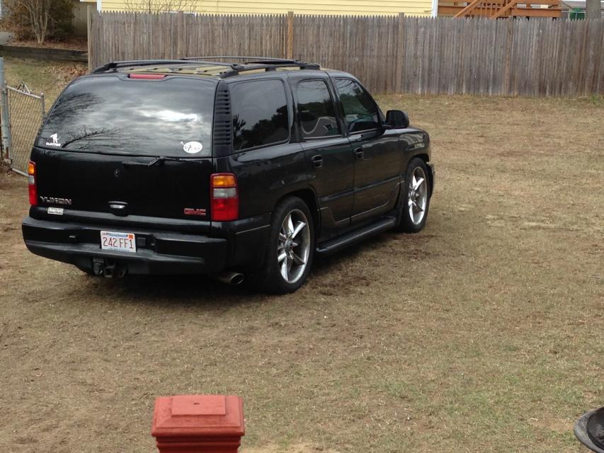

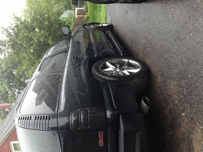

Want to close the wheel well gaps. This is my setup as of now.
Front
2 inch bell tech spindles
2 inch lower keys
Short bell tech sp shock
Bell tech front camber kit.
Stock bumps stop not modified
32 ground to fender lip keys are cranked up somewhat.
Rear
Tony's custom 6 inch springs
Djm hardware kit
Spohn panhard bar
Helper bags
Free travel mod
Short Bell tech sp shock
Isolators still in
32.5 ground to fender lip 5 psi in bags at the moment.
So I want to get down to to 30 or 31 with out changing tire size. Was wondering if 2500 keys and modify bump stops would be better then 2 inch keys with modify bump stops. Pretty sure not much I can do on the rear but I do have 3 inch djm springs which I'm thinking I can cut to get where I want to. There's a ton of good advice on here and tony already hooked me up with great parts. Do just looking for some advice thanks guys.
